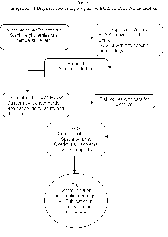

Integrated Models
Currently the California Air Resources Board is developing an integrated program Hot Spot Analysis and Reporting Program (HARP) that will integrate the modeling program (ISCST), the health risk assessment program (HRA) and GIS. A number of consulting companies4 have developed modeling programs which have integrated GIS with the output of dispersion modeling.

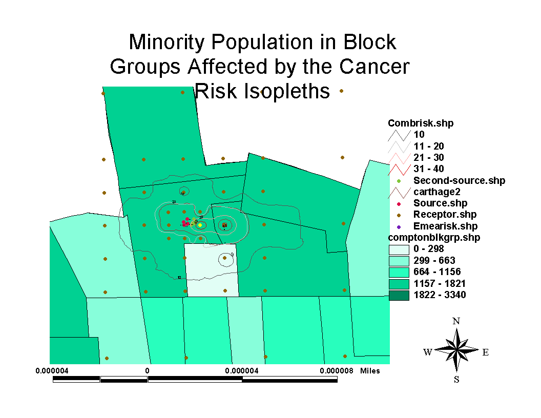

Methodology

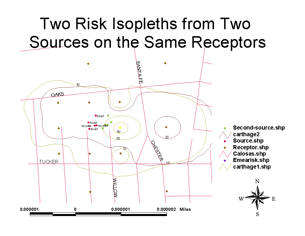

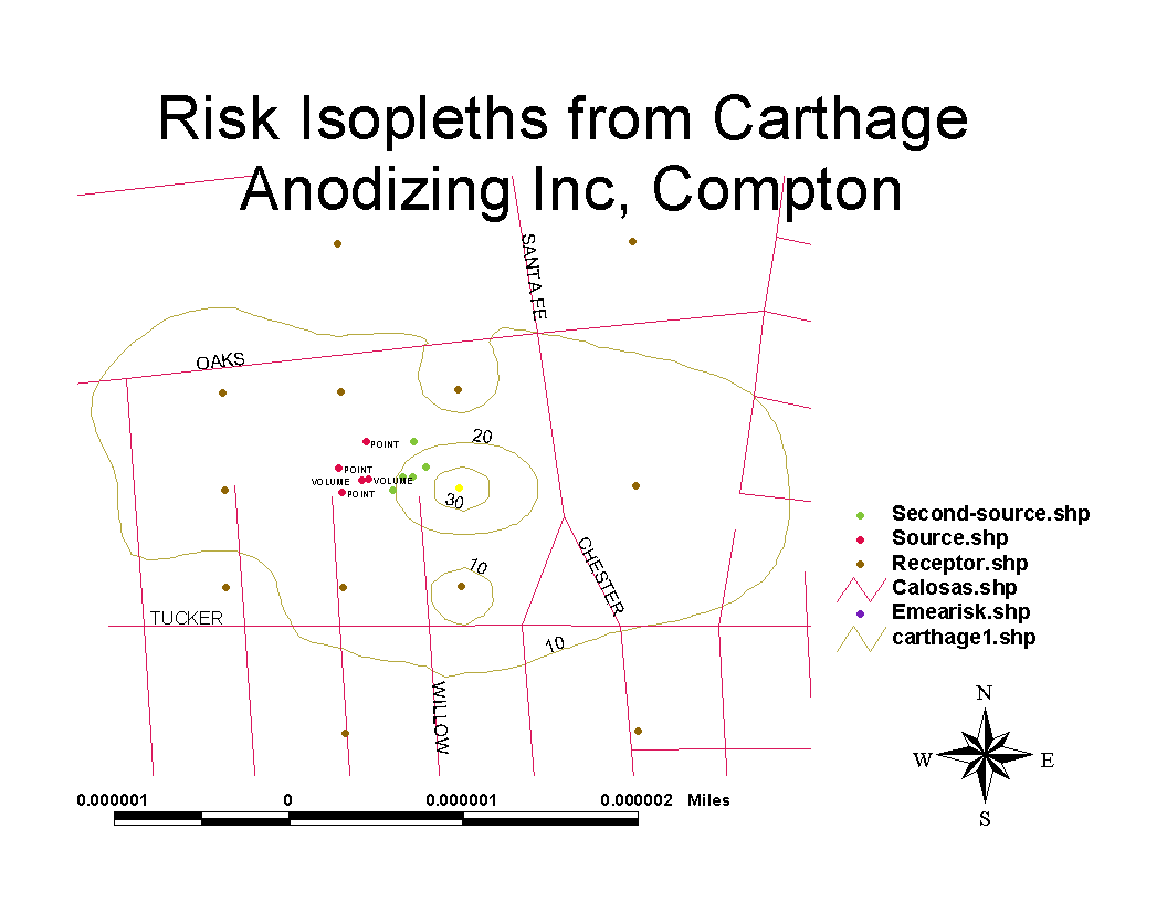

The following steps were taken to create the risk isopleths to show cumulative impacts.
Step 1
Prepare and Run Dispersion modeling- ISCST3
To show the cumulative effects of two nearby sources on the same receptor locations, two modeling runs and health risk assessment were conducted. The input data for the sources were assumed to be identical, with the same source parameters and emission rates, except for their location. The model runs were based on five sources: 3 points and 2 volume sources, 5 pollutants, 112 receptors, and meteorological data for the City of Compton, California, for 365 days. The concentrations for 1-hour maximum and the annual average were generated for each receptor.
The input file was prepared in the format required to run ISCST3 by using a text editor. Programs with front-end interfaces create the input file in the required format for the model. One such program developed by EPA is EXINTER 5 (expert interface). Programs in the public domain all have user friendly front-end interfaces which prepare the input file to run the model.
To run the model, the source data, source location, emission data, receptor data, site specific meteorological data from the closest air monitoring station, receptor data, and emission data are needed. Figure 4 shows the various inputs needed for the model run.
The input file that was generated to run ISCST3 for one of the sources is as shown in Table 1. A partial listing of the output file from ISCST3 is as shown in Table 2. The output file generates the partial contribution file (pcon.bin) for further processing in ACE 2588. Table 2 shows the some receptors points with their concentration levels. The ACE2588 reads the pcon.bin file to calculate the cancer risk, cancer burden and non-cancer health effects.
To run ACE2588, the input file as shown in Table 3 was prepared in the required format. This input file identifies the number of receptors, number of sources, hours of model runs and number of days. In addition, the pollutant IDs' are identified as well as the actual emission rates and the receptor locations where the risk values are to be calculated.

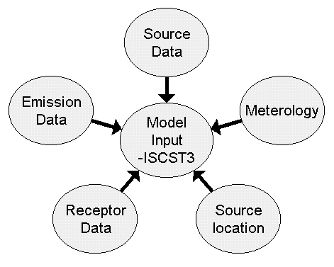

Figure 4
Model Inputs Required for ISCST3
Table 1
Input File for ISCST3

The output from the modeling program is either a concentration or a deposition rate based on the emission rate entered. The concentration values have to be multiplied with the unit risk factor, or potency factor to obtain the cancer and non-cancer risk values and also have to be adjusted for different routes of exposures. For a single pollutant, this can be done easily in a spreadsheet program. However, the complexity adds up when there are multiple pollutants with different emission rates with different routes of exposures. Programs such as ACE 2588, the Health Risk Assessment (HRA) program or the Hot Spot Analysis and Reporting Program (HARP) available from the California Air Resources Board make the task much simpler.
Step 2 -
Prepare a Health Risk Assessment - ACE2588 Program
The ACE2588 program is used to calculate the cancer risk from both inhalation and non-inhalation pathways, cancer burden, health hazard index for acute and chronic effects for multiple pollutants with different emission rates at each receptor location and to take into account multiple exposure routes. Samples of input and output files from ACE2588 are shown in Table 3 and 4. The data from Tables 4 and 5 are combined later in Excel and connected to ArcView to grid the receptor areas and plot the risk contours.

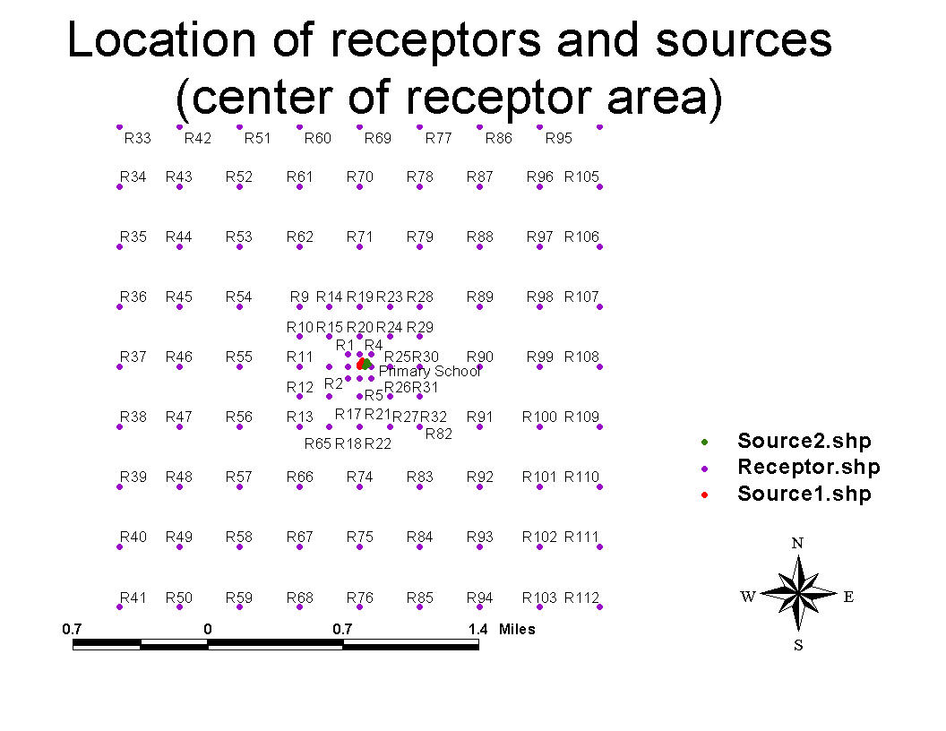

**Receptor location and population in receptor**
387348.0 3752739.0 .0 40.0 .1 .0R1
387348.0 3752639.0 .0 40.0 .1 .0R2
387348.0 3752539.0 .0 40.0 .1 .0R3
387448.0 3752739.0 .0 40.0 .1 .0R4
387448.0 3752539.0 .0 40.0 .1 .0R5
387548.0 3752739.0 .0 40.0 .1 .0R6
387548.0 3752639.0 .0 40.0 .1 .Primary school
387548.0 3752539.0 .0 40.0 .1 .0R8
386948.0 3753139.0 .0 250.0 .1 .0R9
386948.0 3752889.0 .0 250.0 .1 .0R10
386948.0 3752639.0 .0 250.0 .1 .0R11
386948.0 3752389.0 .0 250.0 .1 .0R12
0

The results of the risk isopleths are as shown in figures 5,6, and 7. To communicate the risk impacts, various demographic layers were added to the view to demonstrate the impacts on the community.
Figure 5
Location of receptors and sources

Risk Isopleths from A Single Source with Street Data

Risk Isopleths from Two Sources on the Same Receptors with Street Data
Figure 8
Determining Impacts of Risk Isopleths on Population Exposed
Summary and Conclusion
The questions asked most frequently in risk communication meetings are from individuals wanting to know what their own family is exposed to and if they are safe living in the risk isopleths displayed and what the regulatory agency or the industry is doing to address the problems. Questions such as these are to dealt with delicately and are also extremely difficult to answer. An inappropriate response could lead a complete breakdown of the communication and trust. The communication fails if the risk communicator resorts to technical jargon and downplays the risk of exposure or compares it to involuntary risk probabilities. The use of GIS is a tool among many others that can be utilized by the risk communicator to address public concerns and fears.
With GIS, the street layer and demographic information can be layered with the risk isopleths, to show the cumulative impacts, if any, on the community, and also the affected highest risk areas as shown in Figure 8. In comparison, quite often what is available to the risk manager is the static map as shown in Figure 1. With a GIS system, the risk manager can effectively answer the community questions and concerns about their concerns in an interactive manner. This paper hopefully demonstrates that GIS can be used to integrate dispersion models and can be a useful tool for risk communication.
