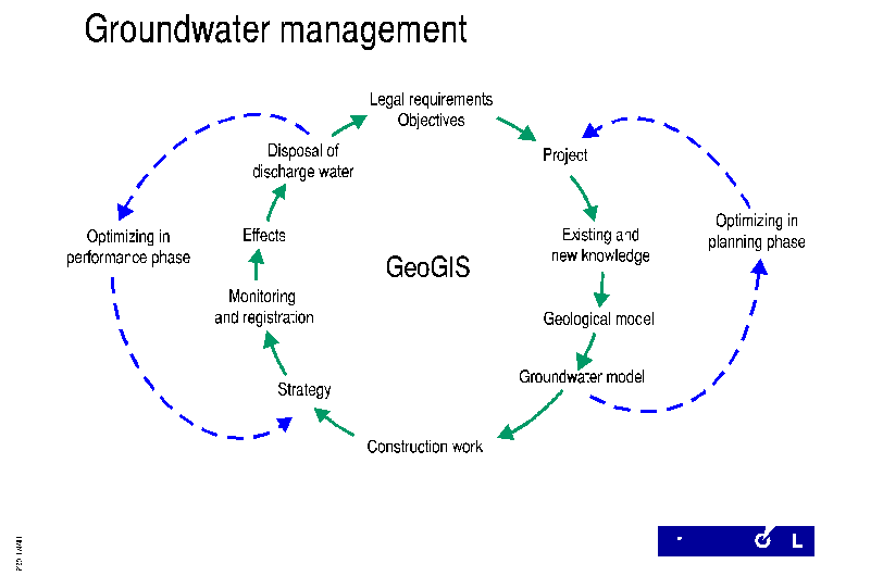

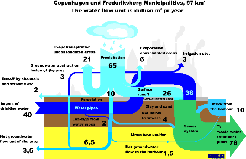

The groundwater management circle below is RAMBØLL's recipe for groundwater management in Copenhagen. Furthermore an understanding of the urban hydrological circle is essential - see figure 2.
RAMBØLL's groundwater management tools are
- GeoGIS, which is a GIS package including a large geo database with chemical data, discharges, groundwater levels etc.
- a 3-D interpreted geological model covering the Greater Copenhagen area
- 3-D groundwater models for the same area.
The following text gives a short description of RAMBØLL's ground water management in Copenhagen. The Øresund Link project is described as an example.
Figure 1 The groundwater management circle
Figure 2 The urbane hydrological circle

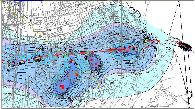

The hydrogeological model was established by adding hydrogeological parameters to each unit of geology, by implementation of transmissivities of the prequaternary, by implementation of hydraulic heads and by adding recharge, controlled by the character of the ground surface and by implementation of water supplies.
Figure 3 Øresund Land Works, Amager.
Groundwater table, metres, October 1996
