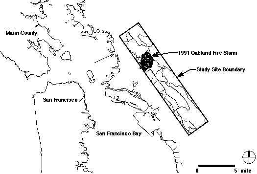

On October 20, 1991 an uncontrollable wildfire, a firestorm, destroyed approximately 1,580 acres and destroyed over 2,700 structures near the Caldecott Tunnel within the cities of Oakland and Berkeley, California. Since that time, other firestorms in California have devastated thousands of acres and continue to destroy property in the urban/wildland interface. The question remains, how can we prevent these disasters? This study was undertaken to construct a spatial decision support system (SDSS) so that planners and decision makers could better manage and formulate policy that would help reduce the risk of a firestorm. This paper models and assesses the risk of firestorms in the East Bay hills and produces a spatial support system that could help manage and reduce the risk of future firestorms. A geographic Information System (GIS) is used as a framework for quantifying fire hazard in this heterogeneous landscape. Two models, one to assess the wildland fire hazard and the other to assess the urban/residential fire hazard, are integrated and embedded within the GIS to map both regional and neighborhood risk. Hazard assessment maps are generated which represent the results of quantitative multivariate analysis and clearly identify the hazardous neighborhoods. The system produced provides an ideal tool for managing and reducing the risk of a firestorm. It allows for future adjustment of one or all of the parameters as fire prevention policy and techniques are implemented and hazardous conditions are mitigated. This feature provides a mechanism for accounting and feedback allowing for the appraisal of the success of mitigation.

The rectangle in Figure 1, delineates the study site in the East Bay and locates the 1991 Oakland Firestorm. Figure 2 is a 7 m2 true color composite of bands 1,2 and 3 from the NS001 scanner aboard a NASA low altitude aircraft. The area of the Oakland Firestorm, delineated in Figure 1, can be clearly seen in the image. The study site is considered the nexus of the urban residential and wildland landscapes in the East Bay and provides an excellent dataset for this type of study. The site is 54.3 square miles and forms a rectangle which follows the regional ridge line of the East Bay Hills.

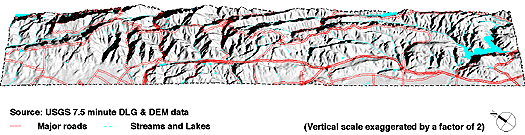

Digital Line Graphs (DLG), hypsography, hydrography and a Digital Elevation Model (DEM) are combined to construct a base map and a three dimensional surface model to satisfy the topographical needs of the wildland modeling. (See Figure 3)

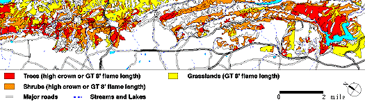

The BEHAVE model is applied assuming extreme Diablo wind conditions prone to firestorms. The topographic gradients are averaged for each polygon and the results are further classified into categories with 10% ranges. Many extreme slopes exist within the study site and are classified in an upper range slope category of >40% slope. The final parameter, the physical properties of vegetation, are assembled from a compiled set of conditions: vegetation type, fuel model, and development stage (See Table 1).
The results of this modeling effort classify each vegetation polygon for flame length (ft), rate of spread (ft/min), heat released per-unit-area (BTUs/square ft), and crowning potential where crowning potential refers to the probability of fire reaching the crown of an entire stand of trees or shrubs. From these results we generate hazard assessment maps with patterns of polygons which indicate spatially cumulative risk. (See Figure 4) The results of the BEHAVE model show that approximately 10,500 acres or over half of the wildlands in the study area have the ability to fuel and produce a firestorm in Diablo wind conditions.

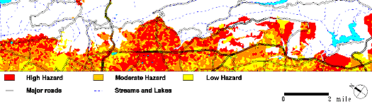

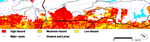

The RFHAM is applied separately for the two types of fire hazard: i) vegetation and its distribution with respect to structures, and ii) structural materials and building design. Expert knowledge from local fire fighters helped select the components to be measured and also rated the components with a risk value (1 to 4) to the observed conditions for each type of fuel characteristic in Table 2.
To effectively visualize the results of the model, the output is synthesized into three categories: high, moderate and low hazard for both structural and vegetation conditions. Figure 5 maps the residential fire hazard for structural conditions where 5,664 acres or 35% of the residential region is in the high hazard category for structural fuels and would likely contribute to the development of a firestorm in Diablo wind conditions. Figure 6 maps the RFHAM results for vegetation fuels and shows 7,679 acres or 47% of the residential region labeled as high hazard. This high hazard acreage is almost five times the area burned by the Oakland Firestorm and would potentially fuel another firestorm given the right weather conditions.
