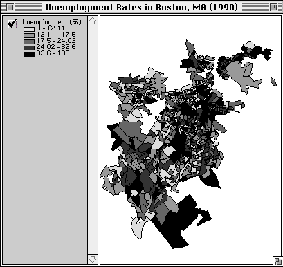

In all fields, GIS research should focus on exploiting the ability to synthesize disparate data themes. The single variable thematic map is one of the most common GIS outputs, but decision makers rarely want to know how one variable varies across space. They want to know about the interaction of many different variables. This type of analysis lies at the heart of GIS, but the way software is currently configured, the user must be familiar with a plethora of software-specific commands to perform an analysis, which means that the help of a GIS specialist is usually required.
Figure 1: Thematic Map of Boston Unemployment, Source: U.S. Census, 1990Figure 1: Thematic Map of Boston Unemployment
This problem exists because out-of-the-box GIS interfaces are designed to have broad applicability, but this standardization limits the ability of users to fully exploit the program. The need for better GIS interfaces is currently being addressed by individual users and third parties who develop "modules" using the GIS package's scripting language (the fact that all major GIS packages have a scripting language is an acknowledgment of this weakness in the user interface). Modules have been developed for forest management, political redistricting, bus routing, etc. This section can be thought of as the beginnings of an urban design module.
