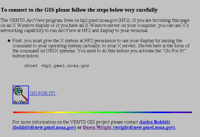

An example of the WEB page greeting to initiate VENTS ArcView is shown in Figure 3. The instructions explain that access to the GIS is only available to users with XWindow display capabilities. On UNIX systems, the host machine must be added to the .xhosts file prior further access. There are some web links for users wanting additional instructions on using ArcView and background GIS information.

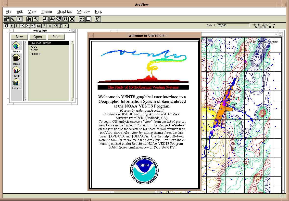

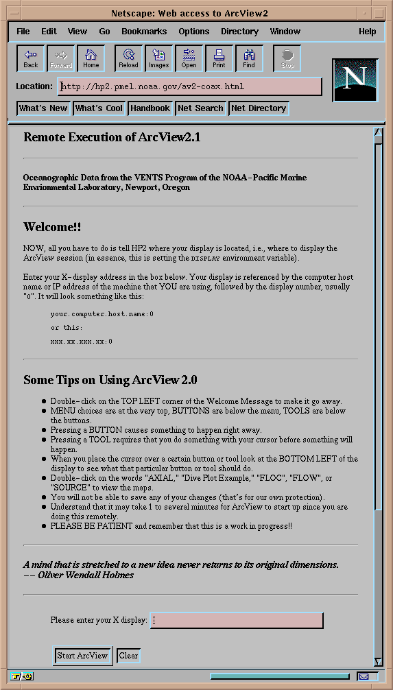

The second WEB page encountered by browsers is depicted in Figure 4. Users are instructed to enter their IP address with a ":0.0" extension before finally gaining access to the GIS. The IP address is essential in order for the XWindow display to send the proper graphics. If the user has successfully connected to the VENTS GIS, the initial ArcView project is displayed in Figure 5. A brief message box gives some additional ArcView instructions to get the user started.

Figure 3. Initial WEB page encountered by users attempting to access the interactive ArcView connection. The purpose of this page is to inform the user the connection requires the guests machine to recognize the host machine.
Figure 4. Second WEB page requires the user's IP address for proper transmission of the display.
Figure 5. If prior steps required by user were successful, this is the initial ArcView project display viewed by the user.
