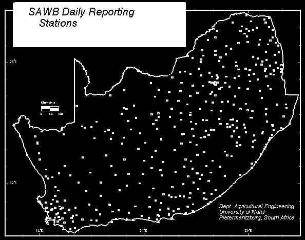

The problem that faces researchers in this modern era of hydrological computer modelling, is the availability of real-time rainfall data. The South African Weather Bureau (SAWB) has a network of ±400 daily reporting weather stations, Figure 1, that relay information to their central mainframe computer via telemetry. This paper will outline a proposed methodology that will allow researchers to do real-time modelling. Real-time will be defined to be 07h00 GMT on the previous day in this proposed methodology.

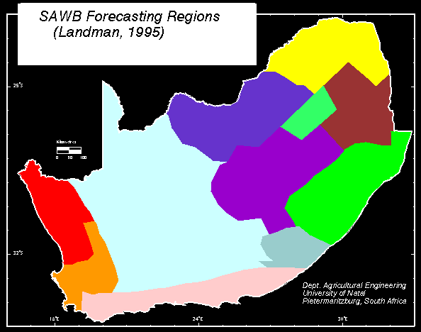

The monthly rainfall totals are used in a frequency analysis to determine percentiles of monthly rainfall. The method employed is based on a weighted average method proposed by McPherson (1990), whereby the P-th percentile, divides the data such that there is a percentage P of the rainfall totals below the P-th percentile and a percentage 100-P above the P-th percentile. Landman (1995) has divided southern Africa into 11 regions of similar rainfall, Figure 2, and has also assigned an attribute of "below normal" (B), "near normal" (N) and "above normal" (A) rainfall to each of the regions. Monthly rainfall greater than the 35th percentile and less than the 65th percentile is considered as þnear normalþ rainfall, rainfall greater than the 65th percentile is considered to be þabove normalþ rainfall and rainfall less than the 35th percentile is considered to be þbelow normal" rainfall.

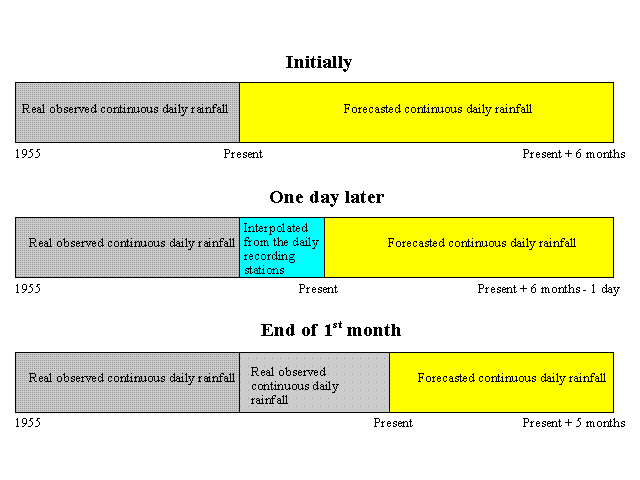

The above mentioned procedures are used to forecast approximately six months of artificial daily rainfall amounts that are used as input to a hydrological simulation model to determine what the soil water status of the country will be. In order for the research to be practical, real-time rainfall amounts are determined and overwrite the forecasted values and when two-thirds of the forecasted amounts have been replaced, the next six-months of forecasted values are determined.

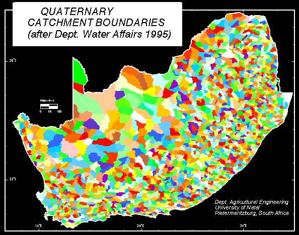

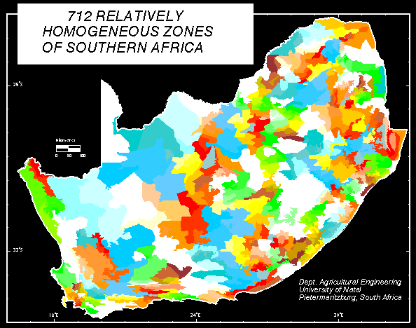

The size of these regions dictates the order of accuracy of the results and also the amount of computer time required to model the regions. A compromise between accuracy and processing speed must be reached for the successful modelling of southern Africa at a national scale. Dent, Lynch and Schulze (1989) subdivided southern Africa into 712 relatively homogenous response zones (Figure 3) and these zones were deemed adequate until Meier (1996) developed a hydrological database for each or the 1946 quaternary catchments (Figure 4) covering southern Africa.

The SAWB has a network of approximately 400 daily reporting weather stations that relay, via telemetry, the information to their central computer. These daily values will be downloaded automatically from the SAWB computer onto the CCWR computer, where the ArcInfo (Esri, 1995) software is situated, using the computer networks that link the different machines to each other. Lynch and Schulze (1995) found that the Inverse Distance Weighting Squared technique, using a modification proposed by Shepard (Yoeli, 1975), to be favourable in estimating areal rainfall images from point measurements. In this method weights are calculated depending on the distances between the grid node being estimated and the control or rain-gauge positions.

Meier (1996) has selected a representative daily rainfall station for each of the quaternary catchments and has also acquired, inter alia, temperature, soils, land-use and other hydrological information for each of the quaternary catchments. The daily rainfall for each of the quaternary catchments were selected and the missing values have been infilled (Meier, 1996). In other words, the rainfall for each of the 1946 stations have continuous daily rainfall amounts for the period 1955 till present. This period is then extended by six months using the forecasting technique and these extended rainfall datasets are used as input into the ACRU agrohydrological simulation model. Each day at 10h00 GMT the real-time daily rainfall data for the ±400 daily reporting weather stations will be downloaded from the SAWB computer and these amounts are interpolated to produce rainfall amounts at each of the 1946 quaternary stations. The ACRU model is re-run with the complete dataset. At the end of each month the daily observed rainfall data for all the 1946 stations will have been collected manually by the SAWB. The data capturing and random error analysis is then done at the SAWB before the public are allowed to access the data. This may take a day or so as the majority of these stations are recorded manually and only a very basic error check is done initially. After this monthly dataset of daily rainfall amounts have been downloaded from the SAWB computer, the interpolated values are replaced by these observed values and ACRU is once again re-run.
In other words, at first, forecasted values are used, these are then replaced daily by the interpolated values from the daily recording stations and finally the observed data replaces the interpolated values (Figure 5). When two complete months of forecasted values have been replaced by observed data, then the whole process starts again.

Figure 1 Positions of the SAWB daily reporting weather stations Return to text
Figure 2 Regions of similar daily rainfall in southern Africa (after Landman, 1995) Return to text
Figure 3 The 712 homogeneous response zones covering southern Africa (after Dent, Lynch and Schulze, 1989) Return to text
Figure 4 The 1946 quaternary catchment system over southern Africa (after Dept. Water Affairs and Forestry, 1995) Return to text
Figure 5 Schematic representation of the daily rainfall replacement procedure Return to text
