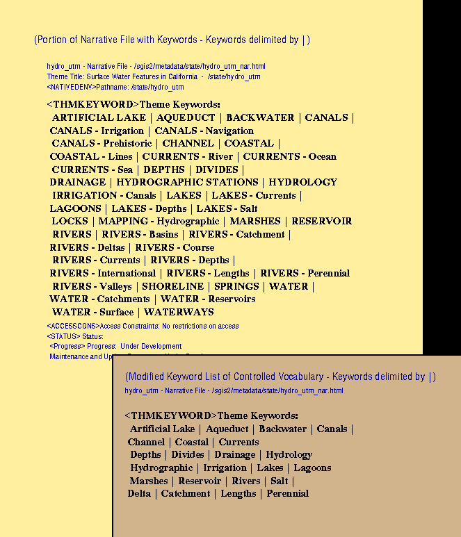

The capture of a theme keyword list for digital or nondigital data is part of the preliminary documentation. Capture of keywords provides a subset of the thesaurus which becomes a list of keywords used in metadata for Mid Pacific geospatial datasets. At any time, the theme keyword list for a GIS dataset may be included as part of fully compliant metadata documentation. Assignment of key words may be done either in ArcView or ArcInfo. Searches using the theme keyword index are done in ArcView, or ArcInfo or via World Wide Web browsers such as Netscape or Mosaic.

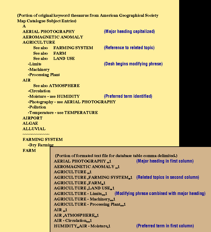

The vocabulary control function of a thesaurus identifies preferred terms and those they replace. Both sides of the relationship are noted. Terms which are controlled out of the vocabulary have a USE or SEE reference to the term that is to be used instead. The preferred term has a UF (Used For) or SEE FROM reference to the term or terms it replaces. Only preferred terms may be selected for use in keyword lists.

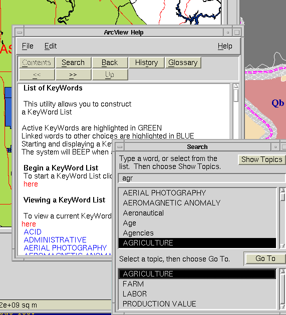

The initial implementation of our tool for selecting and reporting keywords for GIS themes is in ArcView. Avenue scripts were prepared to read in ASCII text files of the keyword lists or thesauri and output a reformated comma delimited text file. This text file can then be loaded into INFO or database tables. Any number of lists can be read in as required for different disciplines or to keep the tables current.
For loading into database preferred terms, modifiers of the preferred term, related terms, and terms that are not used are identified by different columns. The AGS Map Catalog Subject Entries was used as a test file. This list has some common characteristics of a thesaurus. There is a hierarchy of major terms, and terms with modifying phrases. Associated terms (See also) are identified. Terms which replace other terms (Used for ) are identified. Figure 1 shows a portion of the keyword list in the original format and as an ASCII file ready for loading into a database table.
As a database table, this list provides the basis for Avenue scripts to generate selected theme keywords to be included in metadata indexing or to be applied as a search string against existing metadata. Additionally, the table provides the management functions of identifying the terms actually used for indexing and the capacity to count the number of times each term is used.
Selecting keywords from very long lists or thesauri can be a frustrating experience. You need access to the entire list, but a selection routine that requires return to the entire list for each term is going to inspire very short lists and half-hearted indexing. In addition to selecting terms from the entire list, the designed routine permits the user to create groups of keywords for a theme and to select from existing groups of keywords associated with particular themes or subject areas. The designed routine permits the user to select terms from the entire thesaurus, prepare a group of keywords for a theme, or select words from an existing theme group. Figure 2 shows the process of reviewing and selecting keywords.
Presently, the Document program in ArcInfo provides very limited space for keywords in the metadata description. We use the Document program as one of our documentation tools. This ArcView application prepares a text file that can contain a robust list of identified keywords for a theme. This text file contains other metadata information that is important for our office in managing our GIS themes. This text file can then be substituted for the narrative file that is generated by the Document program. Figure 3 shows various keyword forms for a narrative text file of one GIS theme.
To recap, our implementation is in ArcView with storage of local thesauri and keyword groups in INFO or in dBase format. Any ASCII file of potential keywords can be used, provided they follow some basic conventions. Avenue scripts are used to review and reformat text files of keyword thesauri. Access for the user is in ArcView. No limit is set to the number of keyword phrases that can be identified for a theme.

This implementation makes use of ArcView with storage of thesauri and keyword groups in INFO or in dBase format. Any ASCII file of keywords can be used provided that they follow some basic coventions. The lists are then available for selection of keywords for assignment to a GIS theme or for query against the existing metadata.
