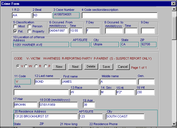

The diagram below shows the first part of the crime report entry form. The complete report form has the following sections: basic information of the incident, information about victims, witnesses, and suspects, detailed information about the incident, and information about the reporting officer. A scroll bar on the right allows the officer reporting the incident to move up or down on the form and type in the available information.
The First Section of Crime Report Entry Form Both the Suspect Report and Gang Report modules provide an additional function for generation of wanted posters. Pictures of a suspect, the get-away car, the weapon, etc. can be scanned and entered into the database and saved as image files. The wanted poster may display some useful information about the suspect, along with pictures and the street map to help locating the suspect.

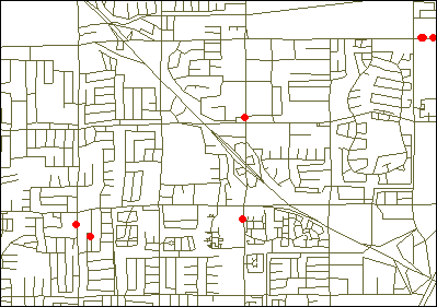

The analysis modules provide four types of efficient analytical tools: selection, query, chart generation, and cross referencing. In terms of selection, entries can be selected based on different criteria such as zip code boundaries, streets, subdivisions defines by streets, any geographical subdivisions, or by buffer zones around schools. Each criterion serves a specific purpose in crime analysis. For instance, the buffer zones generated from schools are useful for identifying narcotic offenders within a certain distance from schools. A main concern about schools is that penalty for drug dealing may be made stiffer by special legislation if it occurs within a certain distance from schools. Selection by zip code is useful for crime statistics within a metropolitan area.
The diagram below shows a typical example where school locations are entered in a specific database. Schools are denoted by darker symbols while crime incidents are shown in red. Buffer zones can be generated from schools and, for instance, all drug-related crimes that are within 1,000 ft from schools can be highlighted.
School Locations are Geocoded for Analysis Charts provide an efficient tool for viewing and examining crime statistics. For convenience, each analysis module includes a function which enables charts to be generated directly from the selected entries. Based on user-specified selection criteria, crime incidents, suspects, or gang members can be identified and mapped. Generation of charts according to the selected entries can be easily activated through a built-in procedure.
