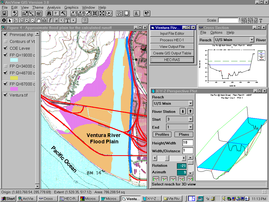

The case study presented here involves a hydrologic model that was used during the March 10, 1995 flood of Ventura River in western Ventura County. The flooding incident involved evacuation and subsequent flooding of an RV park built at the mouth of Ventura River, closure of State Highway 101, and partial damage and closure of the Main Street bridge (see Figure 4).

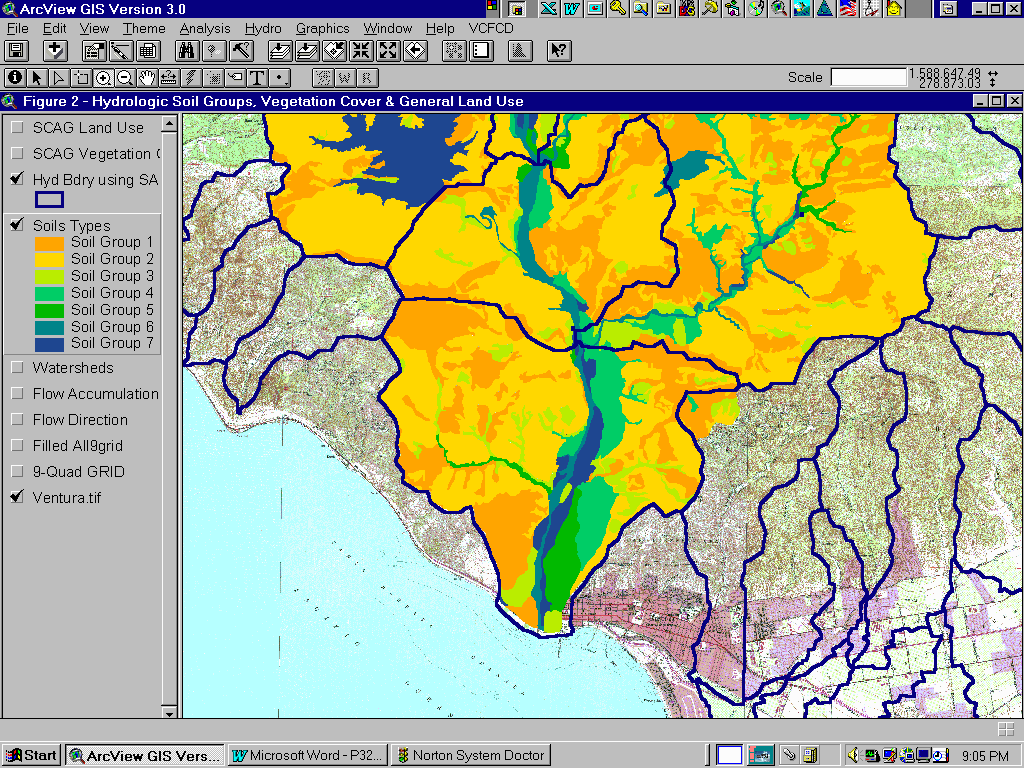

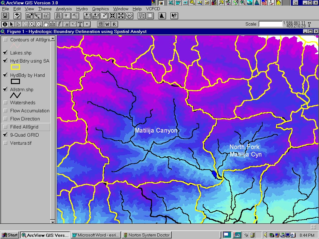

Nine 30-meter DEM grid files were combined and used to arrive at watershed boundaries, stream network, and flow lengths for each sub-basin. The newly released vegetative and land use coverages prepared by Southern California Association of Governments (SCAG) were used in conjunction with the available hydrologic soil groups to determine hydrologic parameters more accurately. The first immediate benefit of this exercise was that watershed parameters were calculated accurately. These would normally be estimated due to the enormous time involved in manual digitizing or planimetry.

Step 1. Procedure for delineating watershed boundaries and stream network
Figure 1. Watershed boundary and stream network delineation using Spatial Analyst
Step 2. Procedure for developing hydrologic parameters
Figure 2. Overlay of hydrologic soil groups, land use, and vegetation cover on top of watershed sub-boundaries is performed to determine basic modeling parameters

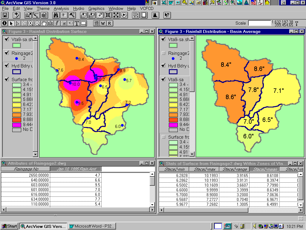

Step 3. Procedure for rainfall distribution & watershed modeling
Figure 3. Basin-wide rainfall is a key input parameter for hydrologic analysis
Step 4. Procedure for flood plain analysis and overlay of flood plain maps
Figure 4. Flood plain grid theme or polygons can be superimposed on top of the property ownership coverage (not shown) for quick flood assessment

After the January 10, 1995 storm events, a somewhat simplistic HEC-1 model was developed for the Ventura River watershed to provide flood control engineers with a watershed-wide modeling tool that included eleven sub-basins, two existing dams, and the stream routing reaches. During the March 10, 1995 storm event, this model provided useful information about the magnitude and timing of flooding in Ventura River based on the best available rainfall forecast. However, many of the parameters used in that model were estimated, primarily because it would take a very long time to develop accurate basin parameters for a 226-square mile drainage area. In addition, there were no complete land use, soils, or vegetation maps available for the entire watershed. A comprehensive hydrology study performed in the sixties was the main source of basin parameters for the recent HEC-1 model mentioned above. The GIS case study discussed in this report successfully recreated and improved the basic basin parameters in a fraction of the time it would take to arrive at these parameters using conventional techniques.
GIS allows us to redo basin parameter calculations for any size basin, and it does not really matter whether the watershed boundaries are created for a rational method study (40-600 acres) or unit hydrograph method (5 to 50 square miles). Furthermore, the technique introduced here can provide basin boundary lines very rapidly, as explained earlier. GIS also provides the benefit of giving the end user a bigger and more complete picture of what is likely to happen in a watershed. For example, it can provide recent or historical fire boundaries, slope failure areas, various soil types and their corresponding infiltration rates, topography, flood plain maps, aerial photography, contour maps, and many other useful sources of data that are readily available now.
