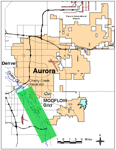

The Cherry Creek model consisted of a 72 column by 244 row grid of 200 foot squares and was oriented in a southeast to northwest manner along the axis of Cherry Creek, upstream of Cherry Creek Reservoir. Figure 1 shows the model grid in relation to the City of Aurora. Due to limited nature of this paper, detail description of the model parameters is not covered, however, more information can be obtained from the City of Aurora.

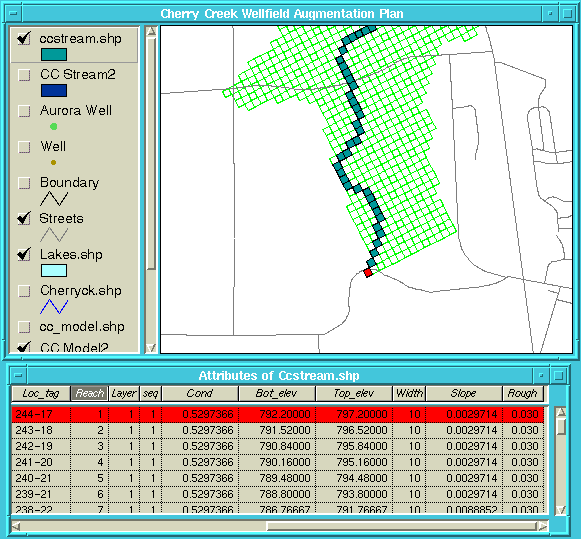

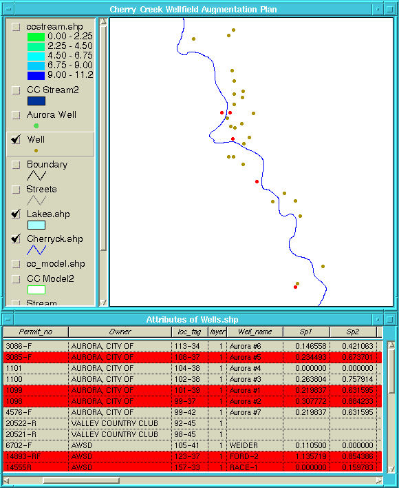

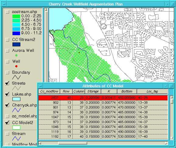

In order to display and evaluate MODFLOW simulations using ArcView additional attributes had to be added to the well, stream and MODFLOW attribute tables. A relate field called "Loc-Tag" was added to all coverages, as well as most database tables. The Loc-Tag field is simply a character string consisting of MODFLOW row and column number separated by a "-". Figure 2 shows the attribute table for the model layer, note the Loc_Tag field. With Loc-Tag, model input databases and output results can be joined to the respective coverage or shape file. This relate is helpful in displaying model results, such as drawdown or head, however, fixed attributes such as bottom elevation and transmissivity can also be displayed. One of the main benefits in using the GIS with MODFLOW is that simulation results can be displayed geo-referenced, allowing topological relationships between the model and other spatial features.

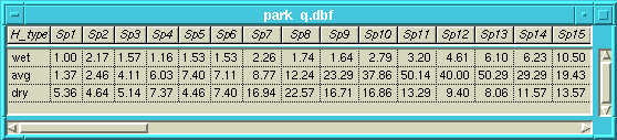

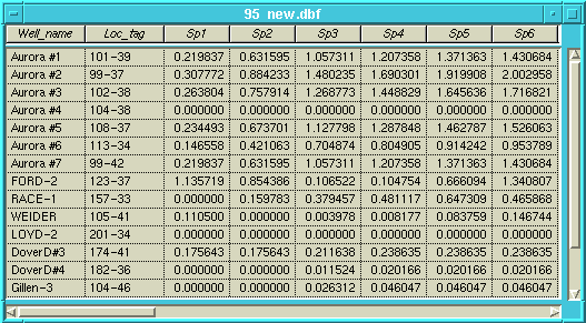

The first step in generating the WEL file was to design a database table for the well pumping data. The simple database design has one record for each well. Fields include Well_name, Loc-Tag, and Stress Period (one stress period for field). Figure 3 shows what the table looks like. Linking the well pumping table with the well attribute table using Loc-Tag as the relate field is done by the table join script ("Intable_join"). Once the tables are linked, the total number of wells to include in any simulation are selected either from the View or the attribute table. Currently, any variation in the number of wells pumping during the different stress periods has be handle via the well pumping table by using 0's for no pumping. MODFLOW will accept 0's in the WEL Package for pumping. Figure 4 displays selected wells and the joined attribute and pumping table that will be written to a text file. The WEL file generator Avenue script ("Pump_output") is activated by an icon, which will step the user through developing the WEL input file using various menus, including stress periods to be modeled and output file name. The user interface offers flexibility in allowing the pumping data to be in positive or negative values (MODFLOW treats negative discharges as pumping). The input data is justified to the MODFLOW format by calling a script called "Right_justify". The WEL input Avenue script can be found in Appendix A; in addition, a sample of the WEL input file is in Appendix B.
Output for MODFLOW simulations can either be in printed form or in binary files. Several C programs were written to read the MODFLOW binary output files and translate into ASCII test tables readable by ArcView. The C program first skips the binary file header then reads and stores the value for every cell in the time step, this is repeated for every time step in the file (Rindahl, 1996). Finally, the output file is created by first writing the header, then one line for each cell consisting of the Loc-Tag and the variable (e.g. drawdown, head elevation) values for each time step of the model run (Rindahl, 1996). Refer to Rindahl's paper (1996) for the program code.
The final process in displaying model results is handled through existing ArcView tools or through Avenue scripts. Using the Loc-Tag field in both the attribute tables and the MODFLOW ASCII output, the tables can be joined. As discussed in Rindahl's paper (1996), any model stress period result can be displayed using the legend editor of ArcView.

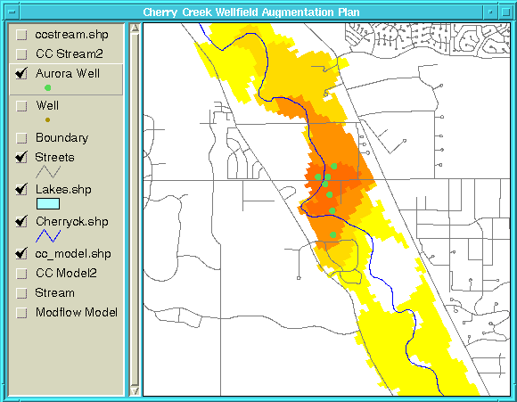

Several enhancements for viewing MODFLOW results were created in Avenue. One Avenue program allows the user to control the legend editor and another allows animation of time step results. Originally, these scripts were developed for ArcView 2.1, but were modified substantially for ArcView 3.0. The script controlling the legend editor allows the user to specify the increment displayed for selected time steps, then the ability to select from the color ramps available through ArcView 3.0. For example, the script creates a drawdown legend in even 0.5 foot increments. The created legend can then be saved for future use.
The final Avenue script converted to ArcView 3.0 is the animation of time steps program. Using the saved legend defined above, the user selects time steps to be sequentially displayed, showing a animation of drawdown fluxes, head elevation changes, or stream discharge. Several tricks in Avenue allows the animation to redraw only the aquifer portion of the display and not the entire view. Figure 7 illustrates the aquifer drawdown for Stress Period number 23 for a wet year scenario. Both scripts are included in the Appendix.
