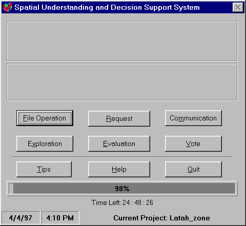

Main user interface window of SUDSS with tool buttons.

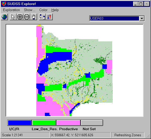

A logical place to begin working with SUDSS is the Exploration button in the main menu, which opens SUDSS Explore! window (see Figure 2).
Figure 2. The canvas of landuse map together with the landuse zone designation buttons
are used to delineate new landuse zone boundaries.
The window offers a minimum of necessary tools that utilize Map Objects, represented by tool buttons, to create a map representation of land use zoning plan. The user can see plans created by other users but can only edit his/her plan. Line and polygon drawing tools are provided for the on-screen delineation of land use zone boundaries. Since the user is supposed to create polygon shaped zones, a point tool is unnecessary. The user is also provided with a typical set of tools allowing navigation within the map. These tools also allow him/her to display the full extent of map, zoom-in, zoom-out, pan the map, and split the map window into a double

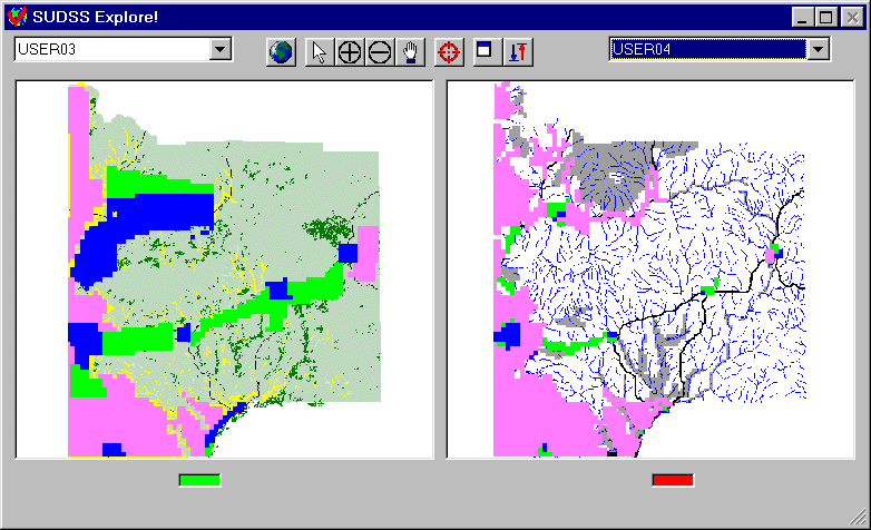

Figure 3. One of visualization functions offered in the Exploration tool is split map window allowing the pairwise comparison of maps.

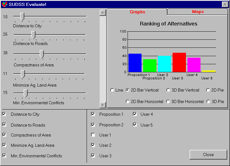

During the second step, the alternative plans can be evaluated both visually and quantitatively. A quantitative evaluation measures the performance of every plan on a number of evaluation criteria by expressing it in one summary score. The score, also called a final appraisal score, can be used to order alternative plans from best to worst. Evaluation criteria are the bases for computing the score for each plan. One can think of evaluation criteria as the operational objectives of a comprehensive land use plan. Each alternative plan receives a value representing its performance on each evaluation criterion. These values are then computed automatically by SUDSS. The outcomes are effected by how well location and shape of land use zones delineated by the user satisfy a given criterion. For example, the value of criterion "Compactness of area" measures how well land use zones compare with the ideally compact zone shape - in this case a square. The more complex boundary of a zone, the lower value received by a given plan on the criterion "Compactness of area". In order to calculate a final score for the entire plan, individual criterion scores are multiplied by weights that represent the relative importance of each criterion. Finally, the products of criterion values and weights are summarized. The sum yields the final appraisal score for the plan. Although all computations involved in the evaluation of zoning plan are carried out in the background by SUDSS, each user has to initiate the process by selecting from SUDSS main window the Evaluation button. This action opens SUDSS Evaluate! window (see Figure 4.)
Figure 4. Evaluation window provides the necessary functions for multiple criteria evaluation of alternative landuse plans.
The upper left quadrant of the window provides sliders corresponding to the evaluation criteria. Users move the sliders to select a weight for each criterion. Each weight represents a relative importance assigned to a given criterion. The sum of weights must equal 100. The user also controls which criteria to include in the evaluation by checking the square boxes next to criteria names in the lower left quadrant of SUDSS Evaluate! window. Experiment participants have another 24 hours, following the plan development, to complete the zoning plan evaluation. In practice, half an hour is usually enough to determine the best criteria weight settings and to select the winning plan.
An important component of collaborative work is the fair evaluation of all plans developed by group members. Each group member can evaluate alternative plans, including his/her plan. Nothing prevents participants from tinkering with criterion weights and ultimately the results of evaluation, suppressing this possibility would force the participants to behave entirely "rationally" which is not always true in the decision making (Kaneman et al. 1986). Decision support tools built in SUDSS information and guidance to make rational and logical choices.

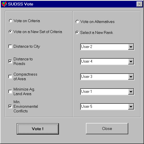

The results of individual evaluations are aggregated in the voting during the last 24-hour period. Voting on the rank of alternative landuse zoning plans is then carried out with the Vote window.
Figure 5. Vote window allow the user to submit votes on evaluation criteria
(which evaluation criteria should be used) and order of alternatives (landuse plans).
The vote function allows submission of the ranking of alternatives to the experiment server. Voting results can be viewed by the participants after downloading them from the server (see Figure 6).
Voting results are calculated by a ranked vote technique. The ranked-vote technique assigns ranks to alternatives based on the following rational: the higher position of an alternative plan on the voter’s list the higher the rank assigned. The voting position of an alternative is determined by adding the ranks for each alternative from every voter using the Borda social preference function (Hwang and Lin, 1987). This type of vote aggregation prevents a contentious candidate who ranks very high with some group members but very low with others from winning, and promotes a consensus candidate.
In the example of voting results presented in Figure 6, four out of five evaluation criteria have been selected by a group. Alternative #1 has received the highest score based on the ranked vote followed by proposition #1 and alternative #2. The measure of variation divided into three intervals informs about the degree of unanimity in voting for a specific alternative or the lack of thereof. Alternative #1 is clearly the favorite having not only received the highest score but also a high level of agreement among the voters.
