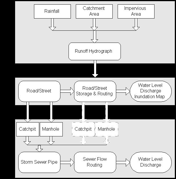

    The Dhaka City drainage system consists of the combination of closed conduits, box culvert and open channels. This complex system requires a model schematisation which allows a correct physical representation of the described interaction between the underground pipe and the street system. Surface flow on the streets should thus be described with more detailed methodology. The parallel system methodology adopted for the present modelling study is schematically outlined in Figure 2.
    Figure 2. The methodology adopted for the present modelling study.

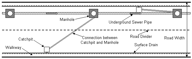

  • A sketch of the connection between the streets and the pipe system can be seen in Figure 3.
    Figure 3. Sketch of the connection between the streets and the pipe system for the Dhaka drainage system.

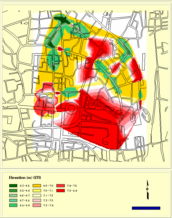

    The alignment off and elevations along the road network of the Segunbagicha Khal Catchment area were digitised by DMDP. Major roads in the model area were digitised by SWMC during the study from a map (1:20,000 scale).The map showing the drainage networks of the Dhaka City were collected from DWASA. The important features such as primary and secondary drains of the model area were digitised and used in the MOUSE model. A DEM grid of the study area were generated based on this available topographic data. The extent of the DEM is appox. 5x5 km. It is estimated that the DEM yields a sufficiently accurate representation of the elevations along the streets and other areas prone to flooding.
    Figure 5. Digital elevation model of the Segunbagicha Khal Catchment.

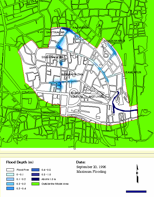

    Flood Inundation maps provide a most effective media for visualising flooding. Results (here water levels) from a MOUSE simulation are available in the nodes and along the pipes connecting the nodes. Flood inundation maps for different scenarios, are generated using GIS. MOUSE results are geo-referenced and related through a coordinate system common with the DEM grid. These results can be displayed graphically in the GIS.
    As explained earlier, two parallel and interconnected networks, one for underground pipes and other for the street system, have been modelled. The water levels on the streets mainly cause flooding on the streets and the adjoining areas. Using interpolation routines in MOUSE GIS continuous 3-D water surfaces were constructed based on the simulated street water level. The DEM elevations were subsequently subtracted from the water level surface delineating inundated areas by flood extent and flood depth. To verify the flood maps interpolated from MOUSE simulations these were compared with best available information on flooded areas The possible extent of flooding for each of the street sections were estimated based on the experience and judgement of the relevant engineers in the DWASA and digitised. The comparison is shown on Figure 6.
    Figure 6. Comparison between simulated and observed flooded locations in the Segunbagicha Khal Catchment.
