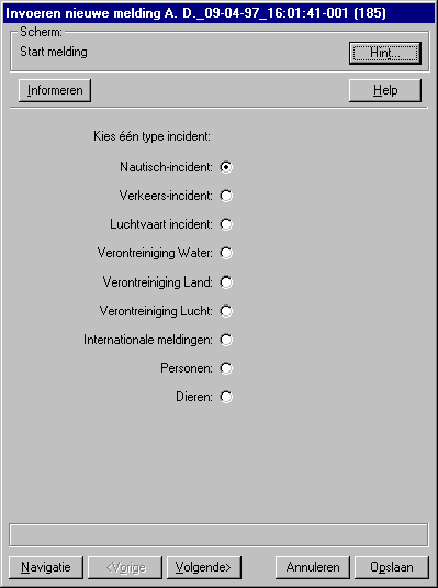

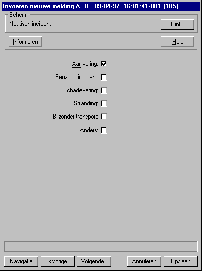

AQUABEL is an information system which supports the
Dutch government in dealing with incidents and calamities on national
waters. The system provides support in collecting and processing
the details of reports. For this purpose, a reporting system has
been developed which quickly collects all the relevant information.

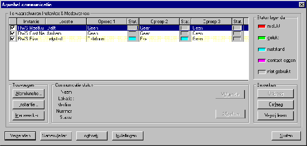

After that, this data is passed on directly by the system via
various communication methods to relief agencies, authorities
and (drinking water) companies. AQUABEL also contains the details
of chemicals, which provide crisis managers with a quick insight
into the seriousness of the pollution and the measures to be taken.

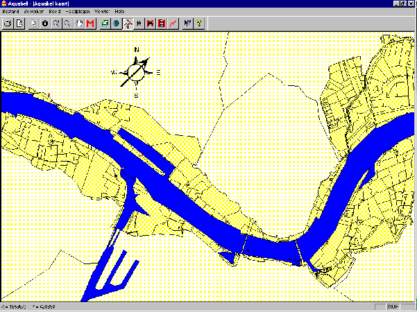

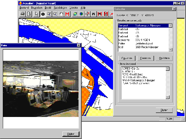

AQUABEL has a GIS (MapObjects) interface which shows
the service area for which the relevant local authorities are
responsible. The GIS interface contains many functionalities.
Apart from the usual methods of searching and retrieving local
data, AQUABEL is also able to communicate through GIS. Based on
the details of the location, it is decided which relief agencies
are to be alerted. After an object on the GIS map is selected,
the telephone number of the person to be contacted shows up with
whom the operator can make direct contact by telephone. In addition
to the telephone, other means of communication can also be used
with AQUABEL (fax, e-mail), which are controlled from the GIS
interface. Based on the report and location data, it is possible
to alert many organisations in a very short period of time.

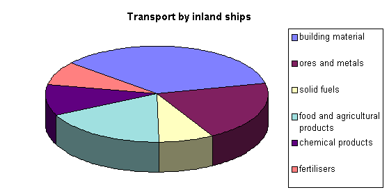

Illustration: Types of
goods per inland ship

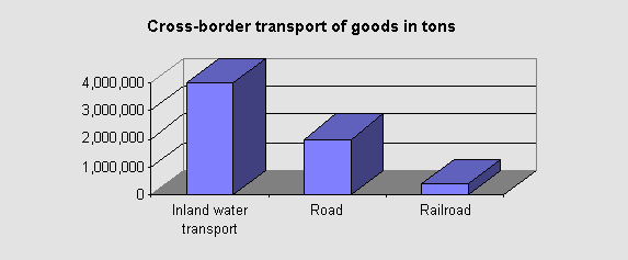

Annually, more than 400 million tons (that is 400
thousand million kilos!) are transported by water. More than 60%
of the total international transport of goods is by ship!

AQUABEL has a GIS (MapObjects) Interface which shows the service area for which the relevant local authorities are responsible. The GIS interface contains many functionalities. Apart from the usual methods of searching and retrieving local details, AQUABEL is also able to communicate through GIS. Based on the details of the location, it is decided which relief agencies are to be alerted.
After an object on the GIS map is selected, the telephone number of the person to be contacted shows up with whom the operator can make direct contact by telephone. In addition to communicating by telephone, AQUABEL is also able to send faxes and E-mail from the GIS interface.
Thanks to the reporting and location data, it is possible to alert the right authorities in a very short period of time.

The new AQUABEL system now consists of three modules:
Illustration: AQUABEL
GIS interface
Illustration: Reports
module
Illustration: Communication
module

What can we do with AQUABEL's GIS interface?
Quick insight into environmentally vulnerable areas is obtained by switching to another overlay file. It is also possible to obtain information from the land register and on companies situated on the water.
Below you will find an example of object selection:
Illustration: an object
selection
