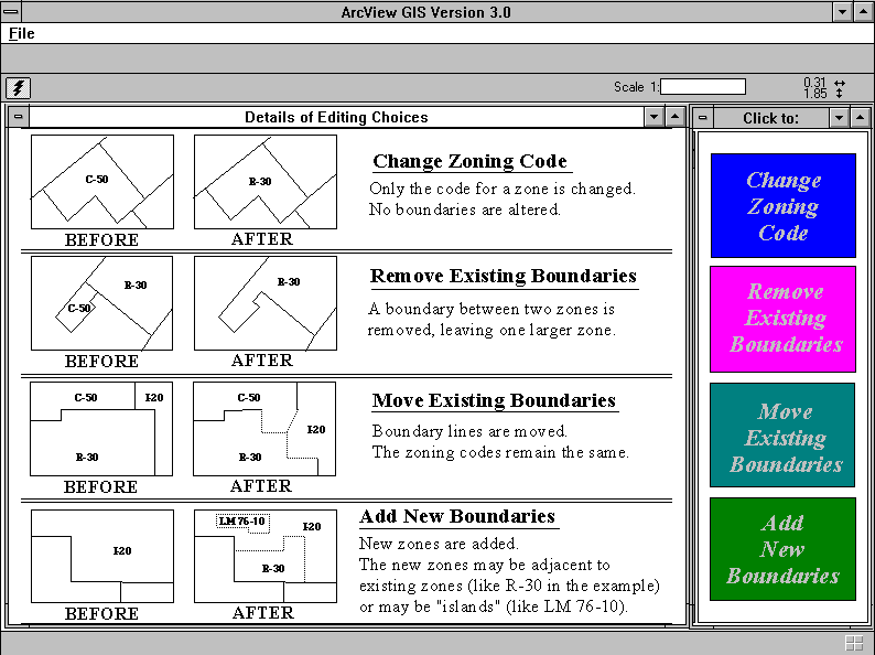

Users opening the ArcView project designed for maintaining the zoning GIS dataset are greeted by the following series of four possible edit routines:
Introductory zoning edit screen
Notice that the four possible edit routines for the zoning layer are described with both words and pictures. Many users prefer a picture or cartoon-like direction rather than a written direction. To the right of the directions are colored polygons. These are features of a polygon shapefile with hotlinks to Avenue scripts that activate other projects.
In this example, the user wants to subdivide one parcel into two parcels, so she clicks the "Add New Boundaries" button. The result is the following screen:
The Add New Boundaries editing screen

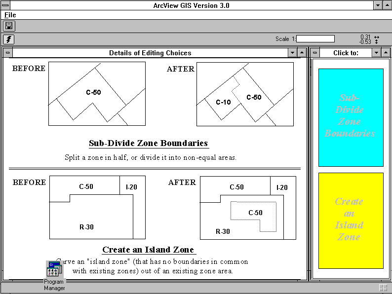

Because the task of adding new boundaries could involve splitting an existing zone or creating an "island" zone within an existing zone, both options are the topic of this user screen. In this example, the user wants to sub-divide zone boundaries, and so clicks the blue box to be taken to the next screen.

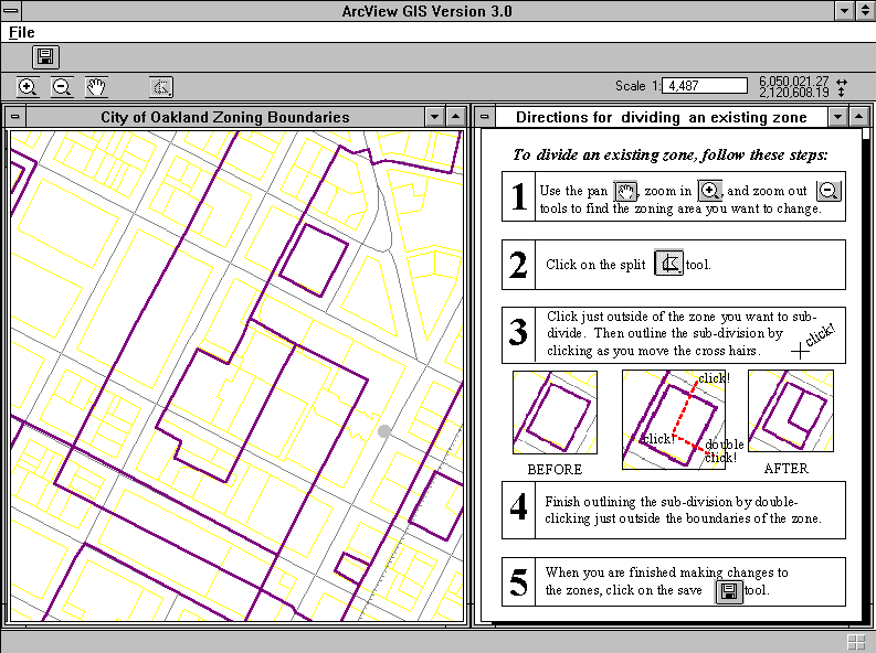

The next screen has step-by-step directions for subdividing zones. It looks like the following:
The user chooses to sub-divide a zone
Notice on this screen that the only tools available to the user are the ones described in the directions at the right of the screen. Even tools like the pan tool or zoom tools, which are often assumed to be intuitive, are mentioned in the help screen (although not defined in detail).
Also notice that the tool icons have not been altered from their standard ArcView appearances. If users advance to the full functionality of regular ArcView, they will still recognize the editing tools from these maintenance sessions."
