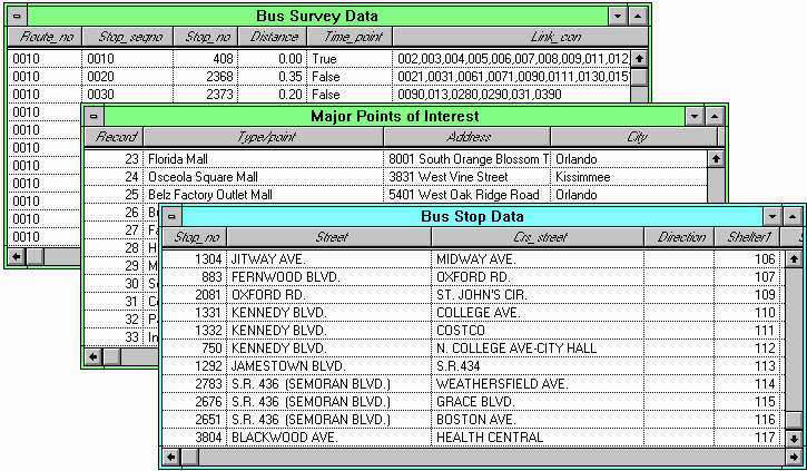

The second phase of the project focused on the development of a customer service information system. At this point, databases from LYNX and those created by PBS&J came together to provide the non-spatial data that would eventually be utilized by customer service representatives through a graphical interface.
The first and largest database to be developed was a bus stop inventory. Over 4,000 bus stops were entered into a coverage by using either their intersections, addresses or distances from known points. Once this coverage had been completed, it was joined with the route database provided by LYNX. At this point data such as transfer links, connecting links, stop sequence numbers, route names and stop numbers could be incorporated into an application to be provided to customer service personnel. Data locating schools, shelters, and major points of interest around the Orlando area were also collected and integrated into the application.
Exhibit 2. Example of Non-spatial data integrated into the Application
