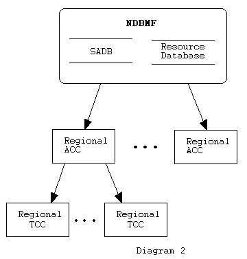

Diagram 2 illustrates the structure and flow of data throughout CAATS.

With the exception of airspaces[3], all aeronautical data are loaded into the SADB from within CAATS, via Oracle into ArcInfo. External data in the form of internationally and nationally published data sets are ingested by the Tabular Data Management Subsystem (TADM). They are parsed, validated and stored into Oracle tables. Views are presented to AGIS, which converts the tabular representation into coverage models, complete with classification, attributes, and symbology.

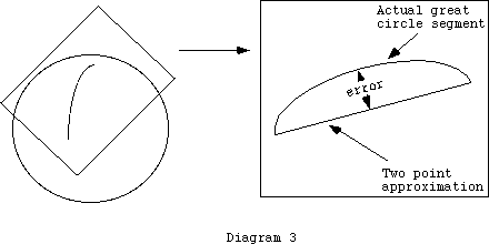

Many GIS applications use local approximations to the earth by projecting geodetic coordinates onto a plane. Errors in position introduced by the planar model are small because the objects under consideration are small or the data is dense. This is not always the case in ATC where the data is sparse and, the spatial extent is large. Errors are deceptive and can imply an unsafe course of action

The problem for ATC comes down to the density of the sampled data. The best course here is to discuss the problem in parallel with an example. An airway segment is represented by a great circle between two fixes. If we project the fixes onto a plane, and then describe the airway by connecting the two points, a substantial error is introduced. In reality, a flight tracking along this airway will sweep out a curve, as shown in diagram 3. The maximum error will occur at the midpoint. This error is largest when the two points have the same latitude. If the latitude is 0, there is no error. As the latitude increases (or decreases), the error increases. Performing explicit over-sampling of the great circle will reduce the error. Each point introduced will decrease the error, which will never vanish, but can be minimized. It now becomes a balance between the issue of safety and the volume of data used to model a phenomenon.
The solution to this problem of geodesy is to reuse components of the on-line ATC. CAATS supports a collection of tools for performing geometric operations on a sphere. The tools are used in a myriad of tasks, such as calculation of the predicted and actual time of flight intersection with airspaces. An interface was developed which allows the AGIS application to call, directly from ARC Macro Language (AML), a subset of the Geometric Services (GEOM) subsystem. The services provided include great circle segment intersection, and small and great circle segment densification. This interface is used extensively throughout the subsystem, initially when data is ingested into the system, but also in the interactive construction of airspaces.

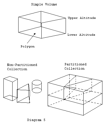

Airspaces are modeled spatially by the simple volume model. A simple volume consists of a closed polygon on the sphere, and an associated altitude interval. Sets of simple volumes are grouped into complex volumes. Collections of volumes model airspaces, and are separated into two classes: partitioned and non-partitioned collections. In a partitioned collection, the spatial relationships between each simple volume are known, and a strict set of geometric rules is applied. In a non-partitioned collection, each volume is essentially stand-alone, and no rules are applied to the collection as a whole, only to the individual volumes.
An application of the region model in ArcInfo and a collection of AML developed algorithms support the creation of volume collections. The following rules are applied to all collections:
If the collection falls under the non-partitioned class, no further rules apply. If the collection falls under the partitioned class then the following additional rules are enforced:
Given the definition of partitioned and non-partitioned collections, airspaces map into the classes as follows:
