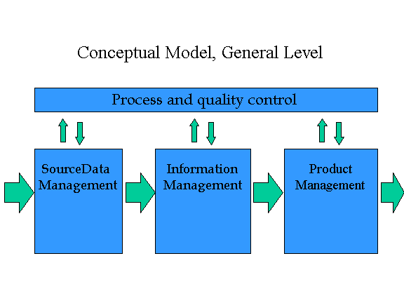

Flow of information, conceptual model
A number of work items were activated within our co-operation in order to establish the common ground for systems specification. We investigated data models, updating procedures, pre-processing of incoming new information etc. The fundamental result of this preparatory work early in the project was what we called the Conceptual Model. This model describes the different processes that we saw needed to handle the information in an efficient way.
The conceptual model identifies three clearly separated steps of the data processing within our hydrographic departments.
- Source Data Management includes all the necessary preprocessing of incoming data. A number of dedicated applications for treatment of hydrographic surveys etc. are already in place here. The unit of processing is the data set.
- Product Management handles output of information to product systems for printed charts, publications as well as digital products. The unit of processing is the product.
- Information Management is a central part of the information flow where all the necessary information is handled in a product independent way. The unit of processing is the feature. The data model must be sophisticated enough to handle our abstraction of "the real world". This includes a complete set of attributes as well as relations with other features in the database.
We also identified the need for an overall systems layer with process- and quality control. We need functionality to control and monitor the information flow and to record status at important check points.
Compared with the present situation the information management as well as process control are the parts we have to establish or improve. These parts are more or less missing today.

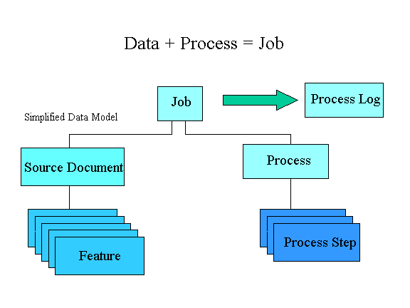

Process and input unit control
When new data (completely new features or changes to existing features ) enters HIS this is always performed in what is called a Job. The Job links a selected process with a set of new data and the process contains several steps normally. The results, statistics and any comments of each process step is recorded in a process log.
Furthermore the source and general quality information of any new data is always described in a meta object or Source Document which is stored in the database. Each feature is linked to a valid Source Document.
The important issue is to maintain a defined audit trail with regard to processing and source information.

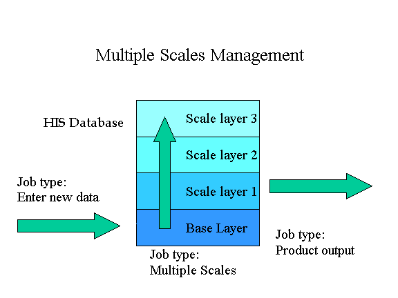

Multiple scales management
Within the database there is a need to maintain the information prepared for different scale layers in addition to the base layer where the best available data is managed. The main reason for the existence of these scale layers in the HIS database is the fact that we can not rely on automated methods (generalisation etc.) for producing products in large scales. The transfer of new information from base layer to a range of scale layers is controlled in a similar way as input to base layer. This will be based on a transfer queue where references to new ,changed and deleted features automatically appear after commit to base layer.
