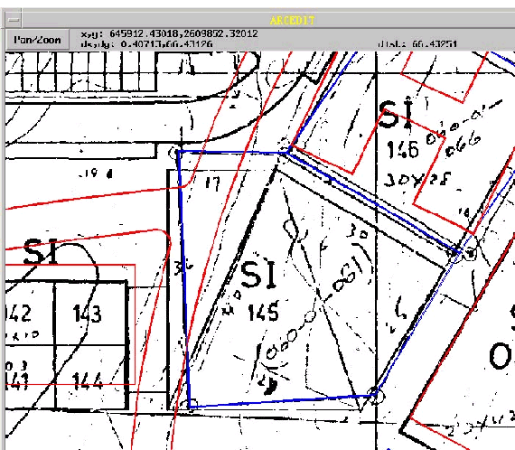

There was good success in overlaying the four data sources for the digital basemap. One potential source of error came in the interpretation of the NSA aerial photography. For example, pavement edge delineation is difficult in areas where asphalt, sand and gravel roads converge. This is common in the rapidly growing Muscat municipality. Consequently, there were some inaccuracies in the NSA AutoCAD planimetric base. Another source of error is that the scanned images were based on 20-year-old mylar drawings and the mylar had stretched during that time. Finally, there may have been errors made in manually transcribing survey coordinates from the Krookies to the Excel spreadsheets. Given these sources of error, there were not significant discrepancies when the basemap data was overlayed. In some cases, building footprints are shown extending beyond parcel boundaries. This may be the result of small scale data displayed at a large scale, or the parcel boundaries may have been transferred incorrectly from the Krookies. In other instances, the polygons created from the Krookie-based ASCII file overlay precisely with the parcel outlines scanned from the 20-year-old planning area maps.
For the purposes of demonstrating the different data sources that can be entered into a GIS, the basemap compilation was considered a success.
Figure 2 shows an overlay of the scanned planning area map in white, the new parcel coverage in blue and the AutoCAD-derived planimetric coverage in red.

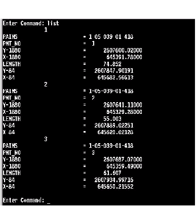

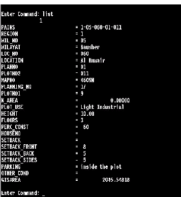

3.2 INFO Files landuse.dat and coord.dat
Parcel attribute information was extracted from Krookie land records sheets and then entered into Excel spreadsheets. Attributes include the parcel ID number, land use, building height, existing parking, and village name. The Excel files were saved in ASCII format and then ADDED to the new INFO file, landuse.dat. A relate was saved between landuse.dat and the new parcel coverage to emulate a future link between ArcInfo and an external Oracle database. A second INFO file, coord.dat, was DEFINED to store coordinate information for each parcel corner. Items include the parcel ID number, X and Y coordinates in both WGS84 and Clarke1880 projections, the point number from the Krookie drawing, and the segment length of the side of the parcel. For the prototype, approximately 100 land records were added to the two new INFO files. Since the INFO files were RELATED to the newly-generated parcel coverage, there was a one to one match between the INFO file records and records in newparcel.pat. For the purposes of demonstrating that a parcel polygon record could be linked to a corresponding record in a separate database, this task was considered a success.
Figures 3 and 4 present examples from landuse.dat and coord.dat.
Figure 3: landuse.dat
Figure 4: coord. dat

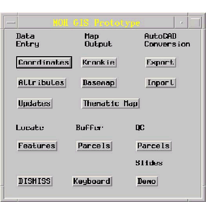

The third prototype task was the development of end-user applications to demonstrate ArcInfo functionality of basemap and land records maintenance. Throughout the prototype period, AMLs were written to facilitate data translation, data conversion, hard copy output, and to demonstrate other GIS functions. These AMLs were eventually integrated into a series of menus to demonstrate an ArcInfo end-user application.
Figure 5 illustrates the prototype demo menu that integrates several applications.
Figure 5

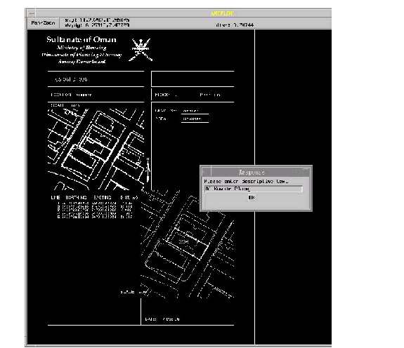

Of the AMLs written to generate hard copy output, the most important was the routine that created a GIS-derived Krookie. The Krookie is the Ministry's most widely used land record document so it was imperative that the prototype demonstrate the ability of ArcInfo to store graphical and tabular cadastral information, and then retrieve and plot this information easily. Significant time was spent in designing ARCPLOT routines to emulate the look and content of the Ministry's Krookies.
Figure 6 is an example of a GIS-generated Krookie.

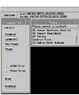

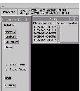

The fourth group of AMLs were developed to demonstrate typical GIS functions that MOH staff might use when their system is fully operational. One example is to query the database to locate a parcel based on a parcel ID number. Another query was developed to find a parcel based on prominent landmarks. In Oman, there in no system of street addresses, so highway navigation is instead based on landmarks. For the prototype, a point coverage of landmarks was developed to support this query.
Figures 7 and 8 provide examples of the locate functions.
