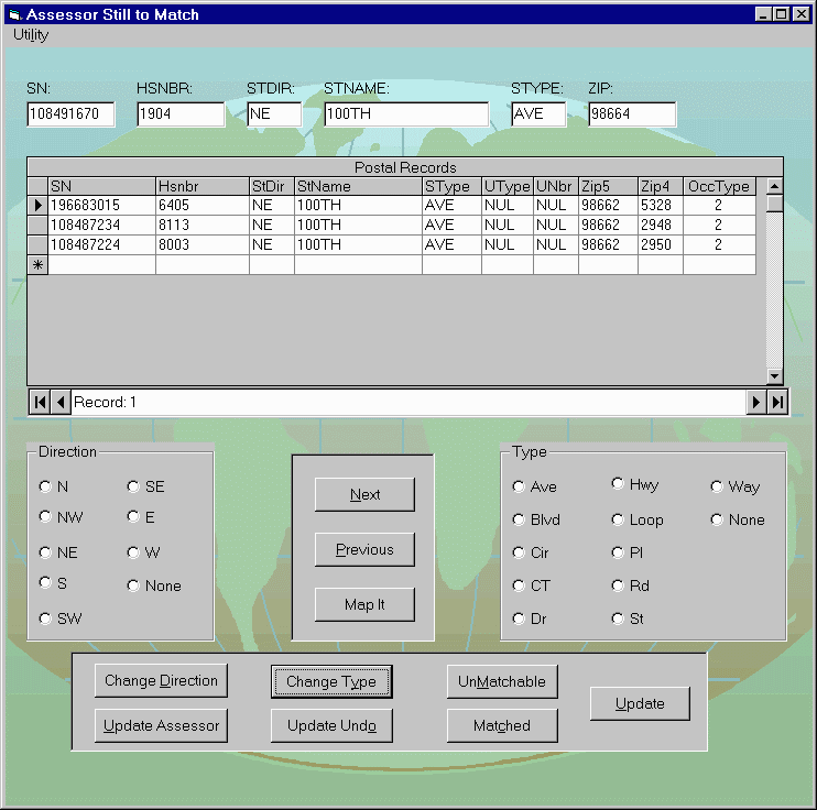

A random selection of Assessor's data was tested to determine the most common types of error. The first and most common type of error discovered was an incorrect street type. For example, an Assessor's situs address was coded as an avenue (AVE) when it should have been coded as a court (CT). The second most common type of error discovered was an incorrect direction. For example, an Assessor's situs address was coded as Northwest (NW) when it should have been coded as Northeast (NE). The third most common type of error was an incorrect or misspelled street name. Based upon these findings, the application design was begun. Visual Basic 5.0 and Map Objects 1.1 were used to develop the application. Two forms were developed for interacting with the database; one for data manipulation entitled 'Assessor Still to Match' and the other for spatially displaying the data entitled 'Census 2000 Project'.
The Assessor Still to Match form (see Figure 1) lists the first unmatched record in Table 1. It also lists all unmatched USPS addresses in the Table 2 that have an identical street direction, street name and street type. This form contains the functionality that updates the database. In particular, two tools were developed that allow street direction and street type data to be changed on the screen since these were most common typographical errors were found (see the Change Direction and Change Type buttons on on the Figure 1).By changing these fields, a new list of USPS records appears. The user can then click on the USPS record(s) that match the four street address fields in the Assessor record and use the Update Assessor button to copy the serial number from Table 1 into Table 2. An Update Undo button allows the user to reverse the action taken with the Update Assessor button. The Matched and Unmatchable buttons place a code in Table 1 which remove that assessor record from further consideration.

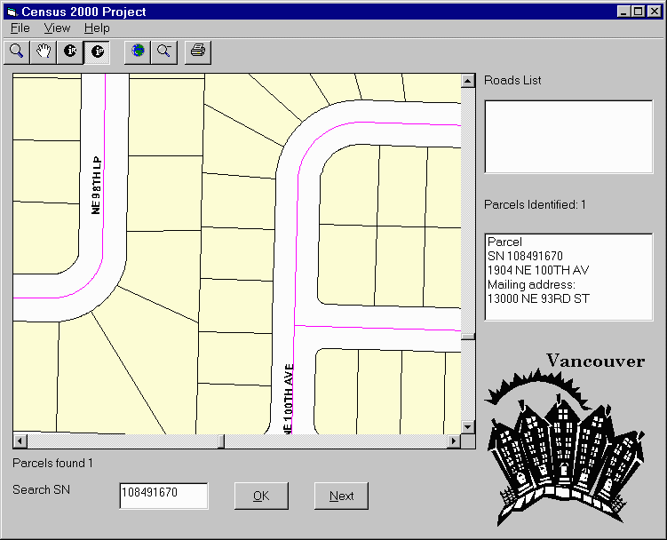

The Map It button (see Figure 1) allows the user to call the Census 2000 Project form (see Figure 2). This form brings up a map of assessor's parcels and street names, while highlighting the parcel listed in the other form. A tool bar allows the user to zoom, pan, and identify adjacent parcels. The functionality of this form is for visualization and address determination. In addition to viewing parcel location, this form also lists owner and situs addresses. Between the street names, parcel layout and addressing information, the user can determine the nature of the addressing error, determine the correct address and search for it in the list of USPS addresses on the Assessor Still to Match form (Figure1).
