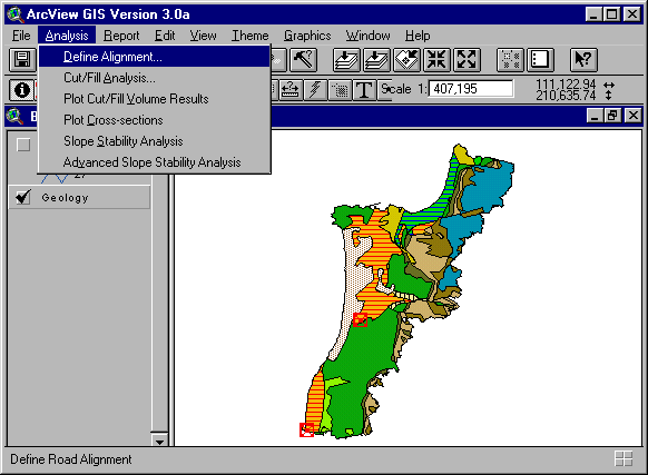

A customized ArcView menu-driven interface, tailored for this framework, is loaded as soon as the project is launched. The analysis functionalities are grouped in the "Analysis" Menu (Figure 1), while the Evaluation functionalities in the "Report" Menu (Figure 2).
The "Analysis" Menu contains six modules that go trough a step by step design and analysis of the user proposed road alignment.

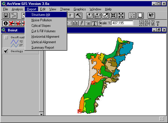

The "Report" Menu contains seven functions that evaluate the proposed road alignment from the different aspect listed: environmental, geotechnical, geometric design, and report the results.

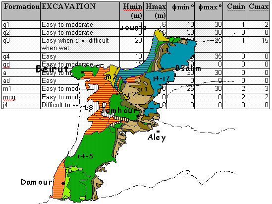

3.1 The "Geology" and "Faults" Coverages
This coverage is needed in order to provide guidance as to the materials that are to be excavated or filled over. This is an important aspect of the evaluation of road alignments that has important cost implications. The traditional practice is to address this aspect of the design only after a preliminary alignment is selected. The attributes necessary for this coverage, are the name and the geological reference of the various "polygons" along with an engineering evaluation as to their ease/difficulty of excavation and ability to support embankments (fill). For the case of Lebanon, for which the framework was tested, the geology map of Lebanon developed by Dubertret in 1955 was used. Since it contains both polygon features (the geology boundaries) and line features (the faults), this map was automated/modeled as 2 separate coverages:
Geology coverage (polygons) · Faults coverage (lines) Two different scales were adopted to automate the data. To obtain digital geology data for all Lebanon in an optimal time frame, the scale 1:200,000 was adopted, whereas a more detailed scale, 1:50000, was used for automating the BMR.

4.1 "Define Alignment" Function

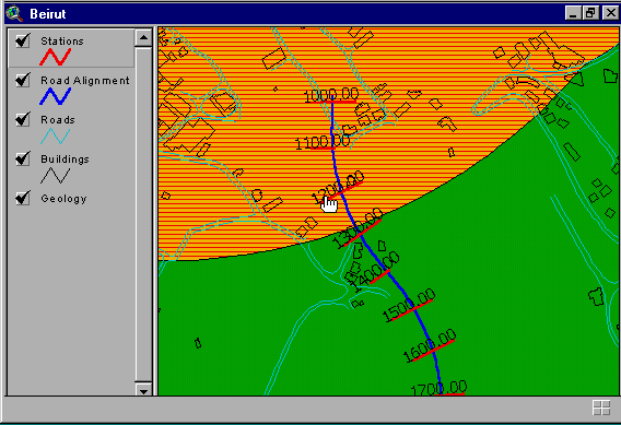

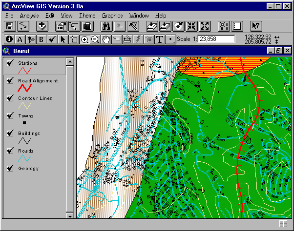

GIS advantages mostly show in this step of the road design, since the view combines most of the data needed in the decision making process (Figure 4). This function guides the user in defining a horizontal alignment, and then performs a spatial analysis to identify the underlying geology and soil formations.
Figure 4
The structure of this function is somehow complex because it requires extensive user interaction. In order to provide a robust application, this function is designed to expect any "unusual" response and deal with it, without abruptly terminating the application.
The first part of this function -defining the road alignment- is completely embedded in ArcView. A spatial intersection necessary to identify the underlying geology formations is performed, transparent to the user, using the PC ARC/INFO capabilities (Figure 5).

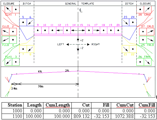

Using the customized interface, the user defines the desired geometric design criteria: template (Figure 6), horizontal curves, and vertical alignment. A sample quantities report generated is shown in Figure 6.

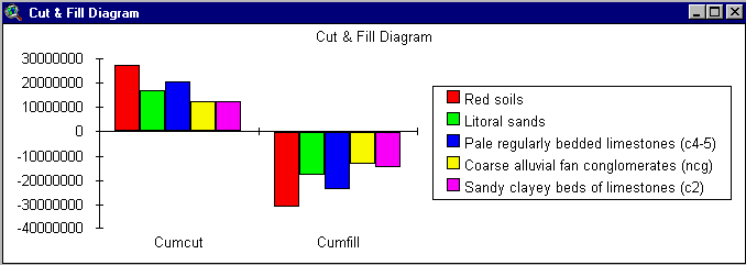

The aim of this function is to qualitatively interpret the technical data produced by AutoCIVIL, thus giving a new sense to the earthwork quantitative reports. This function translates the cut and fill reports (text file) in tabular dbf format readable in ArcView, interprets these reports by spatially combining them with the underlying geology, and finally creates a graphical representation of the results (Figure 7).

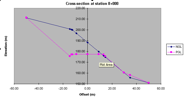

4.4 "Plot Cross-Sections" Function
The power of this function lies in its friendly environment: the user points to a station on the view (Figure 8), and its cross-section chart will be plotted (Figure 9).
This is a somehow complex process, since the Natural and Proposed Ground Elevation (NGL and PGL) generated by AutoCIVIL are not only in text format, but they are not "compatible". Combining these two files into one table requires a linear interpolation since the offset values do not match.

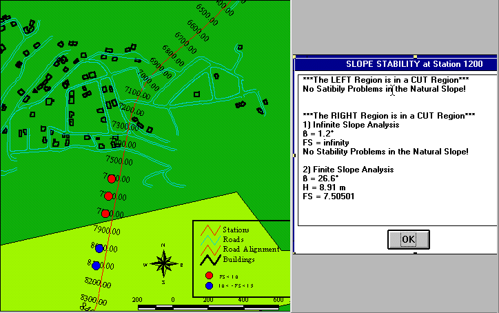

4.5 "Slope Stability Analysis" Function
This function checks the stability of the slopes of excavations and embankments induced by the cut and fill process. It loops over the left and right side of each station, identifies and calculates the different parameters involved in calculating the Factor of Safety: angle of excavation/embankment, height of excavation/embankment, underlying soil parameters, etc.
Different stability cases are considered in calculating the Factor of Safety, and the real complexity of this function is to determine which stability case to apply, and where. Relating cross-sectional elevations to underlying properties of the geology strata, cases are identified, critical Factors of Safety are highlighted on the view (Figure 10), and a stability report is generated. A typical slope stability report generated at each station is also shown in Figure 10.

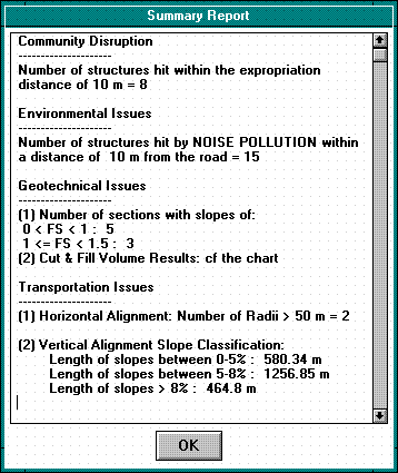

4.7 "Report" Menu
All functions within the "Report" Menu are completely embedded within ArcView and combine standard ArcView functionalities. Once the analysis is performed, all the data necessary for the running of these functions are already in ArcView format. At this stage, environmental, geotechnical and geometry assessments are only statistics! Using ArcView spatial analysis, assessments are performed and reported (Figure 11).
