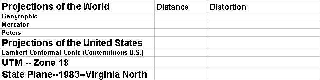

In this exercise the distortion of distance and shape will be shown using a graphic circle and the distance between New York and Los Angeles. The actual distance between New York and Los Angeles is 2,451 miles.
    DIRECTIONS:
  1. Open the ArcView Project titled Distort.apr
  2. From the View Properties read the Map Units and Distance Units
  3. Change the Projections
  4. Record the Distance
  5. Write a brief description of the distortion
