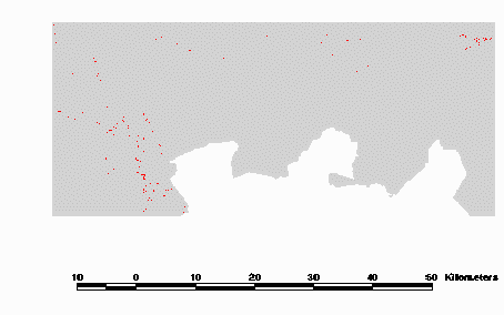

Study area

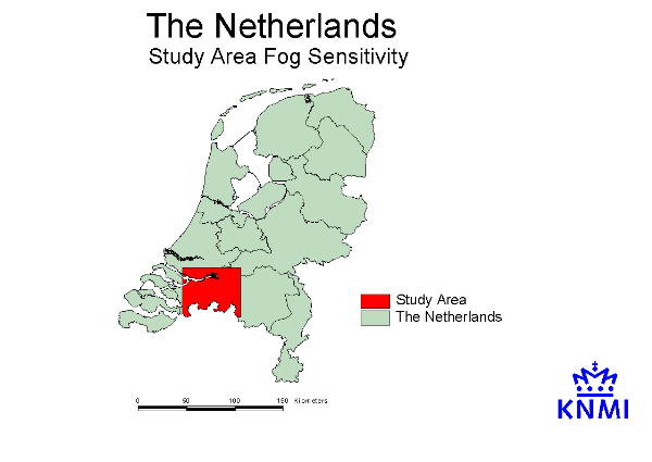

The area on which the case study is focused is part of the province of North-Brabant (figure 1). A closer look is taken at the surroundings of Breda, because of a serious and tragic accident in 1990, as a direct consequence of treacherous fog reducing visibility values dramatically. Since then, visibility sensors have been installed along that particular road section thus providing valuable reference data for the case study.
Figure 1: Location of the study area.

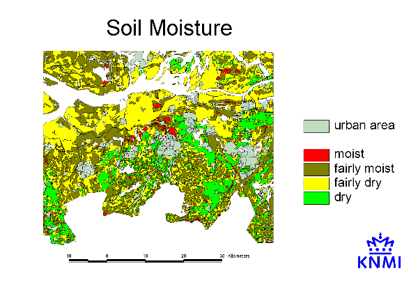

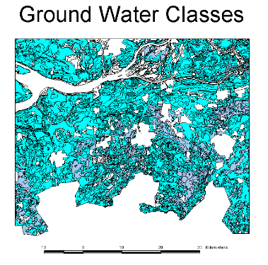

Originally, soil type is taken as a measure for the amount of moisture that is present near the surface. As stated previously, soil type is important as it is related to the humidity of the surface and the capacity of that surface to radiate heat - and thus contributes to the prerequisites for the development of radiation fog. In this study, however, soil type is only indirectly applied - here more objective ground water levels (as indicated on the soil map of the Netherlands 1:50000) are choosen as a starting point (see figure 3). Table 1 shows the classification of ground water levels that has been adopted during the study. Four soil moisture classes have been discerned, after discussions with meteorologists of KNMI.

Table 1: Translation of ground water levels into soil moisture classes.
Figure 3: Ground water levels derived from the soil map ((c) DLO-Staring Centrum). Light shades of blue represent dry area, darker blues correspond with moist regions (white areas are not considered).
In theory, the class values can be inserted in a formula with which permillage fog is derived, that is, the permillage of time that is characterized by a visibility of less than 200 meters (dense fog) :
permillage fog = 7.0 + 3.0 * D
The above formula is the result of a regression (Wessels, 1993), based on visibility measurements recorded by fog detectors along the A-16, a highway intersecting the study area. The fog sensitivity map resulting from the soil moisture method is not converted to these quantitative classes, however, because it is felt that more statistical material (prolonged visibility measurements along highway sections) are needed for a reliable estimation. Moreover, the soil mositure classes which are applied in the regression are based on soil types, not on ground water levels as is the case in the present case study! The soil moisture map as derived from the ground water level map is shown in figure 4.
Figure 4: Soil moisture map interpreted from the ground water level map.

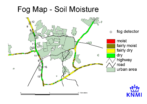

The resulting map is shown in figure 5. Some topography is added for reasons of orientation. The highways are shown in a colour that corresponds with a moisture class that is representative for the direct surroundings of these roads. Moist spots are noticed there where the highways cross meadow-land whereas dry sections are identified near the dry sandy grounds. The general impression of the map complies with the existing ideas based on extended field-work. As a reference (but given the limitations mentioned earlier) a number of mean annual fog detector observations are provided (as a promille). It becomes clear that in the open area northward and southward of the city of Breda, higher values are more likely to occur. But again, it is hardly possibly to draw any conclusions from these data! At the same time it is admitted that there are probably more criteria to reckon with in order to obtain a more reliable image. Consider for example the proximity of factories emitting large quantities of water vapour or the presence of a pine forest that more or less dissolves the patches of fog!
Figure 5: Fog Sensitivity map based on soil moisture. Detailed map showing the city of Breda.

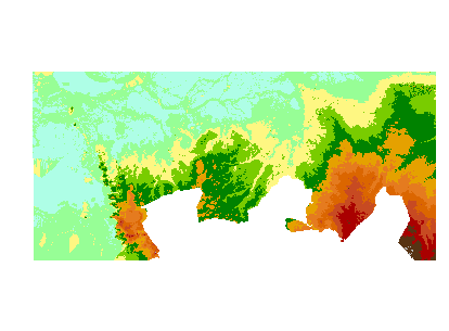

Figures 6 to 11 give an visual impression of the predictors. As can be seen from figure 7, the influence of the terrain is negligible - at least when using height data at the considered resolution! Only the red spots would contribute to the susceptibility for radiation fog, and they are at a considerable distance of highways.The height map (figure 6) is obtained from interpolating point data to a 50 meter grid (using ArcInfo, thereby reducing CPU time considerably), but more detailed data would possibly reveal interesting micro-rellief.
Figure 6: Height map of the study area (50 m resolution); heights range from light blue (-3 m) to dark brown (+30 m). Source original point data: (c) Survey Department (RWS-MD).
Figure 7: The predictor Tp indicates that slope angle and curvature are only playing a minor role given the resolution of the height data. Source original data: (c) Survey Department (RWS-MD).

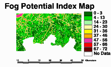

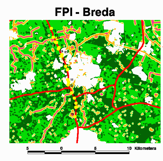

The resulting FPI-map, summarizing all three predictors (remember that the road topography could not be evaluated, unfortunately) and weighing all contributions according to the earlier mentioned weights, shows a pattern that reveals a high correlation with the "water map" (figure 10).
Figure 10: The resulting FPI map, summarizing 3 predictors.
Figure 11 provides a detailed view, zooming in on the city of Breda - the colour scale is the same as in figure 10. Here, again, the fog detector locations are inserted together with mean annual values (as a permillage). The pattern of brooks (moist) corresponds with high FPI values and therefore a high susceptibility to thick radiation fog.
Figure 11: Detail of the above FPI map, centred around the city of Breda.
