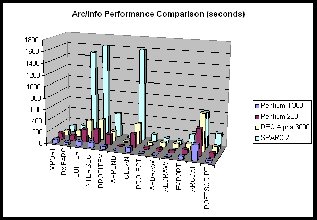

The Processes Tested
Test #1: IMPORT- converts the contours.e00 to a coverage
Test #2: DXFARC - converts the lakes.dxf and streams.dxf to coverages
Test #3: BUFFER - creates 100 metre stream buffers
Test #4: INTERSECT - intersects the stream buffers with the geology coverage
Test #5: DROPITEM - performs 52 dropitems from the geology coverage
Test #6: APPEND - appends the geology coverage with the stream buffers
Test #7: CLEAN - cleans the appended coverage
Test #8: PROJECT - projects the contours coverage from UTM into Transverse Mercator
Test #9: ArcPlot Drawing - draws all coverages in Arcplot
Test #10: ArcEdit Drawing - draws all coverages in ArcEdit
Test #11: EXPORT - converts the appended coverage to E00
Test #12: ARCDXF - converts the contours coverage to DXF format
Test #13: POSTSCRIPT - converts an ArcInfo Graphic file (.gra) to PostScript

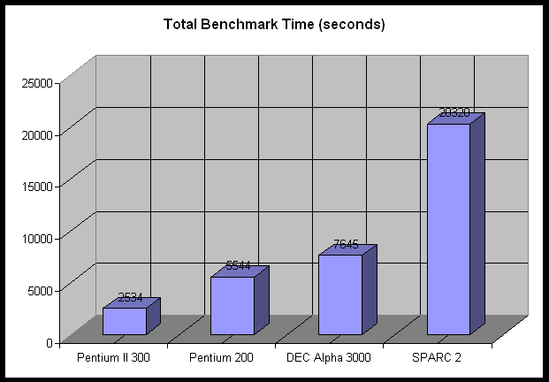

The Methodology
The process times were calculated using the [date -time] function to store the process start and end times. The times were converted to seconds and the process start time was subtracted from the process end time. The average time was stored in the time.dat file as well as the total time and the date the benchmark was run. Persons participating in the benchmark were asked to answer a number of questions in the data.dat file relating to the type of system that they performed the benchmark on.
Participants were encouraged to run this benchmark on ArcInfo servers only. Running the benchmark on xterminals will not yield true results of a computer processor. Participants were also encouraged to run this benchmark at a time when there are no others system processes running; thereby ensuring that other programs do not slow down the ArcInfo benchmark.
The Results
Due to time constraints, the sample number for this survey was not large at the time of publishing. By July 1998, the time of the 1998 Esri Users Conference, the data should have grown significantly. Please visit the benchmark web site to review the more advanced findings or to take part in the survey of ArcInfo performance.
It is interesting to note that while the DEC Alpha 3000was slower than the Pentium 200 on most tests, it generally scored better on the import and dropitem tests.
The Sparc 2 had largely similar performance to the DEC Alpha 3000, but performed significantly worse on the buffer, intersect and clean tests, all processes concerned with topology.
