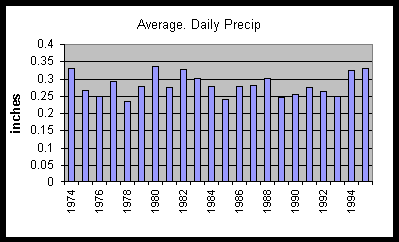

Monthly water quality grab samples have been taken by Water Environment Services (WES is the agency responsible for surface water management in northern Clackamas county) since September of 1994. The elements sampled include temperature, TKN, E-coli, BOD, Phosphates, Ammonia, Nitrates, oil and grease and several heavy metals including: Zinc, Cadmium, Copper and Lead. To date, these data have not been analyzed in-depth; however, preliminary analysis indicates that a trend toward higher concentrations of several pollutants does exist. The findings of a recent Oregon Department of Fish and Wildlife survey of the creek reported an absence of aquatic habitat diversity, and a general lack of macroinvertebrate species in the creek.

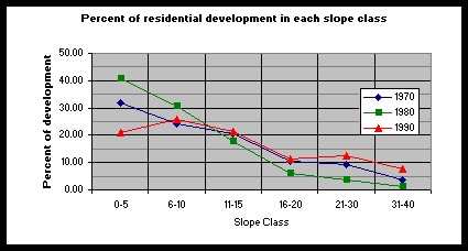

Development on steep slopes
A time-trend analysis indicates that as the watershed moves closer to full built-out conditions, more residential development is taking place on steeper slopes (Figure 4). Where residential development has already taken place in the steeper sections of the watershed, an elaborate network of French drains, detention pipes and retaining walls have been built in order to effectively deal with the amount of surface and sub-surface drainage taking place. These neighborhoods are characterized by large homes on small lots with very little pervious surface area remaining.
