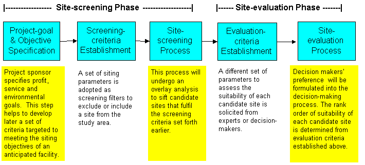

  1. Site-screening phase that identifies a small number of candidate sites from a broad geographic area and range of factors; and
  2. Site-evaluation phase that examines each candidate sites in depth in search of an optimum site.
It was also found that siting procedures, in a computerized setting, mostly employed GIS in phase 1 to screen a list of suitable sites (USGS, 1996; Murata, 1996; Cargin and Dewyer, 1996). Likewise, multi-criteria decisions making (MCDM) and related decision methods were employed to discriminate an optimum site in phase 2. This general practice is justified by the fact that GISs provide a feasible means of managing spatial databases while MCDMs furnish capabilities to soliciting values, preferences and risk attitudes from decision-makers to launch a more objective decision (Sarin, 1980; Mills, 1989; Aubert, 1986). The integration of GIS and MCDM has been an active research area in facilities siting exercises (Janssen and Rietveld, 1990; Pereira & Duckstein, 1993; Jankowski & Richard, 1994). However, these studies concentrate largely on the technical aspects of the integration; tend to overlook the modeling process that guide the users in their choices of criteria for selecting a site, nor give advises for the course of action in the searching process (Fischer & Nijkamp, 1992; Goodchild, 1991; Openshaw, 1990). A site-selection model is proposed here to integrate the two methodologies and also provide a systematic guidance to run the siting process.

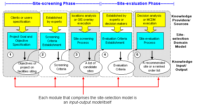

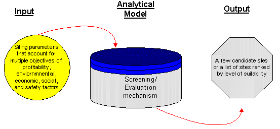

The two phases, namely, the site-screening and site-evaluation, can be seen as two independent input-output models (Figure 3). The input-output model is an open system that commands a defined set of data in a fixed input and output format. The inputs to both the site-screening and site-evaluation model are those siting criteria that are used to measure the suitability of an ideal site. The system itself undergoes a series of actions such as the overlay analysis for a series of screening-models and the MCDM process for supporting siting decision, that would eventually generate one or several site alternatives as the output(s). The input parameters, dictated by different scenarios of siting objectives and conditions, would lead to a dissimilar set of output locations. Proper operation of the model, therefore, hinges on a thorough and factual establishment of the goal and objectives of the siting project on the outset.
Figure 3 An input-output model for facilities siting
Goal, objectives, criteria and corresponding siting processes all lock in a closely related process forming the site-selection model. The formulation of goals (towards which efforts and resources are directed) and objectives (the more precise and measurable steps needed to achieve the goals) are translated into inexact criteria that correspond to existing or acquirable map data. The set of criteria would then be used as inputs to fuel up the two siting procedures (namely, the site-screening and the site-evaluation) to generate solutions that satisfy stated goals and objectives. In this regard, the author envisages that the site-selection process is a model of five clearly identifiable modules as illustrated in Figure 4.
Figure 4 Schematic representation of a site-selection model for facilities siting
Each stage of the site-selection process is an independent module itself commending a fixed set of input and output knowledge. Incidentally, the knowledge input of one module is the knowledge output of the preceding module. The site-selection model is able to support three types of functions: 1) The model represents as a framework to secure essential steps in undertaking the siting task. 2) The site-selection model entails a knowledge acquisition (KA) paradigm that enables the landuse planners to follow to develop their knowledge into the system. The elicited knowledge can be retained in the system for further justification or for consultation when retrieval. Along the same line, 3) novice users could also follow the same terms and relationship to obtain the required knowledge as the reference to their own siting problems. Figure 5 and the subsequent paragraph would illustrate how these five modules carry out these functions with the emphasis on the input and output knowledge of the model.
Figure 5 The diagram illustrates the input-output relationship of each module of the model.
  1. Project developers (i.e. clients and users) specify their project objectives in the Project-goal & Objective Specification stage. Output from this module would be the project goal (e.g., locating a coal-fired power plant that can satisfy demand in region X) and a list of siting objectives pertaining to the profit, service goals, socio-economic, economic, and the environmental concerns.
  2. Experts of the field would draw up a list of criteria in the Screening-criteria Establishment to select sites that satisfy the stated objectives. These criteria, called here as screening criteria, define a required level of achievement that each eligible site must be achieved. Each screening criterion consists of an attribute and a cutoff level that divide areas into those which are acceptable and those which are not (Keeney, 1980). For instance, a nuclear power plant requires water for cooling, sites more than 10 miles from their source of cooling water are not considered. These criteria when put in a GIS environment would be translated into the more tangible forms of map layer subjected to an overlay analysis.
  3. The Site-screening Process would involve GIS overlay analysis to sift eligible sites from a larger study area. Other location analysis (location-allocation model) would also help to identify feasible sites from a broad geographic area. Output of this module would be a number of candidate sites for further assessment.
  4. The experts and/or decision-makers would then formulate some standards, namely, the evaluation criteria to assess the suitability of the candidate sites in the Evaluation-criteria Establishment stage. These evaluation criteria, instead of eliminating areas from consideration, allow candidate areas to be evaluated relative to each other. Unlike the screening criteria that need a cutoff, evaluation criteria usually furnish with an objective measure to which and to what level the perspective facility will achieve. For instance, when evaluating the safety of a nuclear plant, its distance from the populated area would be used as proxy to measure the safety (Keeney, 1980, Schaenmann & Muller, 1974).
  5. Decision-makers’ preferences of the criteria and their attitude towards the facility (e.g. risk attitude, equity and trade-off values) would be formulated into the decision-making process. The Site-evaluation Process would employ MCDM or other decision methods to calculate the expected utility of each candidate site. The output of this module would either be a recommended site or a list of sites ordered by their level of suitability.

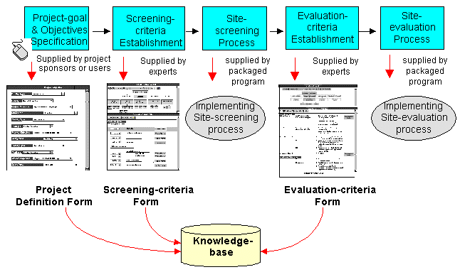

The site-selection model on the whole represents a conceptual model that brings the users and the system into interaction. However, it is only a structural and functional definition of the process itself. It is rather skeletal in nature and does not infer any concrete (or operation) knowledge to fuel up the site-selection process. This implies that the model needs to be instantiated. The instantiation of the knowledge will rely on some tools to interface more precise and ‘operational’ knowledge from recognized sources and field experts. These tools or interfaces, called here as KA tools, allows the site-selection model to run routine tasks while acquiring more refined knowledge for individual cases.
The main KA tools interfacing to the domain model is a form-filling scheme which emulates a "paper and pen" environment, in which the planner enters strings and numbers into fixed fields on the screen and selects primitives from option boxes. Form-based interface is an intuitive method to leverage large amount of knowledge (Gruber & Cohen, 1988; Musen et al., 1987; Sinclair, 1990), as the user can simply uses the mouse or cursor to move between fields and modify data as he wishes. The site-selection model serves as a graphic menu that enables users to pass easily between the modeling environment to the form-based environment in furnishing details. Knowledge solicited from these declarative forms will be stored as an individual case and collected in a centralized database. Figure 6 shows how the site-selection model interfaces to different declarative forms. There are totally three types of declarative plans: The Project Definition form extended from the module of Project-goal & Objectives Specification, the Screening-criteria Form from the module of the Screening-criteria Establishment and the Evaluation-criteria Form from the module of Evaluation-criteria Establishment. These forms are further discussed below.
Figure 6 The site-selection domain model allows the user to pass easily between the modeling environment and the forms-based part of the system. By using the mouse, the user can invoke an appropriate form to instantiate the required details there. Three types of form are specified here: Project Definition Form, Screening-criteria Form and Evaluation criteria form.
Project Definition Plan is mainly for the landuse planners or the project sponsors to define the goal and objectives of their project. The role of this form resembles the conventional Project Definition Plan, which is generally adopted in many facilities planning (William & Messa, 1983). Such a plan provides information on the characteristics of the facility like the facility type, the size, the capacity, the service scope and the siting requirement (Minnesota Environmental Quality Council, 1978). It serves as a blue print for the later development of the proposed facility.

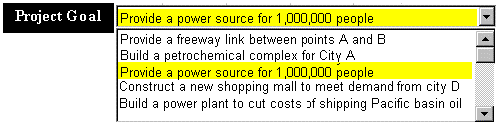

This form-filling interface corresponds to a "filling-the-banks" interface. The left part prompts the user's answer on the right part. The entry is often assisted by dropdown list so the user does not require creating answers from the void. If his desirable answer is beyond the fixed list of items, he can often pick up the closet option and modify the content but keep the syntax of the primitive.  As illustrated in Figure 7, the user selects the project goal from a list of given options.
Figure 7 The input in the Project definition form is often assisted by dropdown options forming a list of primitives
Screening Criteria Form

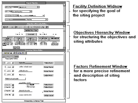

In the Screening-criteria Form, planners are asked to formulate a set of screening criteria in defining the suitability of eligible sites. The criteria form attempts to find a reliable model to establish the multiple, related objectives and criteria in a model that landuse planners will use. Hereby a hierarchy structure is used to organize a random or sequential list of siting criteria in a hierarchy on the outset and then match these criteria to existing or acquirable map data. The intent of this approach is accomplished by three viewing Windows (Figure 8) in the screening-criteria form:
Figure 8 The Screening-criteria Form combines three viewing windows: the project definition, the Objective Hierarchy and the Factors Refinement.
