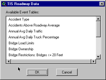

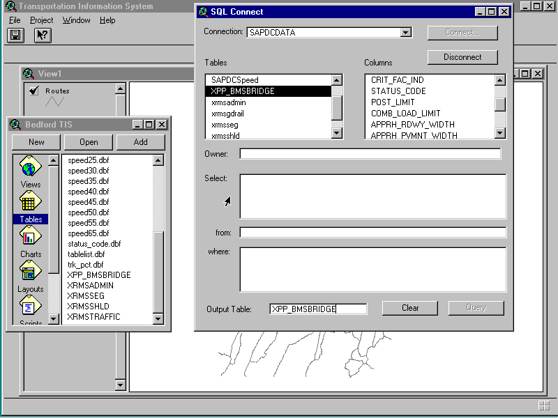

Much of the TIS data comes from PennDOT's GIS operations. PennDOT uses Intergraph GIS products, and data exchange procedures were developed for the translation and update of data from the Department to the TIS agencies. PennDOT maintains a Linear Referencing System (LRS) on the road centerline file in MGE, and the roadway, bridge, and project management system data is maintained in Oracle databases. The Department uses GeoMedia to supply data for use within ArcView. PennDOT supplies a road centerline file for each County, with the Department's LRS attached as attributes. ArcInfo is used to create an LRS route system for use in the TIS. GeoMedia is also used to create a Microsoft Access database containing tables corresponding to the Oracle tables. An ODBC driver is used to read the Access tables, and SQL Connect is used within ArcView to establish connections. The following figure shows some of details of the PennDOT data.

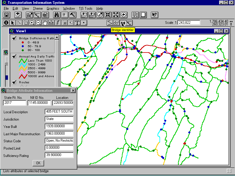

A Bridge Identifier tool was developed to allow users to click on a bridge location and see information such as bridge condition in a form. These dialogs include the PennDOT LRS information so that the planners can communicate with PennDOT staff about these projects and they can both work from a common locator.
Bridges

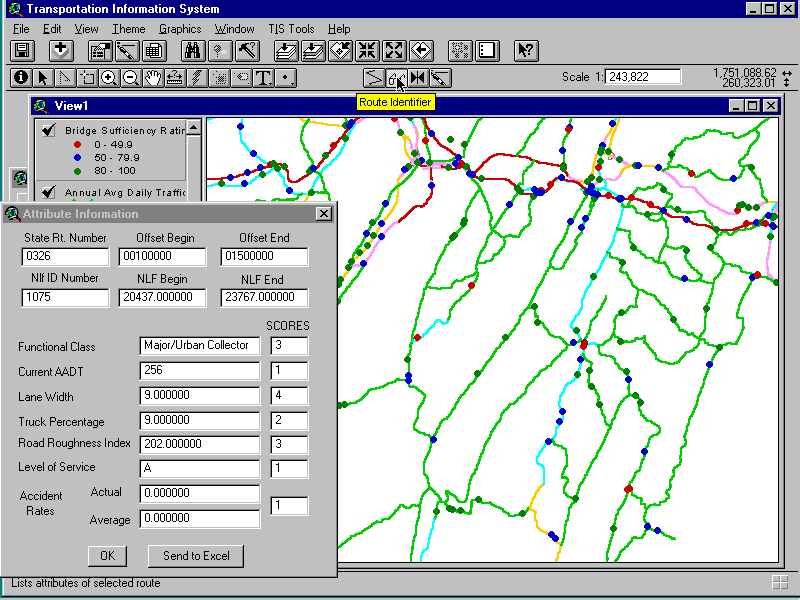

A Route Identifier tool was developed to allow users to click on a roadway and see information such as Level of Service in a form. The scores shown in the dialog form are calculated in the TIS according to criteria developed by the planners for each characteristic. The scores range from 1 to 5, where a 1 generally indicates a positive condition (e.g. wide lanes or low truck traffic) and a 5 indicates a characteristic of concern (e.g. high traffic or rough road). The scores for functional class range from a 1 for local roads to a 5 for Interstates. These scores are passed through a DDE connection to a Microsoft Excel worksheet used for prioritization.
Roadways

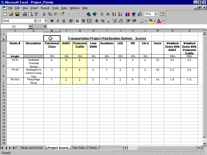

This is the Excel worksheet developed by the planners for project prioritization. This allows the planners to adjust weights for each characteristic, and to rank projects according to their impact in the area.
Worksheet
