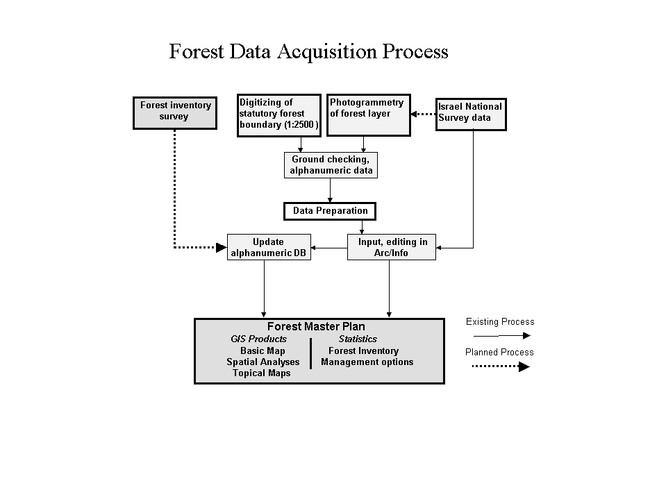

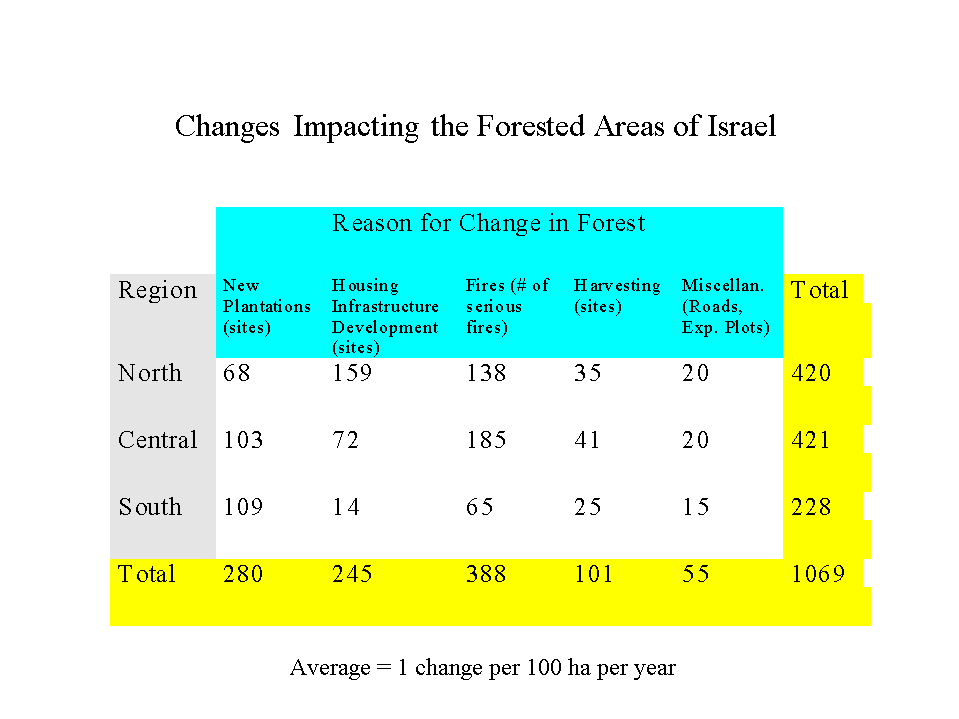

It is both natural and proper that any introduction of new technology be driven by need. In our case, the clear and pressing need was for up-to-date maps for use by our foresters and managers. Over the past two decades Israel's forests have come under increasing pressure from a growing population. In addition, there has been a severe decline of one of our main forest species due to a pest outbreak. Forest maps became out of date due to the inability of the traditional updating process to keep pace with this increasing rate of change in our forested areas (Fig. 3 Change Table). This led to a situation in which existing maps lost much of their utility.

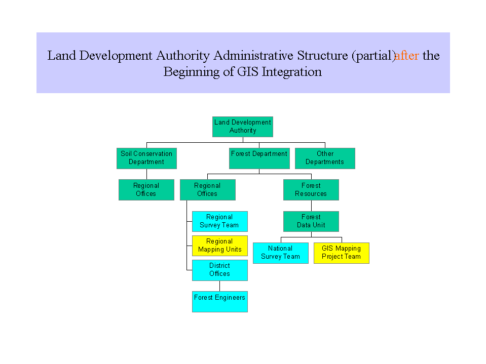

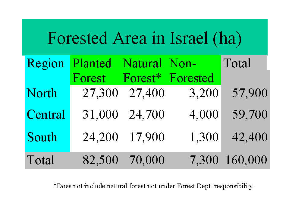

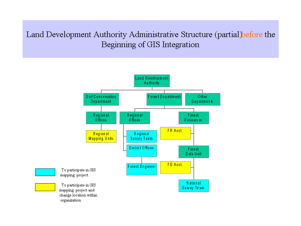

Thus the focus of the introduction of GIS into the Forest Dept. became a project to re-map all of Israel's forested areas (Fig. 4 Forest Area Table). The team chosen to carry out this project was made up of, for the most part, existing department employees with contracted support for the development of initial applications (Fig. 5 Administrative Structure After). A pilot study enabled the team to gain experience and aided managers in deciding what layers to include in the data base, in determining data standards, and in establishing standard procedures for data acquisition. In January 1996, the mapping project began in earnest (Fig. 6 Project Flow Diagram).

An early decision was to adopt the mapping standards of the National Survey of Israel, which was already engaged in a national GIS mapping project. The standards adopted related both to the accuracy (1:5000, 2-meter) and basic coding of base map features during photogrammetric analysis. For small organizations, we highly recommend this approach of "building on the work of others", despite some limitations. It speeds up some of the initial stages of the project and facilitates the data sharing between organizations. In fact, when the forest mapping project is complete, a generalization of our data will be used by the National Survey for forested regions. This is due to the high accuracy that results from our intensive field checking.
Cooperation between the mapping projects of different organizations does require a greater effort at coordination. An absolute requirement is that data acquisition and updating of each layer be the responsibility of a single organization. In principle, this is not so hard since, for example, the Forest Dept. has special interest and expertise in forested areas and thus can take national responsibility for this layer. It can also carry out more detailed mapping of forested areas for professional purposes, as long as these can be generalized into the agreed standard categorization (Fig. 7 Forest Codes).
Coordination can be more difficult since the order of priorities of an organization, as dictated by its objectives, affects the mapping process. A case in point is our road layer. In principle, this layer is under the responsibility of the National Survey, with the Forest Dept. using a generalization, since our forest maps don't need to show all the categories of highway needed on a public road map. This neat arrangement comes apart because of differences in order of priorities in two areas:
 Which areas of the country should be mapped first? The Forest Dept. has a natural tendency to give priority to more forested areas of the country, whereas the National Survey's priorities derive from other needs. Since both mapping projects are being carried out over the same period, and since forest roads are in fact the "" of the (planting sites are normally bordered by roads), the Forest Dept. realized that it must map both forest roads and those leading into the forest. The central objective here is to provide useful data as quickly as possible to users, who won't have to wait for crucial layers from an outside agency.
 How important are forest roads? As can be concluded from the foregoing, the Forest Dept. gives high significance to the accuracy and completeness of the forest road layer. This is not only emphasized to our photogrammetry contractor, the data is also checked on the ground and supplemented by GPS survey in cases where forest canopy hides the roads. For Israel's National Survey, accurately and completely mapping forest roads has low priority and the Survey does very little ground checking. Thus, even in those areas mapped first by the Survey, we must re-map the forest roads.
The case of the road layer is an exception, though an important one. Most of the other basic layers in our database are being bought from the National Survey including: topography (DTM), structures, non-forest open land, streams and water bodies, infrastructure, and various annotation layers. Other important data layers are being obtained from the appropriate organizations, such as soils from the Agricultural Ministry.

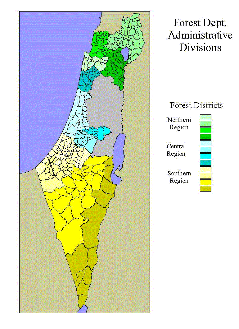

Our Forest Dept. is divided into three administrative regions (roughly parallel to National Forests in the U.S.), each of which is divided into three districts which have direct responsibility for forest management (Fig. 8 Region Map). As a compromise between the first two factors above, we decided early in the data acquisition process that database building and maintenance would be carried out by each region, whereas field checking and initiation of the updating process would be the responsibility of the districts. Our national forest database is thus split into three and located on regional servers. We thus must provide a mirror site for users in the national office (Fig. 9 Database Architecture).

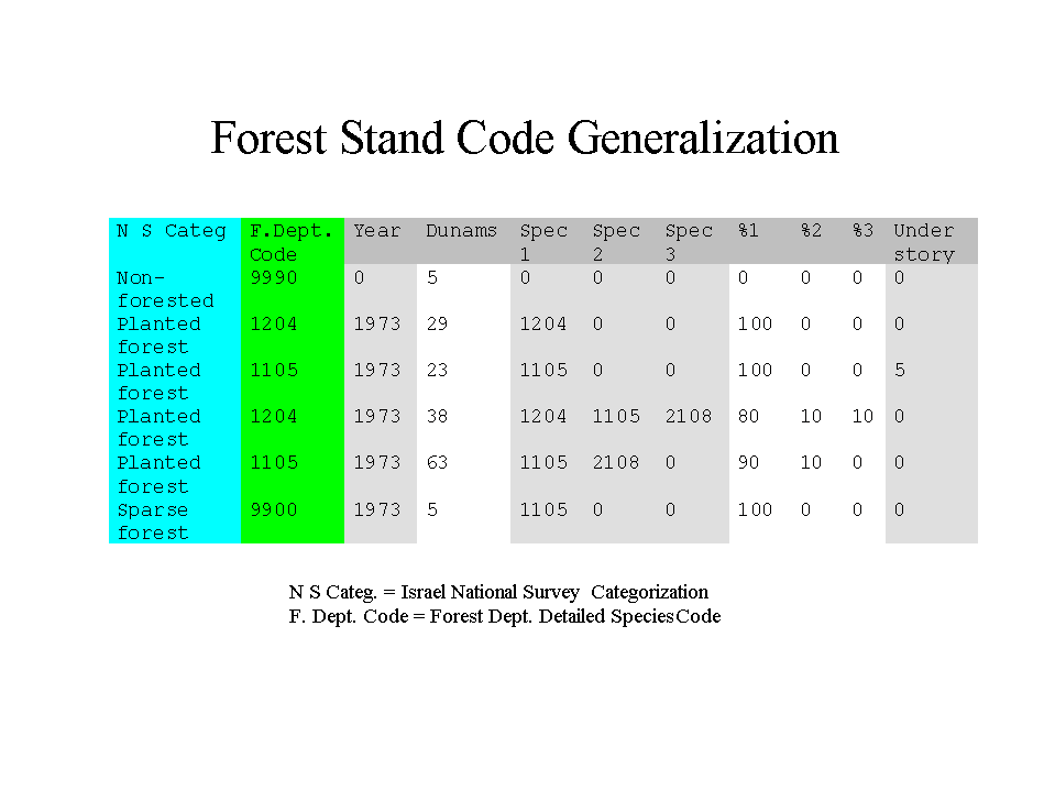

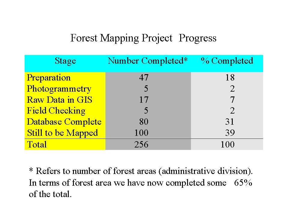

The database has been built by "forest area", administrative units dividing the whole country. At present, this division continues to be maintained in the directory structure of the database. Data acquisition should be complete within two years (Fig. 10 Progress Table). As a national organization managing "continuous" data, we must soon face the task of employing architecture and software, such as SDE, which will allow for the combination of such data into a single layer while allowing user access to a chosen "clip". It is in this task that our capacity for interdepartmental (GIS team and systems administration) cooperation will receive its critical test.

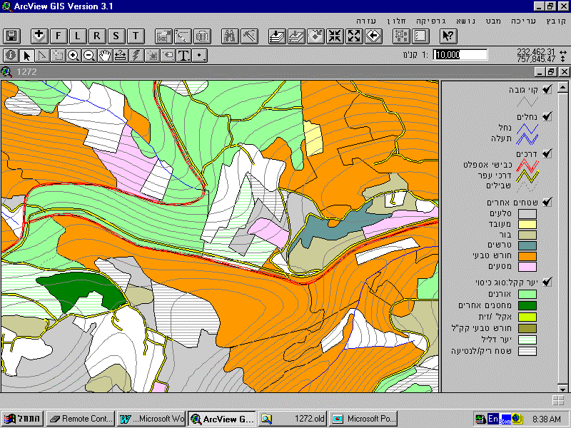

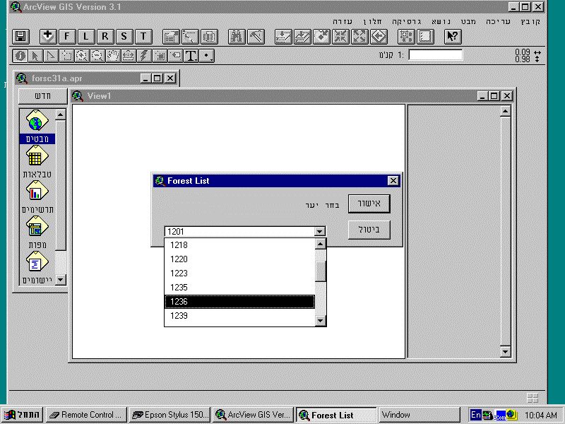

  Use of "framework" applications in Arc/View. We refer here to applications that allow easy access to data for users, but are simple enough to be produced quickly in-house (Fig.12 A/V Frame Application 1, Fig.13 A/V Frame Application 2). While not intended to produce a finished product for any pre-planned purpose, these applications provide a bridge for new users of A/V to get more immediate results at the same time as they are learning to utilize the extensive capacities of this software.

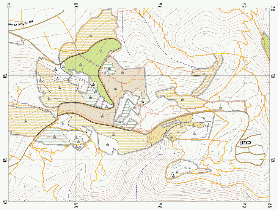

   Sensitivity to potential user requests. A great deal can come out of informal contacts with users and potential users at various levels. Such possibilities are often not couched in the form of a request, but rather may be simply a description of work underway. The example given here (Fig. 14 Segev Forest) was the result of a casual conversation between one of us and his neighbor, a forester, about the difficulties of planning the harvesting forest stands affected by severe pest damage. The result may by "trivial" relative to software capabilities, but crucial in developing understanding among users.

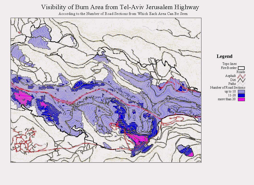

  Jumping on opportunities: We live at a time when forests are under pressure worldwide. Such "pressure" often takes the form of "disasters" (fire, pests), which can sometimes provide an opportunity to demonstrate the capacity of GIS to a wide audience. What is often required, however, is a very fast response. For a small organization, this may mean delaying the main project for a week or two and devoting all efforts to the crisis. An example from our experience concerned the largest forest fire since the founding of the Forest Dept. (ref. International Forest Fire News). The central location of the area burned (on the main Tel-Aviv Jerusalem highway), and its national historical importance led to a struggle for control over planning its rehabilitation. The Forest Department's ability to produce GIS maps of the area a week athe fire strengthened its posiregard tthe rehabilitation plan and provided a much more comprehensive basis for planning (Fig. 15 3D Map). Priority for carrying out management actions according to visibility rank from the highway provides a classic use of GIS analysis (Fig. 16 Visibility Analysis).
