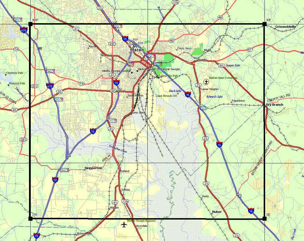

The study area is located in Macon, Georgia, about an hour’s drive southeast of Atlanta. The study area limits include the Macon East and Macon West USGS 7.5 min quadrangles, and the top third of the Warner-Robins NE and Warner Robins NW quads. The City of Macon is located on the Fall Line, the demarcation between the southeastern Coastal Plain and the higher elevations and more varied terrain of the continent’s interior.
The current Eisenhower Parkway (also known as US 80) serves as a major east-west route from I-75 on the west, through the heart of Macon, and terminates on the east side of town adjacent to the 7th Street Industrial Park. For decades, various local interests have advocated an extension of Eisenhower Parkway to link up with State Route 57 east of Macon, thereby completing a link in Georgia’s Fall Line Freeway. However, that objective is only one minor component of the stated Purpose and Need for the project, which includes the following five objectives:

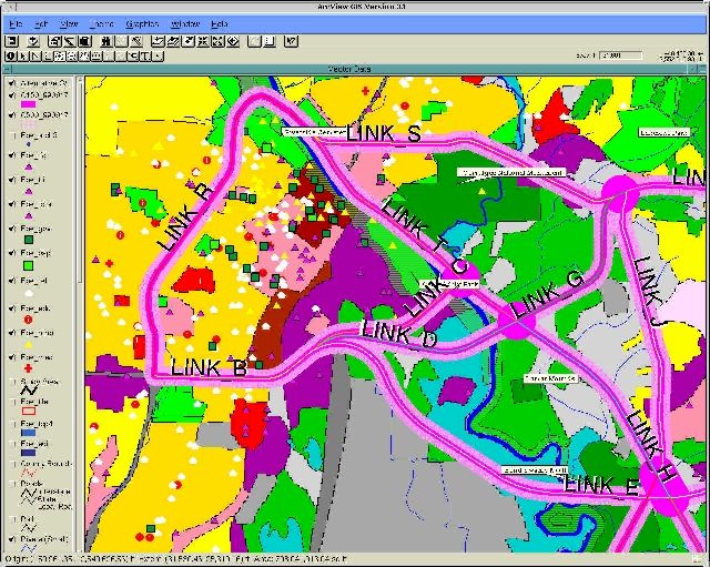

- Provide interactive ArcView GIS – Coverages used for spatial analysis and mapping with ArcInfo can be distributed to the planning and engineering staff as an ArcView GIS project to support on-site map preparation in the Atlanta office, as well as the ability to interactively view and query the GIS database during corridor and alignment identification. By bringing the ArcView GIS database to public meetings, it can also be used to support the study’s public involvement objectives.

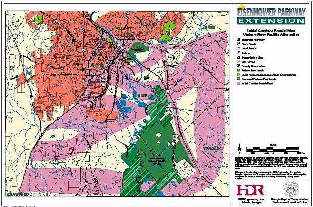

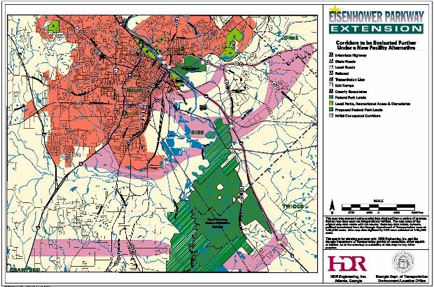

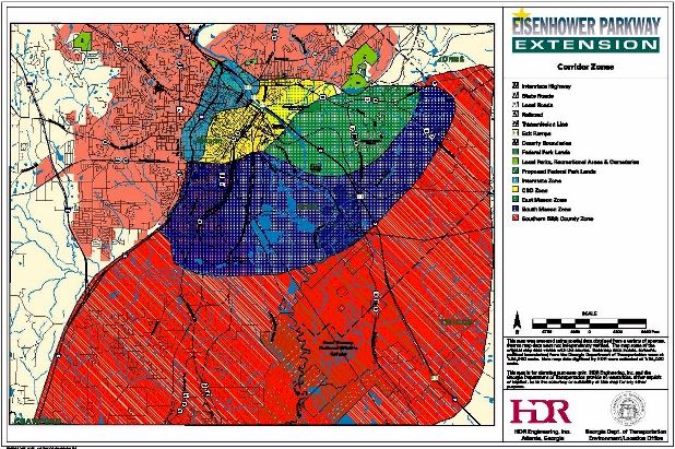

- Public Information Exhibits – GIS maps helped to illustrate the study process to the public. For example, a series of maps illustrated how the study team conducted the corridor identification process, starting with large corridor zones, followed by potential corridors within those zones, and ending with refined corridors to be evaluated further adjusted for known environmental and physical constraints.

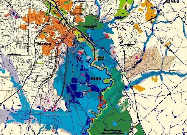

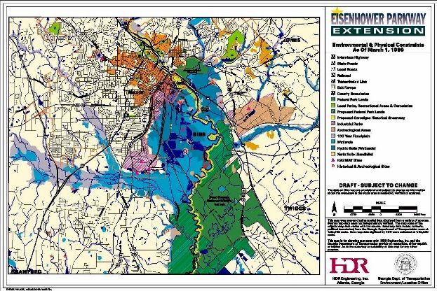

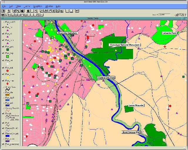

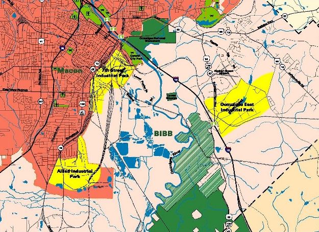

- Maps For Staff Use – The Environmental and Physical Constraints Map exemplifies the kind of GIS map which provides maximum information to engineers and planners as they consider alternative roadway locations which avoid or minimize impacts to known resources. This map combines data from many sources, including: floodplains, hydric soils, wetlands, xeric soils, historic districts, parks and conservation lands, archeological sites, and hazardous materials sites.

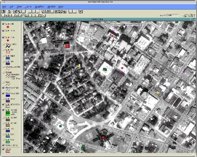

- Geocoding Community Facilities – During the initial stages of the EIS, the alternative corridors and alignments crossed a large part of the study area. Mapping the locations of community facilities such as hospitals, churches, schools, and fire stations by traditional means (i.e., sending crews into the field with maps to conduct "windshield surveys") was impractical. Instead, the HDR Team prepared a GIS tabular database of community facilities using readily available sources, such as the Internet and phonebook listings, which were used to geocode the sites to US Census TIGER street maps using ArcView. Following the ArcView geocoding, the location of each community facility point was adjusted as needed to coincide with the most probable building visible in the DOQQ imagery. This level of accuracy was sufficient for initial screening of alternative corridors; once the number of alternative alignments is reduced, field crews will verify the locations of facilities on hardcopy maps generated from the DOQQs for use in editing the community facilities coverage.

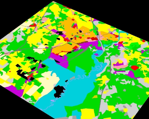

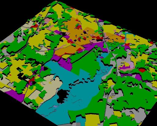

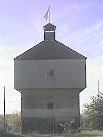

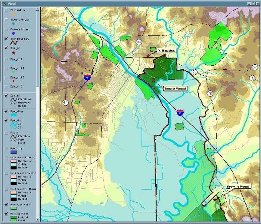

- Viewshed Analysis. To evaluate the potential impacts of the proposed project on visual aesthetics within the TCP, the HDR Team has been preparing a viewshed analysis using ArcView 3D Analyst. Three sites with prominent views of the TCP were selected for viewshed analysis: Fort Hawkins (an historic site in a Macon neighborhood), the Great Temple Mound (within the Ocmulgee National Monument), and Brown’s Mount (a natural area of high ground on the eastern edge of the TCP). The USGS Digital Elevation Model provided the relief of the ground surface, but did not account for visual obstructions such as trees and buildings. To adjust for surface obstructions, the HDR GIS staff assigned height values to the various land cover types throughout the study area. Combined with the DEM elevations, the land cover heights provide a more realistic surface for predicting intervisibility across the study area. At this writing the land cover height surface is still undergoing revisions based on photointerpretation and field reconnaissance. Nevertheless, the results of preliminary test viewsheds conform well to photographs taken from the three observer locations. For example, the preliminary viewshed analysis accurately predicted that the view to the southeast from the Great Temple Mound would be obscured by the nearby forest, whereas the buildings of Macon would be easily visible to the southwest.
- Impact Quantification. As this writing, an impact quantification screening analysis has just begun on a series of alternative roadway "links" which might be later combined to form complete end-to-end alternatives across the study area. The purpose of this analysis is to provide preliminary information on potential environmental impacts, physical constraints and construction cost factors to help the team in winnowing out infeasible or impractical corridors from further study. The links were originally digitized by the Atlanta engineering staff in AutoCAD via heads-up digitizing on DOQQ imagery. Link centerlines were exported to DXF format for import into ArcInfo. Following assignment of attributes, the link centerlines were buffered to form corridors approximating the rights-of-way associated with multi-lane roadways, to address the potential "direct" impacts of each link. The links were also buffered by 500 feet to assess what resources might encounter potential "indirect" or long-distance impacts, such as noise. By overlaying the corridors onto the various resource coverages via INTERSECT, we obtained the amount of each resource within each link.
