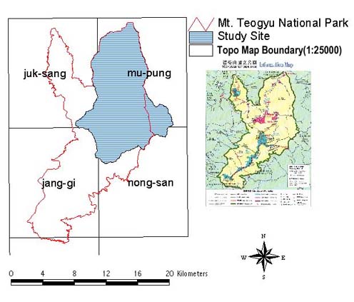

The study site is Wondang Watershed of Mt. Teogyu National Park which includes Muju Kuchon Valley, and 33 famous, historic, and fabulous scenic sites.  Mt. Teogyu National Park was designated as the 10th National Park in Korea on Feb. 1, 1975.
 Total Area of study site is 115.6 km2.  As we can see in Figure 1, Mt. Teogyu National Park boundary was not delineated along the watershed boundary.  So part of study area is not included in Mt. Teogyu National Park.  So, 10.69 km2 of outside park area is included in the study site with 104.94 km2  of park area.
Figure 1. Muju Kuchun Valley Watershed

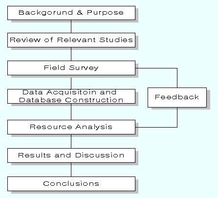

2.2. Study Procedure
Figure 2 shows the study procedure in this research.
Figire 2. Study procedure

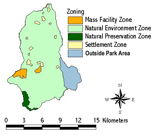

3.1. Zoning
As we can see in Table 2,  There are 96.3km2 for Natural Environment Zone(NEZ), 3.2km2 for Mass Facility Zone, 2.8km2 for Settlement Zone,  2.7km2 for Natural Preservation Zone, and 10.7km2 for Outside Park Area.  NEZ covers nine tenth of study site excluding outside park area.  Outside park has a separate zoning scheme.  Most of the development activities occur within NEZ which may cause permanent destruction once developed.  So, the present zoning does not seem to be well managed.
 Figure 3. Zoning

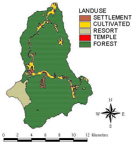

3.2. Current Landuse and Ecological Fragmentation by Pavement Roads
 To understand current landuse conditions, 30m resolution Landsat TM(115-35,1998) data were used for deriving land cover classification.  Five landuse type, settlement, cultivated, resort, temple and forest are interpreted manually after image enhancement by stretching.  As we can see in Table 3, the largest landuse type is forest whose area is 99.7km2. Then, it is followed by cultivated land with 7.1km2 , Muju resort  with 7.0km2, settlement with 1.8km2, temple with 0.02km2.  Temple and resort are easily distinguished because it is located within forest. However, the discrimination between settlement and cultivated area was not easy, so it was done by referring ground truth information.
Figure 4. Landuse

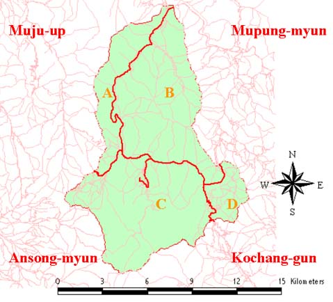

As we can see in Figure 4, and Figure 5,  Muju Kuchon valley watershed(Wondang watershed)is fragmented ecologically  by road construction due to resort development, and this  trend  tends to be worse.  The cultivated area are located along the road. Now, Kuchon valley watershed is fragmented into four pieces.  Figure 5 shows ecological fragmentation by pavement roads.  The road between C and D does not seem to be fragmented in Figure 4.  However, it was confirmed in the field survey that this road divides the area causing ecological fragmentation. The road between B and D is under construction making a serious deforestation.
Figure 5. Ecological fragmentation by pavement roads
Table 4.  Ecological fragmentation by pavement roads
Fragemented Site
Area(km2)
A
15.9
B
44.4
C
48.2
D
7.2
Total
*115.7
 * : rounding error

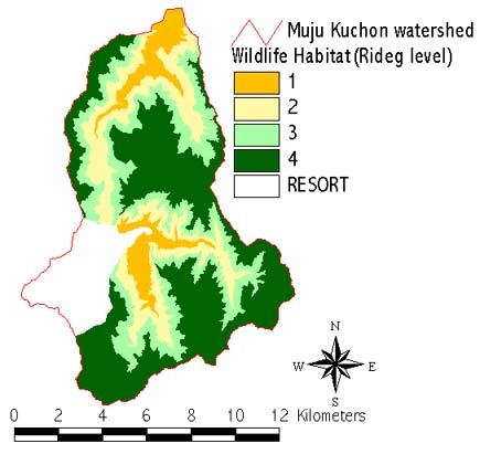

3.3 Wildlife habitat
In terms of wildlife habitat,  6 order , 15 family, 32 species of mammal are surveyed(Ministry of Domestic Affairs, 1993).  As animal treasures(natural monuments) in Korea, Lutra 1. Lutra(otter), Moschus moschiferus parvipes Hollister(musk deer), and Pteromys volans(flying squirrel) are dedicated. And Ursus sp.(bear), and Canis lupus chanco(korean gray wolf), and Panthera pardust(Korean leopard)are endangered species. Two Panthera pardus(leopard)were captured in Mt. Teogyu, but cannot be found since 1963.  Additional species, Sus scrofa coreanus Hude(Wild boar), Hydropotes inermis argyropus(Chinese water deer), Meles meles  melanogenys Allen & Andrews(badger), Nyctereutes procynoides koreansis Mori(raccoon dog), are now surviving within park area.  However, there were no habitat maps for these four species.  So, the habitat map was made based on the degree of ridge after interview of national park management officials and residents.  The ridge level is a important factor of wildlife habitat movement and habitat.  Above four mammals move along 7/10 to 8/10 ridge level.  So, above 6/10 ridge level to ridge line was delineated for protecting wildlife habitat.  10m x10m size DEM grid  cell was used in ArcView Spatial analysis for this.  As we can see in Figure 6 and Table 5, the area along around Hyangjokbong(1614m, peak), chungbong, Jibong, and Kochilbong are highly assumed to be wildlife habita.  And it covers 47.2km2(40.8%) of study site.  In wildlife habitat analysis  Muju resort area was excluded because wildlife movement corridor was fragmented by it.
Figure 6. Wildlife habitat analysis from ridge level
Table 5. Wildlife habitat analysis from ridge level
Ridge Level
Area(km2)
       ~2/10
9.6
2/10~4/10
20.7
4/10~6/10
24.4
6/10~
47.2
Muju Resort
13.6
Total
*115.5
 * : rounding error

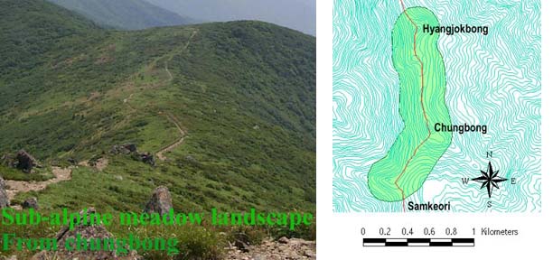

3.4. Sub-alpine meadow landscape
 The sub-alpine meadow landscape exists along ridge from Hyangjokbong to Samkeori.  There are only a few sub-alpine meadow landscapes in Korea.  So, this landscape needs to be preserved. There are unique, and diverse species of vegetation that can be seen in high mountain area.   As  herbs, Hemerocallis fulva(Day lily), Hosta longipes(Plantain lily), Sanguisorba ahkusanensis(Burnet), Bupleurum falcatum(Thoroughwax), Spergula arvensis, Peducularis resupinata(wood betony, Lousewort), Lychnis cognata(Lychnis), Gernium knuthii(Granesbill), Veratrum patulum(False hellebore), Synurus delteoides, Ligularia fischiry, and Astilbe Chinensis var. lilacina(False goatsbeard) grow(Kim et. al., 1994).  As shrubs, Lespedeza maxinowczii(Bush clover), Lespedeza bicola(Bush clover), Rhododendron schlippenbachii(Royal azalea), Symplocos chinensis(Symplolcos Family), Sasa borealis grow.  This landscape is worth preserving.  As we can see in Figure 7, sub-alpine meadow landscape map was made by creating 200m width buffer zone along the ridge line. 200m is the maximum width of sub-alpine meadow landscape from ridge line.  The hiking trail makes impacts and deteriorates the landscape because it crosses this landscape along the ridge line.  So the necessary protection should be implemented.
Figure 7. Sub-alpine meadow landscape

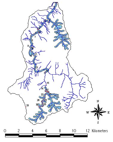

3.5. River Corridor landscape
In terms of river corridor landscape, Muju Kuchon valley which developed riffle fall, rapids, pool, and fond is in harmony with spectacular rocks.  As we can see in Figure 8, there are 33 famous scenic sites.  And excluding Hyangjokbong, Naje-tongmun, and Paikryun-temple, 30 scenic sites are distributed along the main stream.  Only Naje-tongmun, and Paikryun-temple are Historic resource, and the other are Natural resource formed by erosion of rock or rock table.
 200m width Buffer Zone is created done along the main stream in Kuchon valley watershed to preserve this landscape.  Mass Facility Zone are excluded in delineation.  13.06 km2 area of study site is included in this river corridor landscape. As we can see in Table 6, this landscape includes 31 of famous 33 Muju scenic sites.  Wolha-tahn is excluded in buffer zone because it is in Mass Facility Zone.  This landscape is partially located in developed areas, roads, and forests.
Figure 7. River Corridor landscape
Table 6. Muju 33 Scenic Resources Distribution

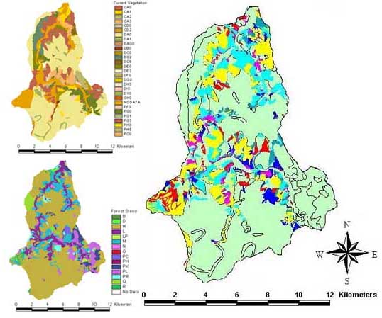

3.6. Forest landscape
 There are four types of vegetation maps in Korea.
1.Degree of Green Naturality(DGN) Map
2.Detailed Survey of DGN Map
3.Current Vegetation Map
4.Forest Stand Map
DGN map and Detailed DGN Map are not appropriate for forest landscape analysis.  The forest stand map contains information of forest stand, age, diameter of breast height(DBH), and canopy density while current vegetation map contains the structure of forest community only.  So, at first forest stand map and current vegetation map were compared.  However, the difference between Current Vegetation Map and Forest  Stand Map is  52.km2 (45.1%) of study site as we can see in Figure 9.  Additional survey and update are required to use forest stand map and current vegetation map,  Future research is needed for forest landscape analysis.

Figure 9. Difference between Current Vegetation Map and Forest  Stand Map
