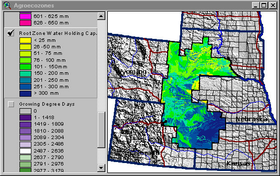

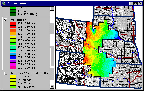

Six different soil and climatic factors were modeled across the central Great Plains landscape at the NRCS National Soil Survey Center in Lincoln, NE. Three of the modeled surfaces deal with soil properties; 1. Root Zone Water Holding Capacity (RZWHC), 2. Soil Rating for Plant Growth (SRPG), and 3. Annual Water Balance (AWB). Three climatic characteristic surface models include; 1. Precipitation (PRECIP), 2. Potential Evapotransporation (PET), and 3. Growing Degree Days (GDD). These data were considered essential in terms of agricultural cropping system analysis in the central Great Plains. The climate and soil surface models were developed using complex regression techniques from point data such as weather station and soil pits (pedons) as well as NRCS vector soils data (SSURGO and STATSGO) and nonspatial relational databases. Below are examples of the PRECIP and RZWHC surface model within the central Great Plains study region.
Precipitation Surface Model
Root Zone Water Holding Capcity Surface Model

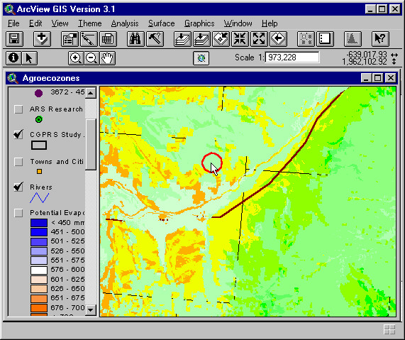

Agri-FACTs is designed to be as user friendly as possible. An accessable and easy-to-use format may make Agri-FACTS a decision support system of choice for producers across the region who are seeking useful information on alternative cropping systems. The process simply involves zooming and panning to the farm location, clicking on the Agri-FACTs button, and finally clicking on the general point location of their farm. The system then automatically collects the cell value from each surface model and creates an HTML page report that the user can then analyze and/or print.
Agri-FACTs Interface

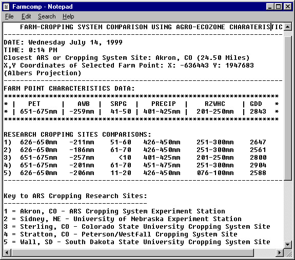

The Agri-FACTs HTML report displays the values for all six models (PET, AWB, SRPG, PRECIP, RZWHC, and GDD) for the selected farm point. The report allows the farmer to individually compare each of the soil and climatic values found at the farm location to the soil and climatic values found at each of the five research sites. The farmer can then determine which research station(s) has the most similar soil and climatic characteristics to their farm. The report contains hyperlinks to each of the experiment stations allowing the farmer to go directly to the research site's web pages and examine the cropping system research results. It is at this level that Agri-FACTs facilitates decision support regarding new cropping systems that the producer may elect to consider for his farm to replace the wheat-fallow system most commonly used. The farmer can then take this information to his extention agent or district conservationist for a more explicit analysis.
Agri-FACTs Report
