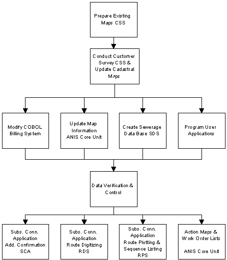

To realise the concept on the ground, several preparatory steps had to be done.
The flow chart shown below is a very simplified and compacted one. In reality each box represents a huge task by itself.

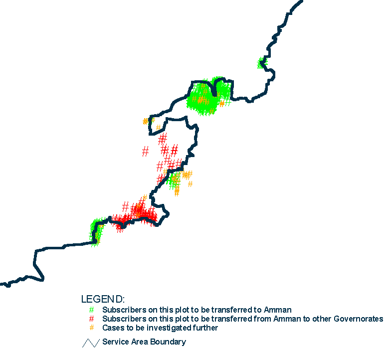

The problem of mismatching between customer collection area and water supply service area evolved from unclear service area boundaries, outdated network maps and the subjective decision concerning the point of connection between the customer house connection and the water network.
A customer could very well be within the service boundary of provider A (WAJ Governorate A), but paying the bill to provider B (WAJ Governorate B) and vice versa.
With the decision to award the Management Contract for Greater Amman Water & Waste Water services to a private operator and separate it financially from the main governmental body WAJ, the need to clean up these boundary exceptional cases became of top priority.

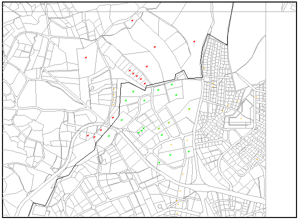

The analysis of this problem was done by linking the customer survey database (Oracle) and ArcView, classifying the customers into three categories and reflecting the results on a map (see Fig. 2):
Category A Customers managed and billed by another Governorate but residing in areas which are within the private operator jurisdiction. (Customers to be imported-Green Color)
Category B Customers managed and billed by Greater Amman Administration but residing in areas outside the private operator jurisdiction. (Customers to be exported -Red Color)
Category C Addresses which contain unclear cases to be further investigated-Light Brown Color)
The following figures show the three cases to be transferred or checked further. Aided by maps and lists, the user was able to act promptly on this valuable information and start the swapping task.
The result of this analysis was the importing of 816 customers to Amman and the exporting of 72 to other Governorates. A total of 49 customer cases are to be investigated further and cleared.
