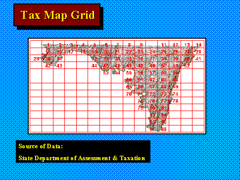

1.2 Tax Map Grid: Jurisdiction Index of Maryland State Department of Assessments and Taxation Parcel Maps (see Figure 4).

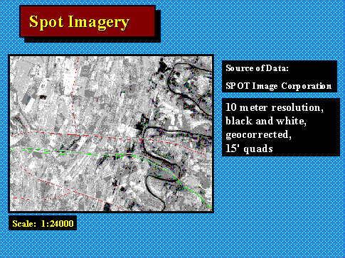

1.4 Digital Spot Satellite Imagery: Black & white, 1995 satellite images with 10-meter resolution (see Figure 6).

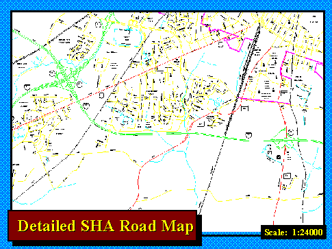

1.5 SHA Road Maps: State Highway Administration (SHA) digital 1:24000 grid maps of roads, rails, stream and boundary features for each county and Baltimore City. SHA digital grid maps conflated to the U.S. Bureau of the Census TIGEr/Line files with expanded feature names and address range information incorporated in with the street network for each jurisdiction in the State (see Figure 7 & 8).

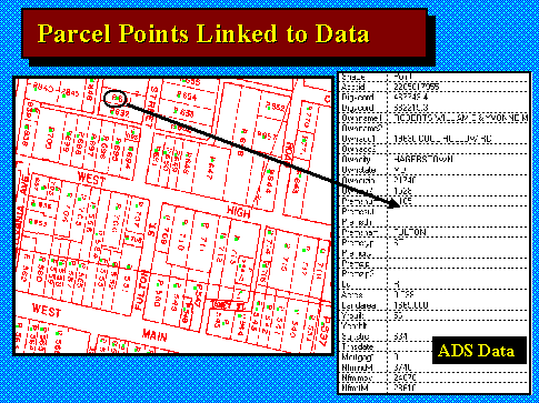

1.6 Property Maps & Ownership of Land: The State of Maryland has traditionally maintained 2,800 property maps (generally 1:7,200 scale maps with insert maps for towns at smaller scales) in the form of ink on Mylar originals. These maps were converted to digital format using scanning technology. The maps are now maintained as a hybrid of the original raster scans with vector updates for new subdivisions and property boundary changes (see Figure 9).
To make the computerized property maps intelligent, each property map was geographically aligned to the State Highway Administration's 1:24000 scale digital roads file. A x,y reference point was then located in each parcel on the property maps such that it also fell on the correct side of the digital roads file. The referenced points were linked via a unique identifier to the corresponding parcel database record for the property (see Figure 10 & 11).

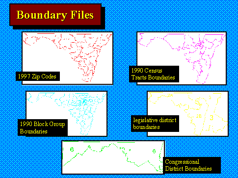

1.7 Boundary Files: Following boundary files are available as ArcView shapefiles:
Census Tracts - 1990 enhanced (1:24,000) census tract boundary files and associated 1990 census population, housing and socio-economic data from the U. S. Bureau of the Census 1990 STF1 and STF3 files.
Block Groups - 1990 enhanced (1:24,000) block group (subset of a census tract) boundary files and associated 1990 census population, housing and socio-economic data from the U. S. Bureau of the Census 1990 STF1 and STF3 files.
Political Boundaries - Congressional and State legislative district boundary files as adopted based on redistricting after the 1990 Census (boundary files are based on the 1990 Census TIGEr/Line files, 1:100,000 at best) (see Figure 12).

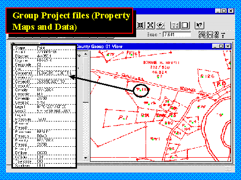

2. MdProperty View Project Files (APRs) Setup
In addition to the above sub-directories the root directory for each county data also contains ArcView project files with the .apr file extension. Each project file is an integrated collection of various property data and image layers. Following is the description of the project files:
2.1 Master project File

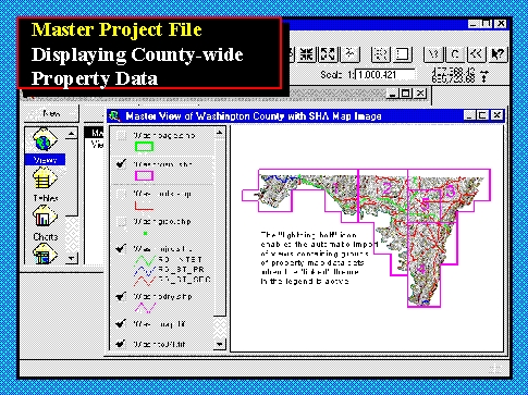

Each county CD-ROM has a master project file. This is the best place to start working with MdProperty View database. The master project file contains two views:
Master View: This view contains all of the frame of reference data sets (selection overlay, property map grid, Landsat image, SPOT images, major roads, SHA roads, and land/water boundary) for the jurisdiction. The master view also includes the jurisdiction's "gisc" file that contains all located and unlocated parcels along with key fields for locating properties countywide by account number, owner name or street address. For the first time with the 1999 Edition, the master project files will also include a seamless, composite (cataloged) image of all of the property maps for the jurisdiction which eliminates the need to access and load the individual property map images that are provided in the GROUP PROJECT FILES.
Unlocated Properties View: This view contains the detailed assessment files ("unlc") and CAMA files ("cmul") for those parcels, which could not be, located on the property maps. Since these parcels have x,y coordinates with 0, -1, or -9 values they cannot be viewed in any meaningful way on a jurisdiction map and instead can only be looked at as a table from within the view.
The selection overlay theme (the magenta colored grid) must be the "active" theme in the master view before the automatic selection of any study areas can be accomplished. When the lightening bolt (Hotlink tool) is selected, the user can move the icon to any of the numbered areas on the selection overlay. Once within the area of interest click the left mouse button. This action will automatically import property map images and the associated parcel database records (both the standard assessment database extract and the CAMA database) into another view within the master project file (see Figure 13).

2.2 Group Project Files
Each jurisdiction in MdProperty View has been divided into different study areas (groups) and each study area is saved as an individual project file. Each study area project file has one view (with property data and property maps), which is then hot linked to the master project file for the jurisdiction via the selection overlay and the lightning bolt (Hotlink) icon (see Figure 14).

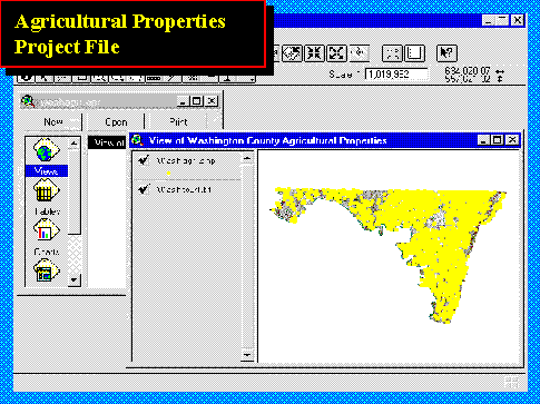

2.3 Agricultural Properties Project File
This project file contains one view. The view includes the parcel point database for all agricultural parcels and the Landsat image for the jurisdiction. The parcel point database contains records for the land use code e.g. A-Agricultural (see Figure 15).

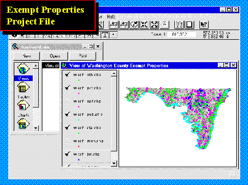

2.4 Exempt Properties Project File
This project file contains one view. The view includes the parcel point database for all exempt parcels and the Landsat image for the jurisdiction (see Figure 16).

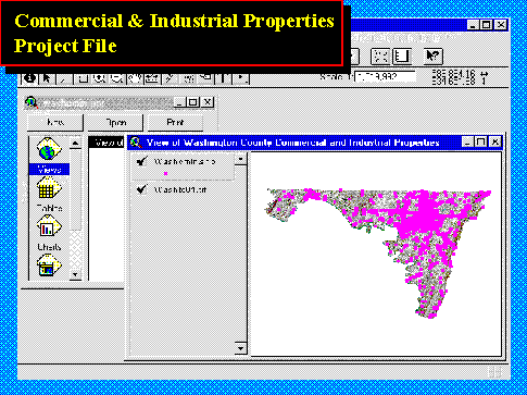

2.5 Commercial and Industrial Properties Project File
This project file contains one view. The view includes the parcel point database for all commercial and industrial parcels and the Landsat image for the jurisdiction (see Figure 17).

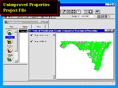

2.6 Unimproved Residential Properties Project File
This project file contains one view. The view includes the parcel point database for all unimproved residential parcels and the Landsat image for the jurisdiction (see Figure 18).

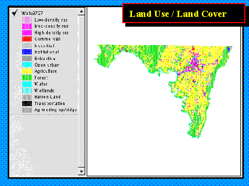

Land Use/Land Cover - 1997 classification of land use/land cover (1:63,360) for the jurisdiction based on a level 2 U.S.G.S. classification scheme. Initially developed from high altitude aerial photography and satellite imagery the urban land use categories have been further refined using parcel data from the 1997 Edition of MdProperty View (see Figure 19).

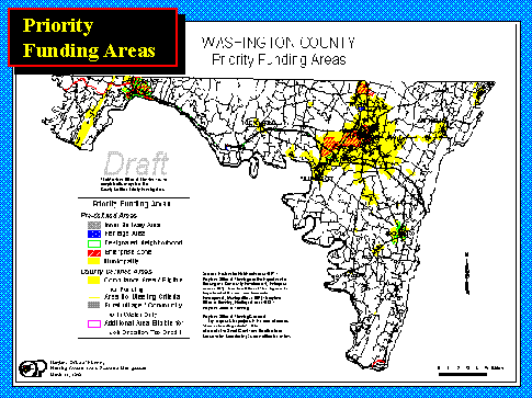

Priority Funding Areas - Current (as of production of the CD-ROM) boundaries for Priority Funding Areas as defined and developed based on the State's1997 Smart Growth legislation. Includes areas designated by each jurisdiction consistent with the criteria set forth in the legislation. Projects developed in these areas are eligible for special tax incentives and state funding (see Figure 20).

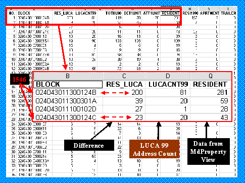

The first step in this process is to intersect the residential parcels in the MdProperty View file with 1990 census block centroids (the Bureau did not make 2000 collection block geography easily available in a digital format). The result of this intersection is a count of residential parcels from the MdProperty View (with and without improvements) by 1990 census block.
The U.S. Census Bureau, besides giving the local jurisdictions an address list file, also supplies two summary files with the total housing counts by 1990 census blocks as well as 2000 collection block geography (see Figure 22).
The Maryland Office of Planning compares its list of the number of residential parcels by 1990 block generated from MdProperty View with the Bureau's list of the number of addresses by 1990 block. A difference (MdProperty View improved residential parcel counts minus U.S. Census Bureau's address counts) is calculated for each 1990 census block, and then sorted with those blocks with the greatest difference at the top (see Figure 23).
The table in Figure 24 illustrates the results of the process just described for Washington County, Maryland. The 1990 census block 124B, in census tract 11300 had a count of 281 improved residential parcels in 1998, while the LUCA count from the Census Bureau indicates that there are only 81 addresses in this block. Thus, the MdProperty View file is indicating that there are 200 more housing units in this particular block than the U.S. Census Bureau has in its address file. (The LUCA count of 81 could also be compared with the 1990 census count of 119 for this block, another indication that the Bureau's address is short.)

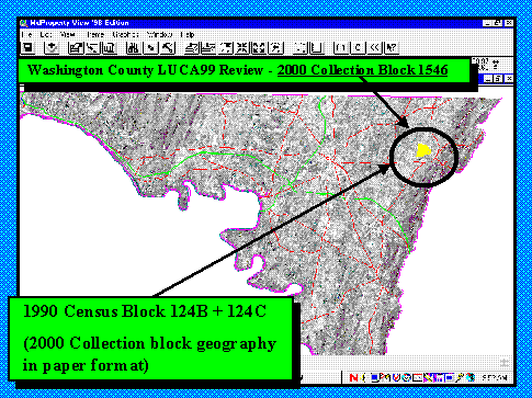

Step 2. Identify the 2000 collection block
This area, block 124B in census tract 11300, is obviously a good candidate to investigate more closely, with a strong likelihood of yielding useful results. However, as mentioned previously, the Bureau requires all corrections/additions be submitted in 2000 collection block geography, not in 1990 census block geography. In this particular case, 1990 census block 124B must be identified by its 2000 collection block. There are several ways to do this, including using the paper maps that the Bureau provides of 2000 collection blocks, and/or using the actual address list which has a 1990 and 2000 collection block assigned to every address. By using this address list, and a series of queries in ArcView (an Esri GIS software), it was determined that census block 124B is part of 2000 collection block 1546. However, through these series of queries, it was also determined that 2000 collection block 1546 also consists of 1990 census block 124C in census tract 11300. This particular block (124C) has a residential parcel count of 43, or 23 more than the 20 addresses that the Census Bureau indicates is in this block.
It can be initially concluded then, that collection block 1546, consisting of 1990 blocks 124B and 124C, needs additional 223 addresses (200 + 23) according to a comparison with MdProperty View.

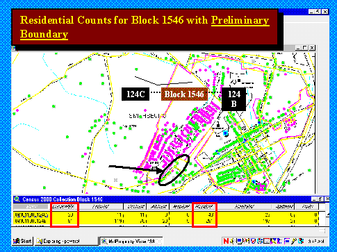

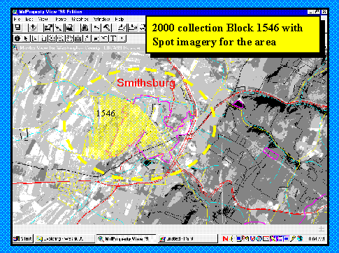

Figure 25 shows the location of 2000 collection block 1546 in Washington county, Maryland - which again is 1990 census block 124B and 124C. This is what is actually highlighted inside the circle, the Maryland Office of Planning not having 2000 collection block geography in digital format.
Figure 26 by zooming down closer to the area, the block appears to be partly in the town of Smithsburg (magenta outline).
Figure 27 by zooming in a little further, the street network begins to appear; most of which is in the town of Smithsburg.

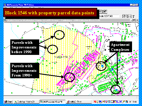

In Figure 28, the parcel points are turned on. The green dots represent improved residential parcels with improvements before 1990. The magenta dots are improved residential parcels where the improvements are from 1990 or later. It is more than likely that it is the parcels developed this decade (the magenta dots) which would be missing from the U.S. Census Bureau's address list. In the same view, note that there are two blue squares with a dot in the center. These represent apartment complexes, which are discussed later in this document.
Figure 29 shows the area once again and a table of information for this area - block 124B and 124C. Note again that there are 324 residential parcels in these two blocks (43 + 281) compared to the 101 addresses listed in the LUCA file from the Census Bureau. But also note that there are two apartment units located within these two blocks. Where MdProperty View has a weakness in this application is in distinguishing the number of apartment units within an apartment building, since the assessment file usually has only the address of the building itself. This is something that one needs to be aware of when making the comparison between the number of improved residential parcels from MdProperty View and the number of addresses in the Bureau's list. (In our work with the Bureau's LUCA file for many jurisdictions in Maryland, we have found that the Bureau also falls short in many instances in listing individual units in apartment buildings). Note also that the table in FIGURE 5 contains data from the 1990 Census. This 1990 data indicates that there are 5 mobile units within the defined area. Mobile units can also be a problem in MdProperty View, depending upon how they are put in the assessor's file. In some cases, where the pads are individually owned, the addresses are listed separately, as with any single-family residential unit. However, when the pads are all owned by one person/company, then only one address will appear.

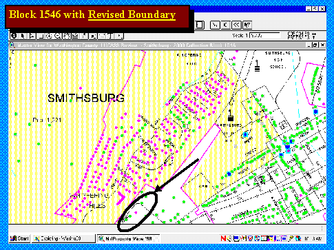

Also shown in Figure 30 are the TIGER block boundaries in yellow. One, often time-consuming step, that needs to be taken is to ensure that these block boundaries precisely match actual boundaries as noted by the street network or other relevant features, and that the parcel points are on the correct side of the TIGER line boundary. This often requires creating an ArcView shapefile, which precisely defines the actual boundary of the 2000 collection block.
In this particular case, it appears that the TIGER line boundary is a pretty good fit with the parcel boundaries and when it is redrawn, there is not much difference in the count of residential parcels contained in 2000 collection block 1546.
Figure 31 presents a summary of what has been explained so far. For 2000 collection block 1546, the LUCA count of addresses total 101, which is actually 29 less that what was reported for the area in the 1990 Census (a clue that additions will need to be made.) In the 1990 Census it was reported that there were 101 single-family homes, and 24 units in apartments. Again, it is important to make sure that the apartment units are accounted for in the LUCA address list, since MdProperty View will also most likely not have a full listing of the individual units).
When the shapefile is redrawn to better match actual boundaries there is a residential count of 314 improved parcels from MdProperty View, slightly less than the 324 residential improved parcels gotten from the preliminary block boundary intersection with the property parcels. The MdProperty View file also has a count of improved residential parcels by year of improvement. In this case, note that 190 houses were built after 1990. In all likelihood it is these units built this decade, which would most likely be missed in the LUCA address list. Note also the two apartment parcels in MdProperty View (but without a count of units in these parcels).
Summarizing the findings for the block
In concluding the analysis for 2000 collection block 1546, the Maryland Office of Planning would recommend a total residential count of 338. This total consists of the 314 single-family residential units and the 24 apartment units that were there at the time of the 1990 Census.
Figure 30 shows the refined shapefile, which produced the 314 single-family improved residential parcel count.
