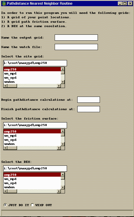

&LABEL menu
/* kicking out to the menu
&menu manypd.menu &form &position &ur &stripe 'Pathdistance Nearest Neighbor Routine'

&LABEL BEGIN
&setvar .z = %.min%
&watch %.watchfile%
