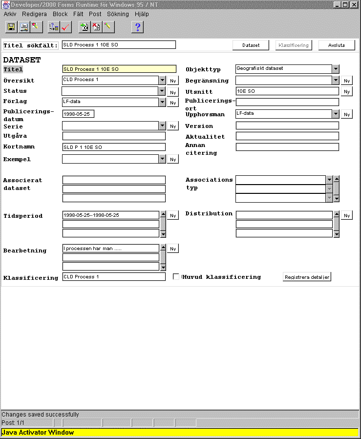

In order to register meta data, a complete JAVA-based form input has been developed. This means being able to use e.g. Netscape to edit the approx. 25 forms the input application consists of. The main groups of information that the user can register information about are:
Figure 2. Design of main form for registering meta data via the Internet

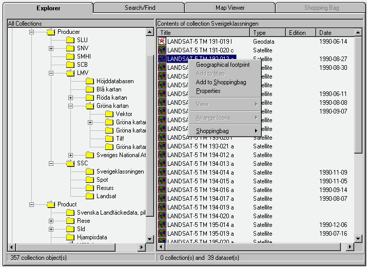

2.4.1 Explorer
Below the first tab -"Explorer" – you can see the meta data catalogue divided into collections (classifications) in a tree structure in the left frame and the data set itself in the right frame. In the Windows Explorer the classifications of libraries and geographic data sets correspond to data files.
This structure is used to organise data into a logical hierarchy suited to the user’s needs. For example, data can be organised into a producer-oriented structure in which all the producers are indicated on the highest level. Below that the products of each producer are shown. Below the product level any versions of the product are shown. This producer-oriented classification is suitable for those who know what kind of products the different producers offer. For those more thematically-oriented, a parallel, thematic classification can be offered where for example all road data sets, irrespective of their database, are classified in the same thematic group. This type of thematic or activity-based classification is suitable for organising meta data for a special group of people, for example for physical planning, a municipal public works office or the environmental office of a regional administration authority. Each group will then often have its own classification system.

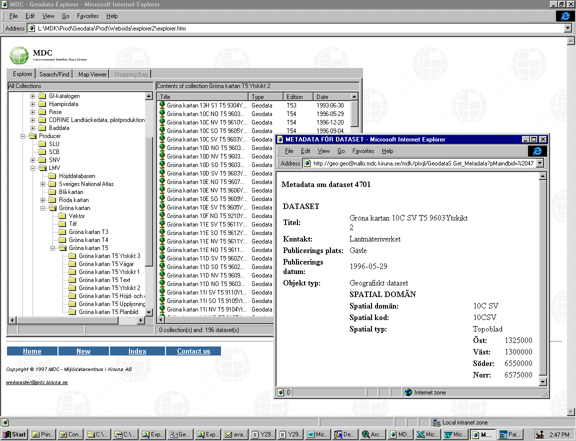

When a data set of interest has been found, it can be studied in more detail by requesting meta data about the data set, looking at a sample image or drawing the geographic section for the data set on the map.
Figure 4. If you request meta data about the data set a meta data report is generated. These come in three different variants with an overview showing the basic identification information with storage information oriented towards describing how the data is stored, plus a third variant which shows a complete abstract can of the meta-database.
Figure 5. If you choose the alternative of showing the geographic extent, then rectangles appear on the map showing the geographic scope of the data set.
When an interesting data set has been identified, it can be ordered by placing it in the "shopping bag". If the user is not interested in receiving the whole data set or if the data was originally stored in the wrong format, then the user can request "Extract data" to a customer-oriented product and thereafter place it in the shopping bag for downloading.

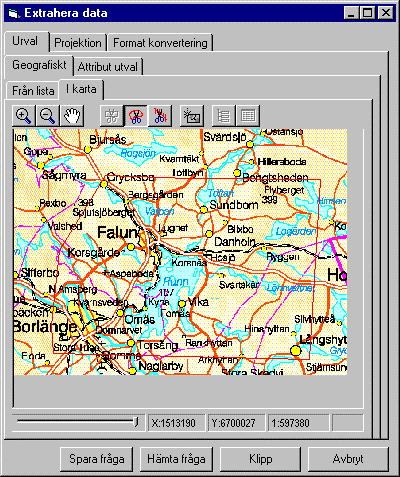

Upon choosing Extract Data, a form appears with three tabs: Selection, Projection, and Format.
2.4.1.1 Selection
This alternative allows the user to make a selection based on geographic criteria or properties stored in the data set. These properties may be e.g. road codes, vegetation classes, category codes.
2.4.1.1.1 Geographic selection
Geographic selection can be made by first choosing a type of section, e.g. administrative district or topo sheet. After that the user can select one or more sections from this list, e.g. three council districts, from which to cut data. Another alternative for making the selection is to freely define a polygon in a map for data sectioning
Figure 6. In the selection form you can make both a geographic selection and one based on the properties of the data set.
2.4.1.1.2 Attribute selection
Here the user has the possibility to choose one or more fields in the data set from which to make a selection, subsequently determining the operator, and the values from a list. The user may for example have chosen to extract data from the blue map, while only wishing to retrieve the main roads. The user then chooses to make the selection in the field for category codes, selecting the codes that include main roads.
2.4.1.2 Projecting
If a special projection is desired the user can choose from the list of projections which projection the data is to be delivered in. In the first version a number of versions of RT90 will be supported.
2.4.1.3 Format conversion
This tab allows the user to specify which format the data is to be delivered in. The formats supported at present are Esri-shape, DXF and KF85. This selection of output formats will be increased as needed.

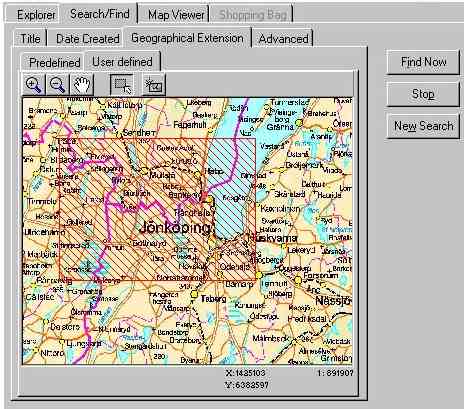

2.4.2 Search
If the user’s browsing in Explorer is unsuccessful, there is a tab with search functions incorporating search filters
The search result is shown in a list below the search window
The same menu alternatives are available as for the data set in Explorer.
Figure 7. Below the Search tab you may set different search criteria if you cannot find the data set you are interested in.

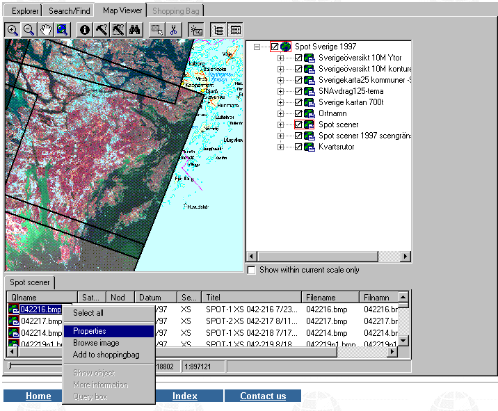

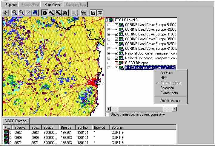

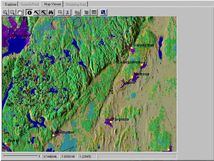

2.4.3 Map window
Below this tab there is a map display which handles maps generated by the map server. Besides the map window with its standard buttons there is a separate table of symbols and lists below the map to display the search result of searches in any of the geographic data sets
Figure 8. To simplify generation of thematic maps has several background maps benn created that are backdrops for more thematic datasets. The table of symbols and lists of search results may be removed to make room for a larger map format.
The map-generating functions on the server page have been expanded to enable the server to handle an unlimited number of maps. It is not limited to serving one (1) map to many users. The information about the contents of a map and the template the themes included are stored in the meta-database together with the geographic data. The maps are generated upon request and stored in the memory if the requests alternate between completely different map types. Suitable theme titles are also retrieved from the meta-database, as are fields in the database from which data is presented, in order that incomprehensible field names are never shown to the user.
Figure 9. The Map server tab contains a number of standard functions for moving around the map and for asking questions on the themes the map is built up of. Examples are feature-streaming of point and polygon-data to client-software, direct link between queryresult and mapwindow, databasedriven hyperlinks.

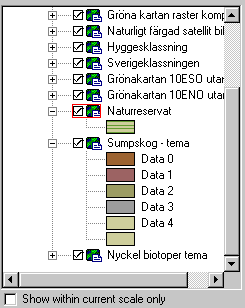

2.4.4 Legend
The table of symbols is so built up to enable turning themes on and off and activating/deactivating themes in the traditional way. Also selectable is whether a theme shall be completely hidden to the user in the table of symbols, e.g. background information. One can also automatically hide themes that are not visible due to the scale range being outside the scale range limits set for the theme. Symbol settings for a theme are stored in the meta-database and retrieved for each theme by a click on the plus sign in front of each theme name.
The theme may also be handled hierarchically in the table of symbols, so that all data sets of one object type, e.g. roads, are stored as one item in the table of symbols, thus enabling making them all to be made visible/invisible with one selection.
Figure 10. The legend for a map includes several functions to simplify handling of complex maps like grouping and hiding themes.

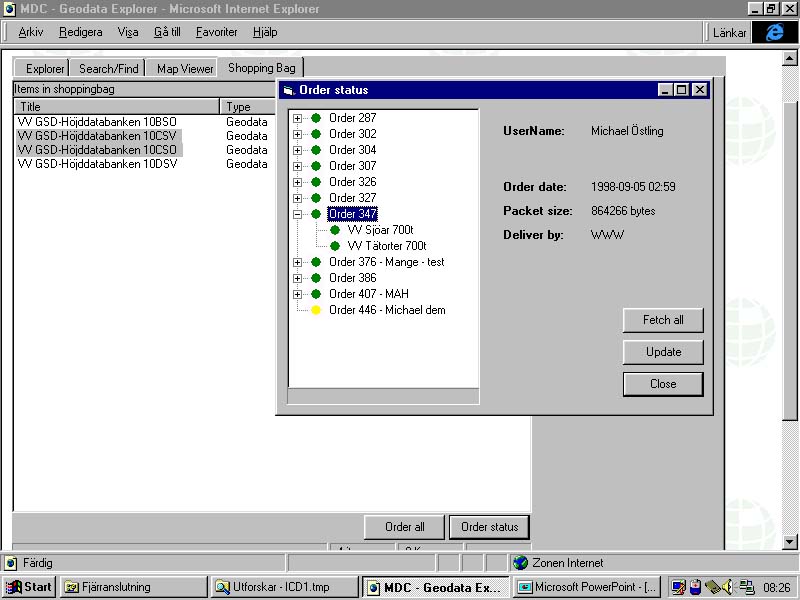

2.4.5 Shopping bag
When a number of data sets have been placed in the shopping bag and you wish to place an order, click on the shopping bag tab. Under this tab there is a simple list where you may choose to order all or part of the contents. The order can be sent directly to EnviCat or copied to a text file for later faxing or e-mailing. Those possessing an EnviCat account can send the order directly to the server in order to download the data directly. After the order has been sent the data set is packaged on the server with the necessary accompanying files for a shipment, e.g. meta data, template files and reference tables. When the order is packaged and ready for delivery the user is informed and can start to download the data.
Figure 11. In the shoppingbag can a list of datasets be ordered. Each order can be listed, inspected and tracked before download of data.
