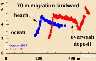

High-resolution laser surveys of the central California coast illustrate coastal change over the 1997-1998 El Niño (USGS, 1998). These studies complement 14 years of beach profiling in the Monterey area (Dingler, in prep.).

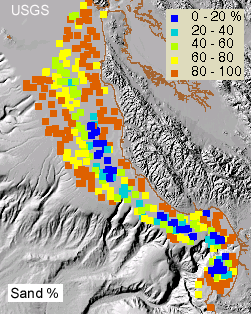

More than 400 sediment samples were collected in MBNMS between San Francisco and Monterey. The box core provides relatively undisturbed samples of seafloor sediment. Plastic cylinders are driven into the box sample to provide material for different analyses of the same sediment. A camera attached to the box corer provides images of the seafloor just before the sampler is triggered. Photographic images of the sea floor and physical samples are used to identify the lithologies that are interpreted on the map of the sea floor. Matching the locations of lithologies identified in photographs to the mosaic provides a key to the type of rocks that particular sonar backscatter intensities are recording. The sediment sample data layers in the GIS consist of locations with a related database table for each of the different analyses conducted on the samples, e.g., grain size, organic carbon content, sediment accumulation rates, foraminifer abundance, seafloor photograph (Edwards and others, 1998).
grain size on shaded
relief
Grain size parameters map coarse and fine deposition on the sea floor. The plot of sand-sized grains (0.063-2.0 mm; 0.002-0.079 in) confirms that finer-grained sediment occupies the central part of the mid-shelf mud belt. Coarser material appears both landward and seaward of the mud belt. The grain size data are included in the GIS as a related database table with grain size parameters as attributes.

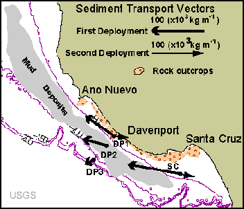

Instrument packages have been set out at several locations along the shelf and Monterey Canyon to record currents, turbidity, sediment accumulation, hydrostatic pressure, salinity, temperature, and water depth. These instruments will provide information about changes over deployment periods of six months to two years (Xu and others, in prep.). The time series data will be summarized and linked to the locations of the instrument moorings.

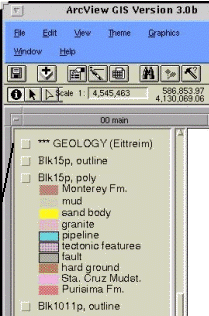

 arcview table
of contents
The Monterey sanctuary data have been developed in ArcInfo format as vector coverages, grids or image files in UTM Zone 10 coordinate system datum NAD83. The working GIS has been assembled as an ArcView project. The planned products include a cdrom with a subset of the data and a data page on the project web site. For progress on these products the reader is referred to the USGS Monterey Project web page http://walrus.wr.usgs.gov/mbms
