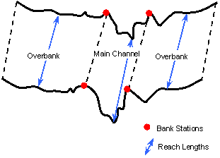

        Channel cross-section data are used in HEC-RAS to characterize the flow carrying capacity of the river and adjacent floodplain. Cross-section data includes station-elevation data, main channel bank stations, downstream reach lengths, roughness coefficients, and contraction and expansion coefficients. Figure 2 provides an example cross-section, as represented in HEC-RAS, identifying bank stations and reach lengths.
        Figure 2 Illustration of channel geometry.
        Station-elevation data represent the ground surface at designated locations in a river reach. Cross sections are taken perpendicular the direction of flow both in the main channel and in the overbank areas. Bank stations separate the portion of the cross section that is the main channel of the river from the adjacent floodplain areas termed the left and right overbank areas.
        Reach lengths are used to define the distance between cross sections and are used for energy loss calculations in HEC-RAS. Reach lengths are considered for the left overbank, main channel, and right overbank areas and indicate the path of flow between cross sections.

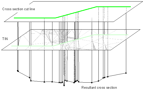

        The Cross Section Cut Line Coverage is used extract cross-section data. The river name, reach name, and stationing for each cross section are determined by intersecting the Main Channel Invert Coverage with the Cross Section Cut Line Coverage.
        Station-elevation data is extracted by intersecting the cut lines with the TIN representation of the land surface. Data points having unique values are extracted along the cut line at each break (side of a triangle) of the TIN. Therefore, station-elevation data may be sampled irregularly, depending on the resolution of the TIN. For example, a TIN created from a data set with few mass points in the floodplain, but numerous mass points in close proximity to the main channel will likely result in a TIN having a dense network near the channel and a less dense network in the floodplain. A visualization of the data extraction process is shown in Figure 7.
        Figure 7 Visualization of station-elevation data extraction from a TIN.

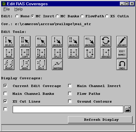

        RAS Coverage data sets are created and edited using an interactive data editor and display window. The coverage editor is shown in Figure 14.
        Figure 14 HEC-GeoRAS data editor.
        The editor allows the user to create line coverages using a mouse to perform such edits as drawing lines and moving, copying, and deleting lines and vertices, while displaying various line coverages (such as contours) in the background of the display canvas.

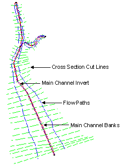

        The RAS Coverages include data sets that represent the Main Channel Invert, Main Channel Banks, Flow Paths, and Cross Section Cut Lines as shown in Figure 15. The purpose of each data set is discussed below.
        Figure 15 RAS Coverage data used for extracting geometric data.

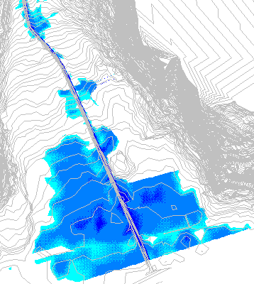

Inundation data sets are created from water surface elevation data at each cross-section location in concert with a bounding polygon. The bounding polygon limits the area inundated by water due to such features as levees, bridges and islands, represented in the hydraulic model. Processing of the inundation data sets is described below.

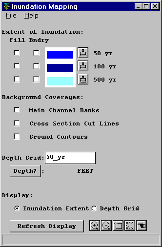

Inundation mapping options are performed using the window interface shown in Figure 16 and allow the user to identify the extent and depth of inundation of each water surface. Background coverages may be displayed along with the inundation data to determine flood prone areas. Example inundation maps are shown in Figure 17 and Figure 18.
Figure 16 HEC-GeoRAS inundation mapping window.
Figure 17 Inundation polygons for three flood events.
