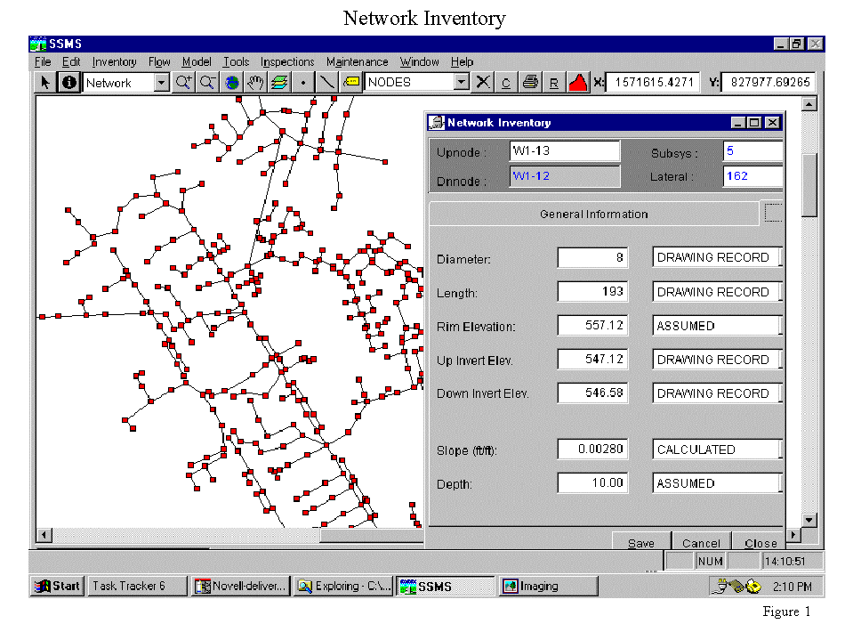

MapObject has been integrated with SSMS in order to assist in the analysis of a collection system. Figure 1 shows an inventory network displayed using MapObjects. MapObjects provides more than just a graphical display platform; it also provides a valuable tool to assist in the analysis of a collection system. Each facet of the I/I analysis is improved by having the ability to display, calculate, and analysis information on a collections systems inventory, wastewater flows, and inspection information.

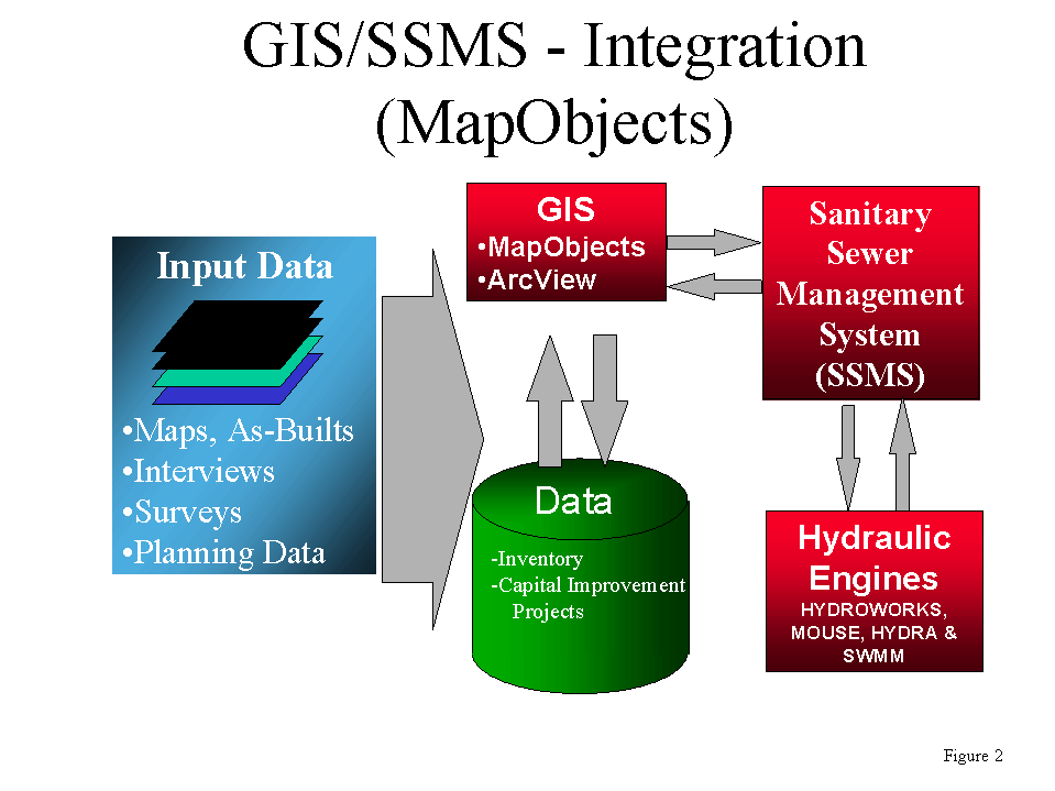

SSMS is used to integrate all the various components of the I/I Analysis process. SSMS provides specialized databases for Inventory, Modeling, Inspections, Prioritization, and other I/I Analysis support databases. In addition, SSMS provides all the automated processes that allow the engineer to easily perform each of the steps required to produce an in-depth I/I Analysis. SSMS provides its GIS features through the MapObjects software object that is available from Environmental Systems Research Institute (Esri). This software object provides a map that can be displayed in the application and numerous additional features that SSMS accesses programmatically to perform it GIS related functions. The relationship with SSMS and GIS is shown on Figure 2. At each step along the path to the I/I Analysis wherein the data is collected, processed, and analyzed, certain QC/QA procedures are necessary. The engineer uses the MapObjects based map in SSMS to view and analyze the results. The GIS features make it easy to spot problems areas in a network and also to identify errors in many cases. It also provides an easy way to integrate each of the different data elements with a GIS interface. For instance, hydraulic modeling results are immediately available through the MapObjects map. An engineer can quickly set the colors of pipes based on their utilization to see what portions of a network are overloaded, as shown on Figure 3. As another example, Inspection results can be used to set the color of pipes and manholes in the map to represent the condition of the inventory.
