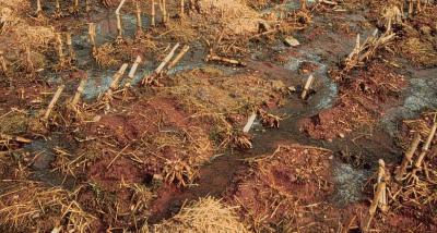

Surface runoff is responsible for detachment and transport of many nonpoint source pollutants, including sediment, most currently-used pesticides, and pathogens such as bacteria and protozoa. The prediction of specific areas in a watershed that generate surface runoff, and the amounts of runoff that are generated, can be a first step in improved watershed management.
Figure 1: Surface runoff carrying manure and agricultural chemicals from a harvested field
Surface runoff can be caused by at least two different processes, depending on soil properties, antecedent moisture, and land cover conditions. Hortonian or infiltration-excess runoff occurs when the rainfall intensity exceeds the infiltration capacity of the soil. Hortonian runoff typically occurs when vegetative cover is poor, hydraulic conductivity is low, and rains are fairly intense. Variable source area or saturation-excess runoff occurs when the soil is unable to absorb more rainfall because it is already saturated. Variable source area runoff can occur even under good vegetative cover and highly permeable soils.

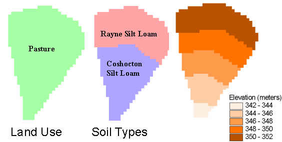

The North Appalachian Experimental Watershed in Coshocton, Ohio, is being used to validate the model under midwestern conditions. The Soil Moisture Routing Model was specifically developed for areas where subsurface lateral flow is an important component of the water balance. Soil types that best fit this model consist of a relatively thin, permeable soil layer over a much less permeable fragipan, bedrock, or other restricting layer. The model is most effective in areas of steep topography, where slopes are significant enough to be the main cause of lateral flow.
Watershed 103 of the NAEW, described in detail by Bonta (1998), has an area of 0.3 ha and an average slope of 11%. Two soil types, Rayne and Coshocton silt loams, both have a fairly permeable topsoil over clay or shallow bedrock. Land use has been pasture since 1975.
Figure 2: Land use, soil, and elevation for watershed 103 of the North Appalachian Experimental Watershed

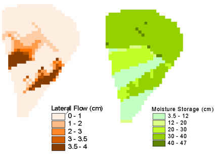

Figure 3 shows how lateral flow and moisture storage vary across the watershed on one particular day. The darker areas of the Lateral Flow plot are due to concave areas of the slope and resulting higher moisture content. Lateral flow is strongly dependent on moisture content. Moisture storage depends on volumetric moisture content plus depth of soil. The upper soil type, Rayne silt loam, is generally deeper, although areas further south tend to have higher volumetric moisture content.
Figure 3: Typical values of lateral flow and moisture storage for watershed 103

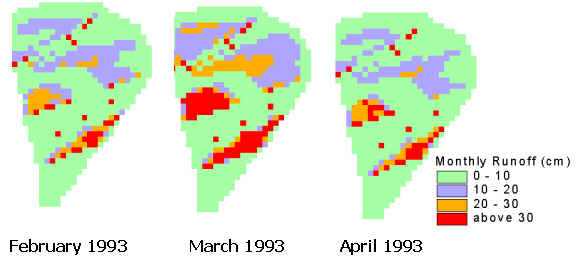

Finally, runoff is determined by calculating the moisture excess over saturation at each time step for each cell. For watershed planning, runoff can be summed over an entire month, in order to predict which areas may need special management practices. Figure 4 shows preliminary runoff predictions for this watershed.
Although areas with monthly runoff over 30 cm seem unrealistically high, the average runoff over the watersheds calculated with this model was fairly close to the total on most days (Nash-Sutcliffe efficiency = 0.59). It may be that the conventional means of describing runoff as a spatial average (e.g., "2 cm runoff", when in fact what was measured was 200 m3 over a 1 hectare area) may be unrealistic as well. More data are needed to determine the validity of the spatially varying runoff predictions.
Figure 4: Monthly runoff predicted using the Soil Moisture Routing Model
