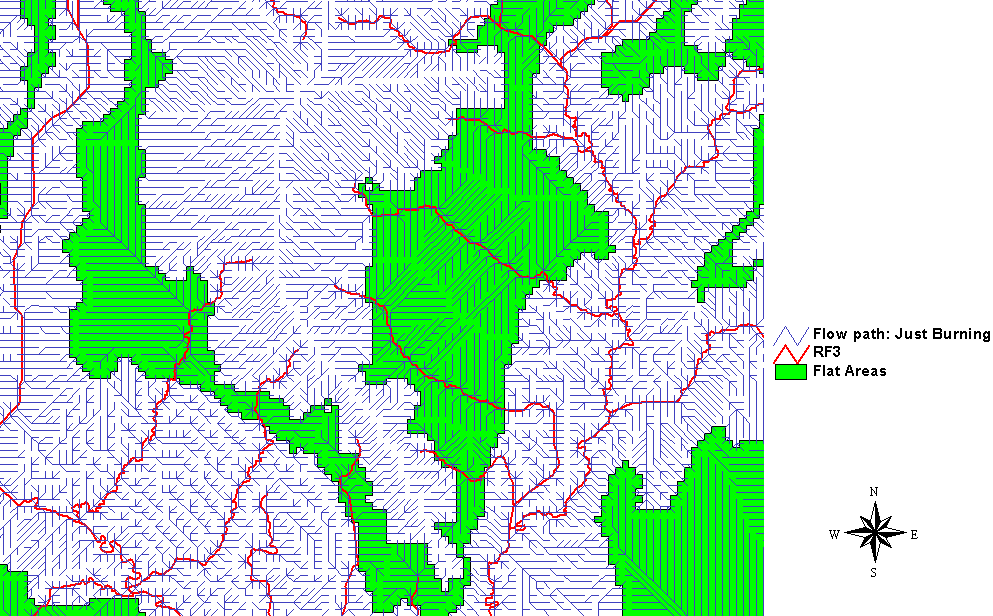

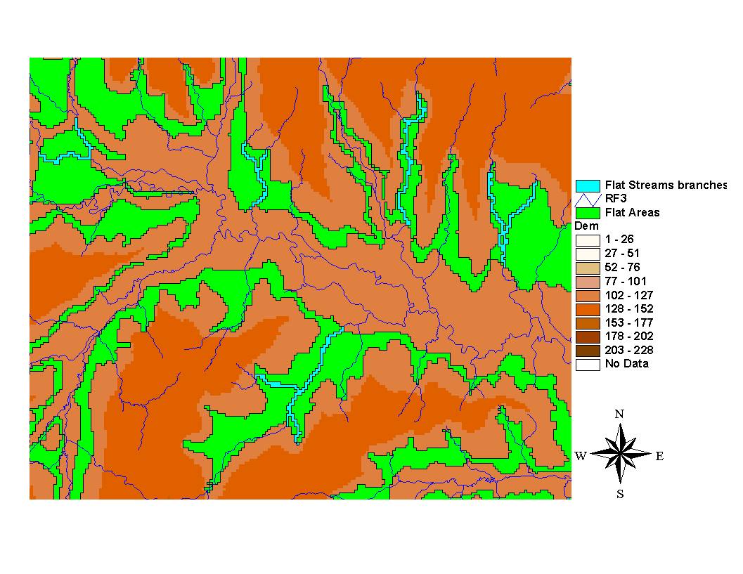

The second one is being developed and applied to detect and modify the DEM to produce realistic and topographically consistent drainage patterns. The problem (Garbrecht and Martz, 1997) arises with inadequate vertical DEM resolution and/or with discrete elevation resolution (integer values, either feet or meters) with the storage of same elevation data for large contiguous zones (flat areas) of the landscapes. A new applying approach consists in automatically locate the flat areas overlaying "critical" stream segments and replace the respective uniform elevation data with imposed gradient data.
Figure 2 shows an example of detected flat areas based on a previous detection of "critical" stream segments.
Figure 2
The zoom-in reported in figure 3 shows the flow direction lines as a result of the application of the standard procedure: the flat areas are characterized by a parallel flow direct line pattern.
Figure 3
For the same zone, figure 4 shows the more realistic pattern of the flow direction lines with the previous modification of the DEM on the flat areas.

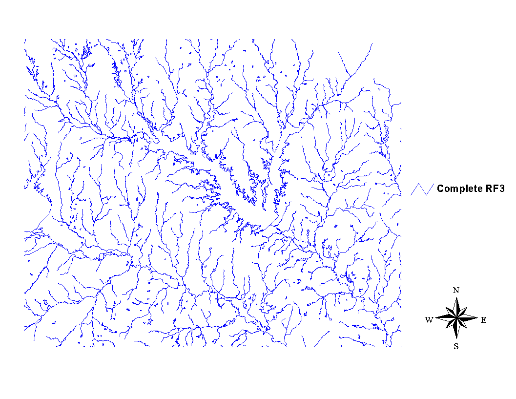

For this reason RF3 has been pre-processed in order to:
1) filter off the reaches representing no flowing water (shoreline, isolated stream reaches, ponds and wetlands):
The selection was operated with the following query to the RF3 table of attributes:
TheQuerrystring = "(([Reachtype]=""F"")or([Reachtype]=""R"") or ([Reachtype]=""S"")or([Reachtype]=""T"")or([Reachtype]=""X"") or ([Reachtype]=""Z""))"
Due to the occasional not consistency of the RF3 attributes, some of the deleted stream lines were re-integrated.
2) introduce the centerlines for lakes and wide rivers;
3) check and remove the eventually introduced breaks of the stream network continuity.
Figure 6 shows the RF3 data after the application of the filter and the checked integration of the centerlines data sets.
Figure 6

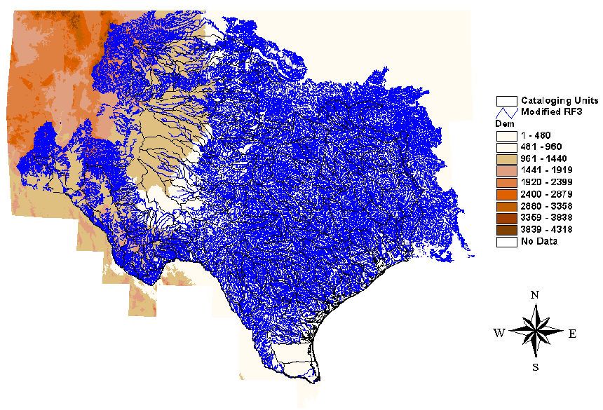

After these steps the network composed by the integration of RF3 and the centerlines were assumed to fully represent the Texas stream network characteristics.
Figure 7 shows the entire DEM data set and the modified RF3 clipped on top.
Figure 7

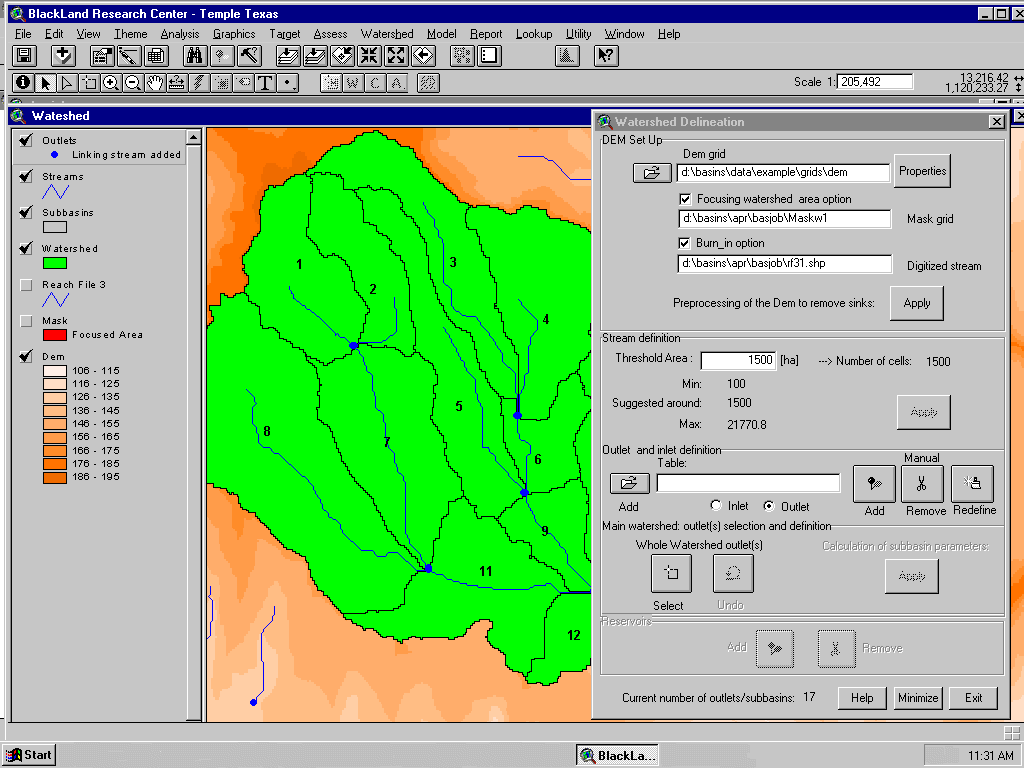

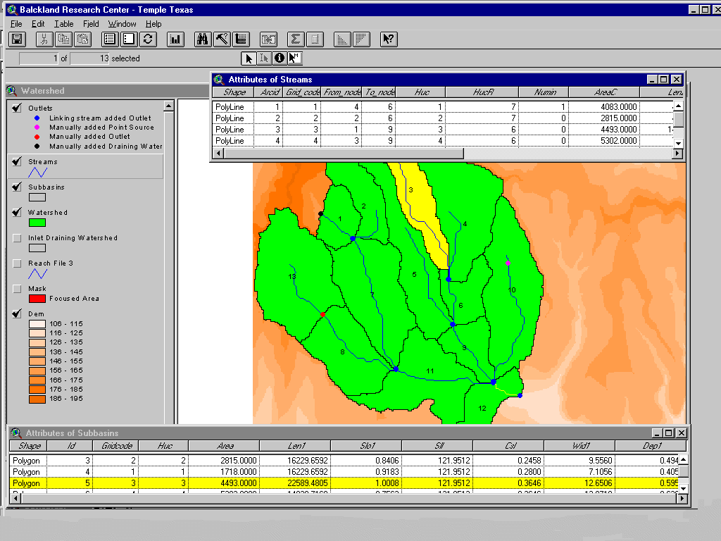

A further tool has been developed using another ArcView extension (Dialog Designer extension ver 3.1). The tool, upon the loading of the flow direction and flow accumulation grids in a View, provides an easy way to define the river network based on a user input flow accumulation threshold area, select target outlet points of the river network, delineate the resulting watershed boundaries and calculate the respective area. The tool is a reduced version of the watershed delineator developed at Blackland Research Center to integrate the SWAT model (Di Luzio et al., 1998). This is being further developed for the US.EPA as a component of an integrated tool framework to provide watershed assessments analysis of point and nonpoint sources (Battin, 1998).
Figures 8 and 9 show two snapshots of the watershed delineator being developed for US EPA.
Figure 8 and 9
