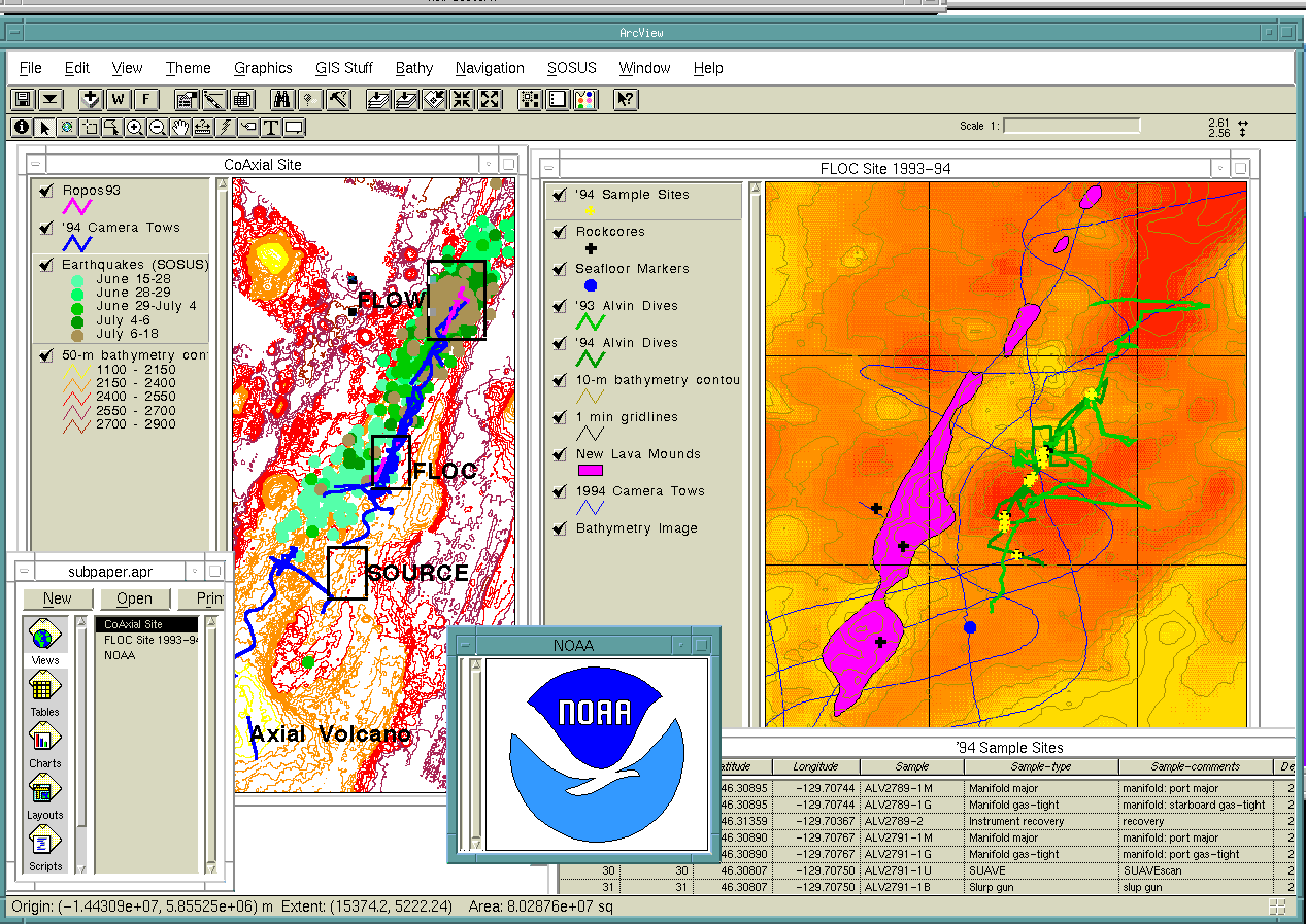

Powerful indeed, as scientists were able to evaluate ALVIN dive plans with all available information available graphically at the touch of a button using ArcView 2. Bathymetric contours, prior dive tracks, marker and hydrothermal vent locations, previous sample sites, categorized photographs from a deep-towed camera system, areas of new lava flows and the SOSUS earthquake locations, all were themes available to the scientists. (Figure 4) This allowed decisions to be made as to which areas needed to be re-visited and which new areas needed to be explored thus most efficiently using the limited dives and bottom time of the submersible.

ArcView 2 at sea was not only used to evaluate previously collected data, new ALVIN tracklines, deployed markers and sample sites were easily incorporated using Avenue scripts and ArcView functions. Tables from spreadsheets could be added effortlessly to the ArcView project Tables. Then the locations from this table could be displayed on the View using the "Add Event Theme" function from the View menu bar. The dive tracks were displayed as lines using the "GPSToShape" script included in the Avenue Example Script Library. All of this was possible only hours after the submarine landed on deck. The newly collected information was presented in the nightly dive de-briefing meetings as colorful maps created within ArcView's Layouts. Figure 5. The diving scientists were then more clearly able to evaluate and relate their experiences to the other scientists.
GIS at sea with ALVIN was such a success that demand exceeded supply as far as computers and ArcView software at sea were concerned. For the cruises ArcView 2.1 was available on an EPS 486PC/66 with 16MB of RAM and a PowerMac 7100/66 with 33MB of RAM; each had 17" monitors . Both computers were networked to the ship's SUN Sparcstation. The ArcInfo VENTS database was loaded directly on both machines for faster operation. Originally the plan was to have one machine dedicated to data input/processing for the GIS specialist and the other machine available for use by the scientists. ArcView 2.1 was so popular with scientists eager to analyze their data that the GIS specialists frequently found themselves without a machine to use! Fortunately data input was so easy with ArcView and Avenue the that specialists didn't require a full-time machine. Even so, future operations will be facilitated with additional computers and ArcView 2.1 licenses.

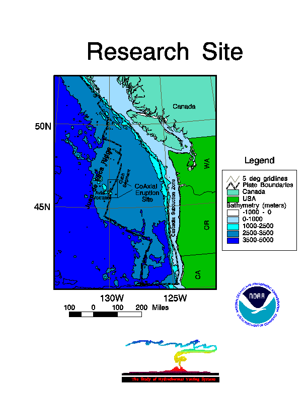

Figure 2. ArcView layout illustrating the location of the CoAxial research site. The site lies along the Cobb Segment of the Juan de Fuca Spreading system approximately 200 miles off the west coast of Oregon and Washington.

Figure 4. Screen capture of an ArcView session used by ALVIN passengers prior a dive. Divers could retrieve information regarding previous visits to the dive site in preparation of their dive plans.

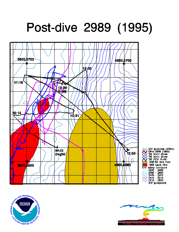

Figure 5. Post-dive map typically presented at the evening scientific briefings at sea. Divers could easily relate sample sites and locations of interesting observations to other researchers.
